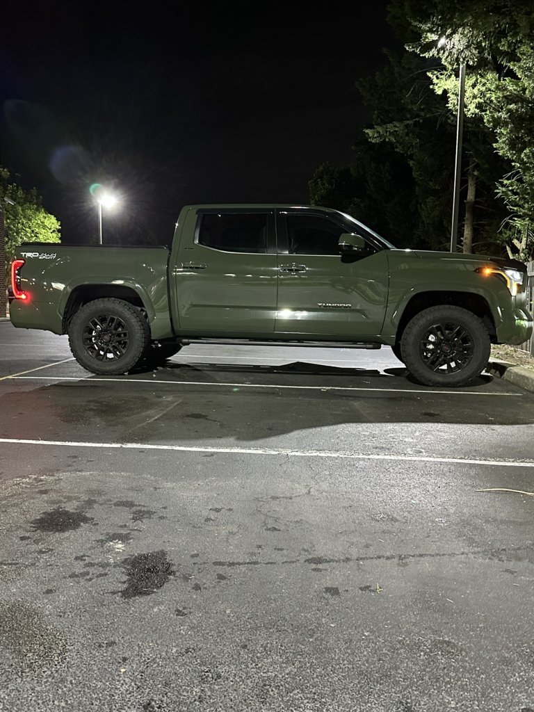

    She looks like this at the moment...

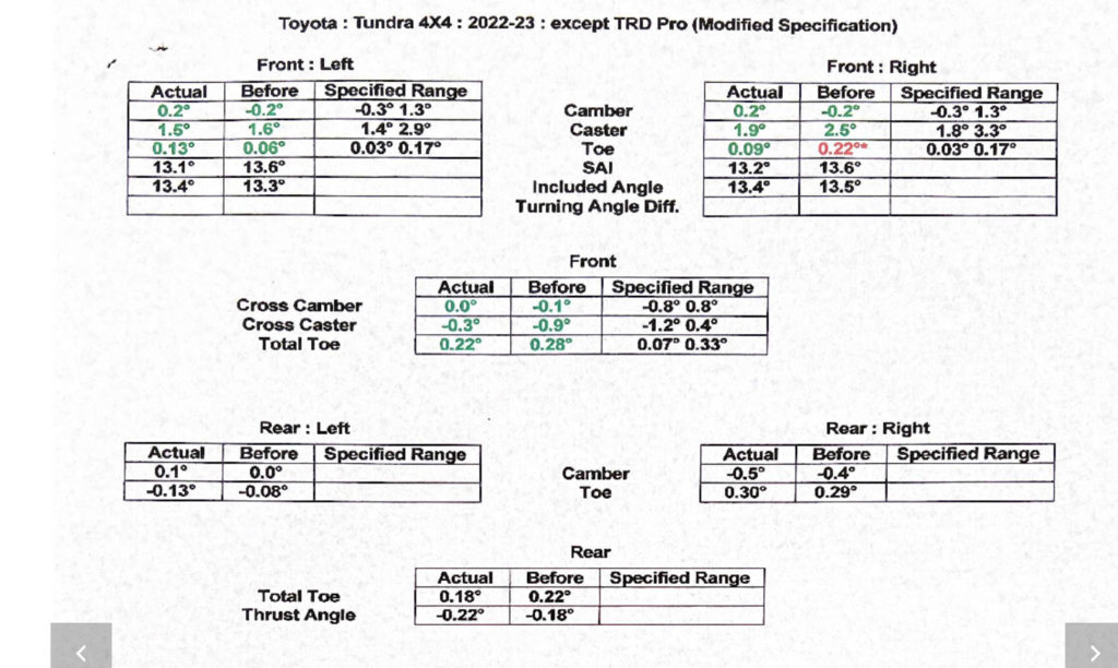

    Rough Country Hidden Winch Mount, Westcott Designs 2022-’24 TOYOTA TUNDRA TRD PRELOAD COLLAR 3/1” LIFT KIT, KMC Dirty Harry Wheels 17x8,5 +18os, Toyo Open Country AT III 315/70R17 tires.
    Westcott Designs has a solution for you. There are haters out there, but I’m really happy with mine from WD. Somebody on here said “you don’t need to worry about your warranty until something breaks.”

    Question for you, since I am going to have a WD kit installed here pretty soon:
    (1) what does your alignment look like?
    I have the same numbers on my alignment as WD have posted in photos of their products. Is that what you mean by look like? No, I didn’t buy the fender liner kit, however my wheels are offset +18 and only run 35’s and i have zero rub.IMG_0136.jpg

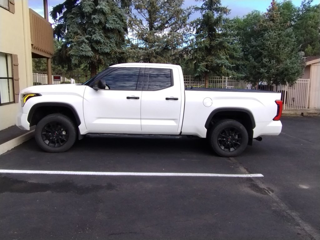

    I did the rough country 1.75 level kit front and rear. At the same time I removed the spoiler, left the spoiler motor. The only reason I did it was for oil changes so I wouldn't have to jack the truck up, cosmetics were an added benefit. Running 275-60-20 Pathfinder at tires.

    Forgot to attach pic.

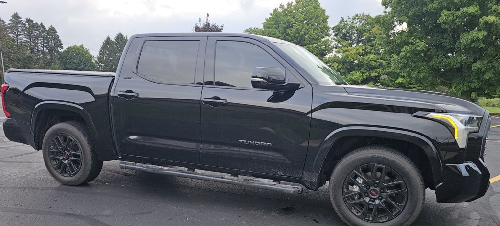

    This looks like what I think I would like can you direct me to the kit you bought? I love my rims so want to keep them but would like to upgrade the tires to only 33s... not sure how that calculates to tire numbers

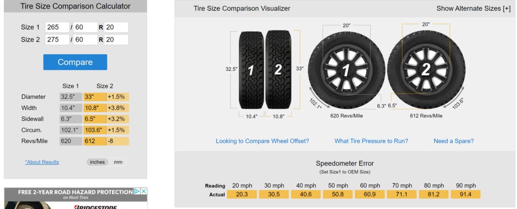

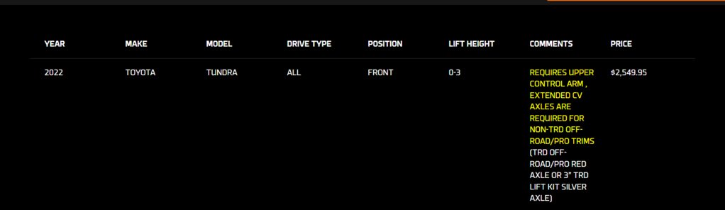

    Stock size is a 32.5" tire..."Going up to 33s" will change the height of the truck by a whole 1/4 inch.
    As others have said no Lift is going to void your warranty unless what ever part fails is related to suspension. If its suspension then that will not be under warranty because it will likely be easily proven your lift caused the failure. Rip a CV boot that probably won't be covered either. Rip a brake line because you didn't replace the lines for the added lift...yep you guessed it that won't be covered either.
    Save your lunch money if you're thinking rough country and buy something proper Eibach E80-82-096-01-22 is pretty good value and will always out perform rough country. Dobinsons IMS shocks and their springs are the best bang for your buck based on what people are reporting.
    Keep in mind anything over 2" in the front and you are looking at needing red TRD axles (which looks like you should already have with a TRD). Also keep in mind for over 2" lift it is recommend you need upper control arms as well to make alignment feasible. Something to keep in mind is proper UCA's are around $600-$1200.
    If you go cheap and do the Rough country lift don't come back here asking why the ride sucks. You get what you pay for when it comes to suspension.

    You can use this site to compare tire sizes.
    Quote your source on recommending a UCA if you lift above 2” and got my alignment done no problem without an UCA

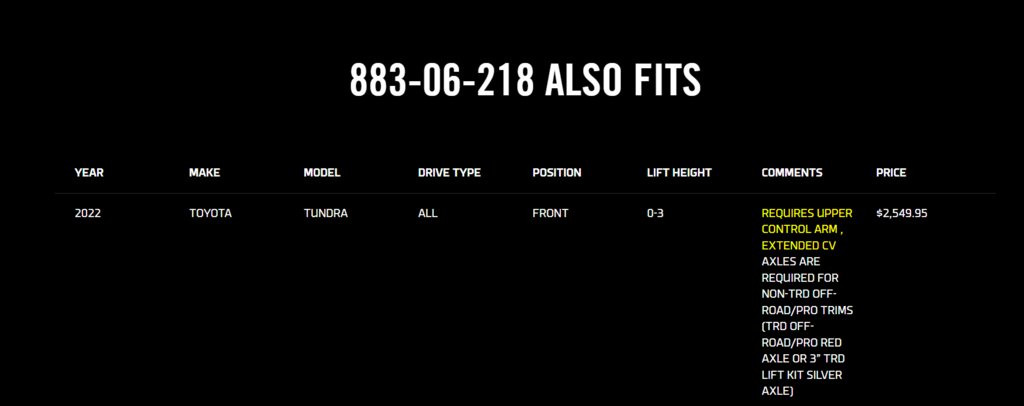

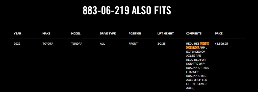

  19. Aug 26, 2024 at 3:09 PM
    teab
    teab 2023 Platinum w/ PRO bits
    Mar 22, 2023
    #94291
    667
    Ty
    Denver
    2023 Platinum MGM 6.5
    TRD Pro Wheels, Go Rhino D6, Airlift bags/compressor, Talons Alum Cat Shield, Cheap-o Amazon Mud Flaps, Fastop Tonneau/Topper, Rear TRD Pro Shocks
    As you noticed there I said recommend and didn't use the word required.
    Also from fox racings website for two different kits.
    Also that is what Dobinson's told me when I enquired via email.
    Can you get it alighted without it? Sure. Is there more adjustment with a new UCA to make the alignment easier and provide overall better geometry in the suspension and your ball joints then that answer is also yes. Will your ball joints on your stock UCA's wear out faster and cause your alignment to go to shit that's a yes. Seeing how ya have a 2024, I'm guessing you don't' have too many miles on your set up yet, so give it some miles on your truck and see how your tires are wearing and if your stock ball joints are still in tact and report back.
    ...come to the internet asking strangers for advice and well you get advice, never stated I have a "source".
