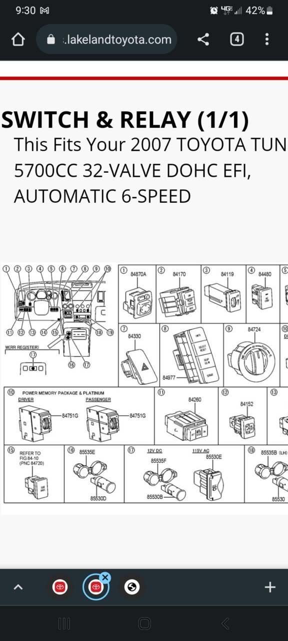

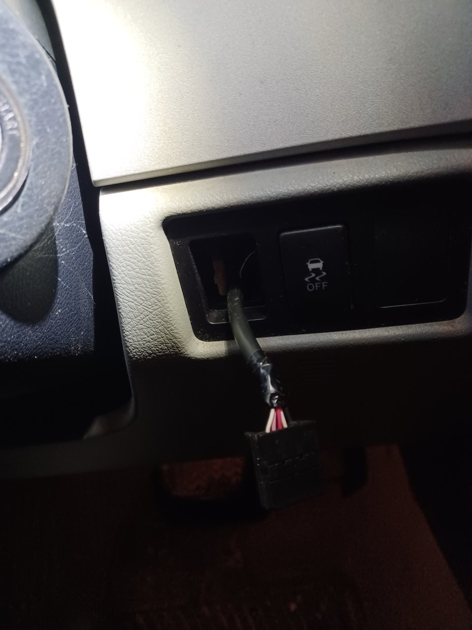

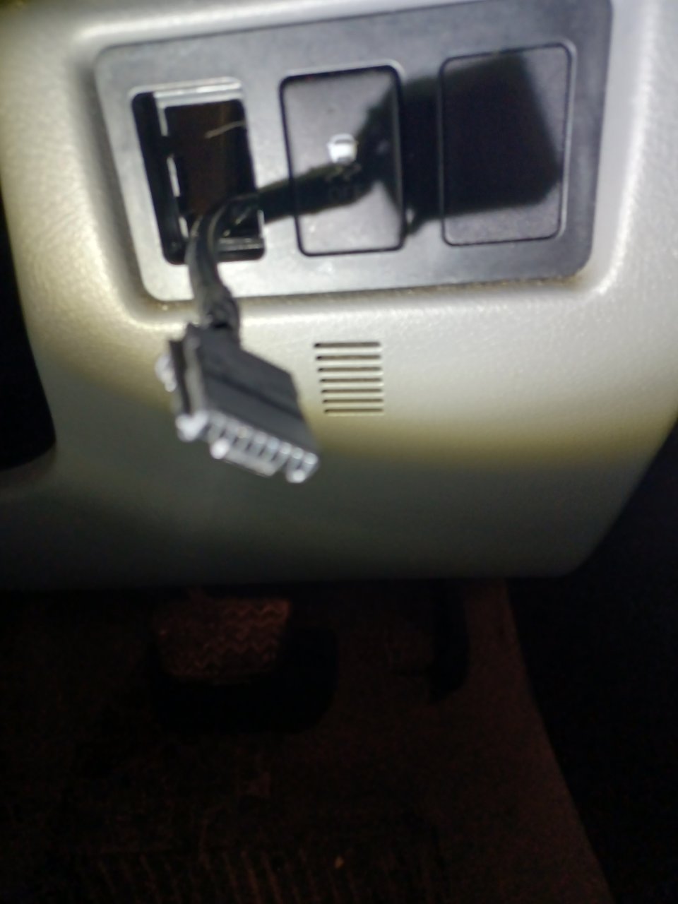

    upload_2023-1-18_22-7-48.jpgupload_2023-1-18_22-8-29.jpgwhat is this, on an 07 crewmax, just hanging out behind a blank?

    Looks like the switch for a power inverter.

    On my 2015, that is where the parking assist sonar switch is located.

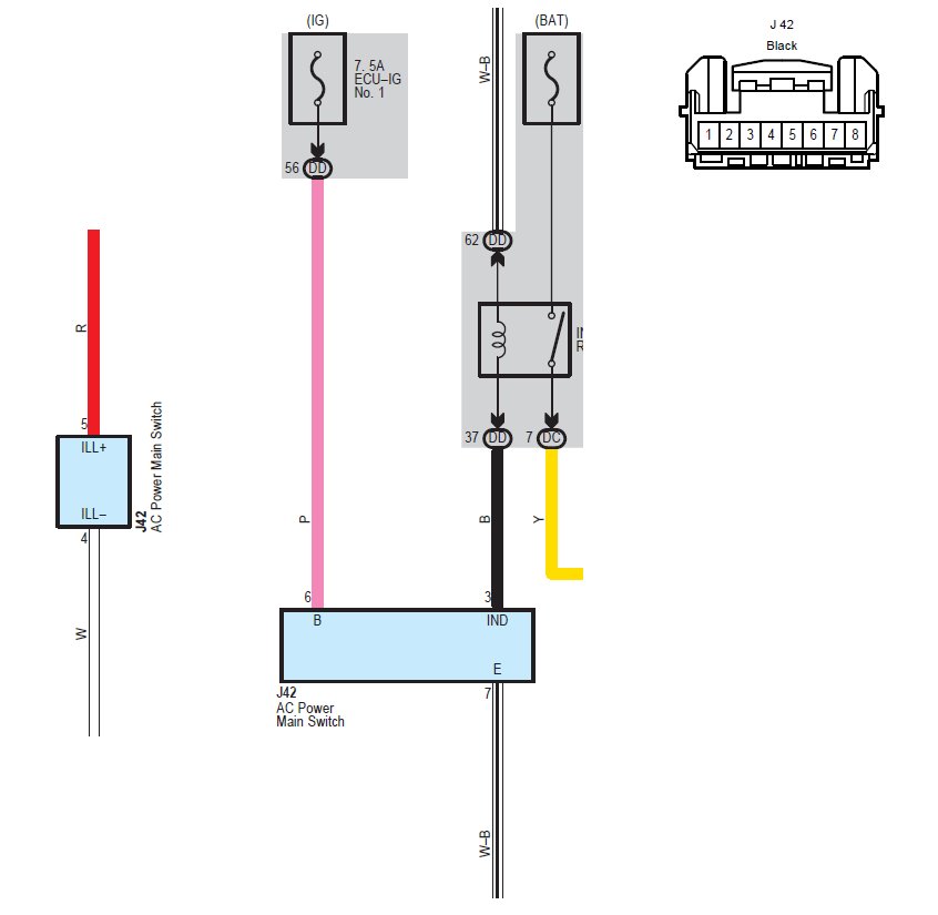

    J42 AC Power Switch, it controls the 115V Outlet
