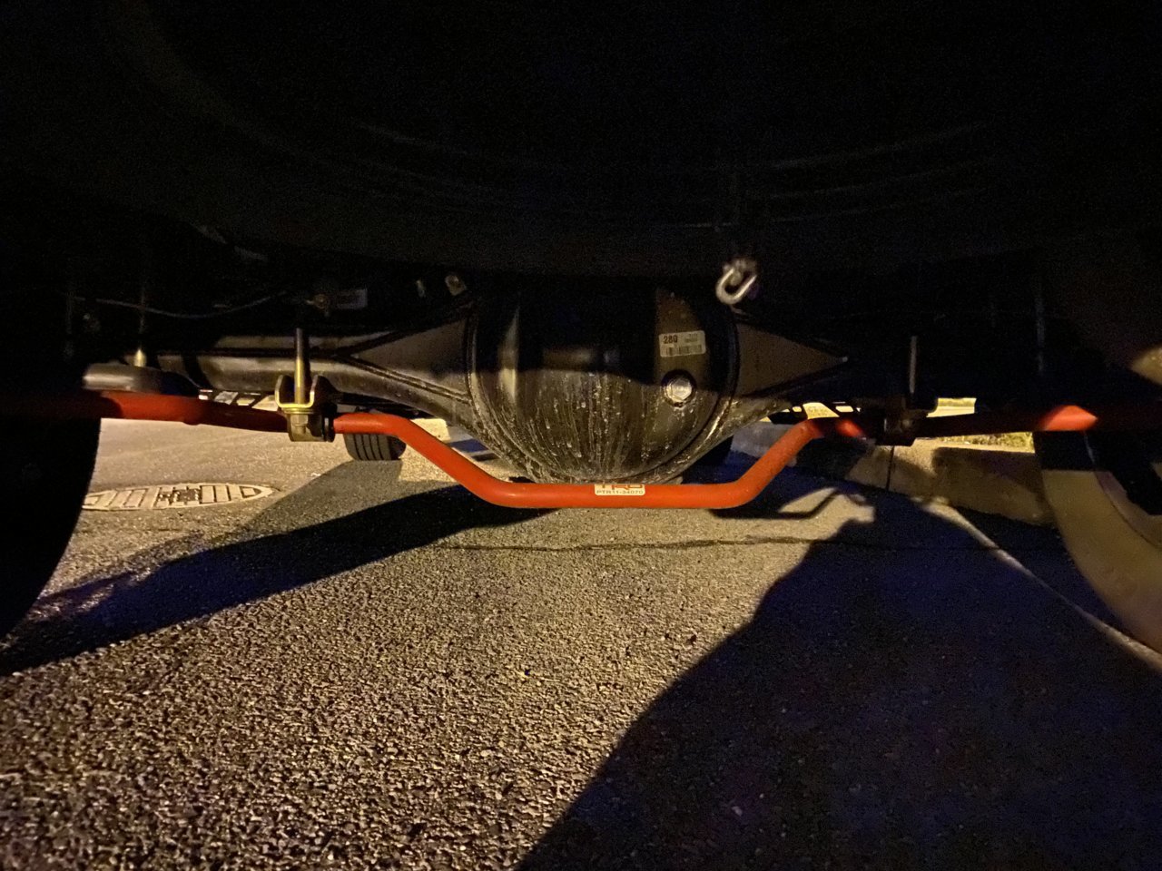

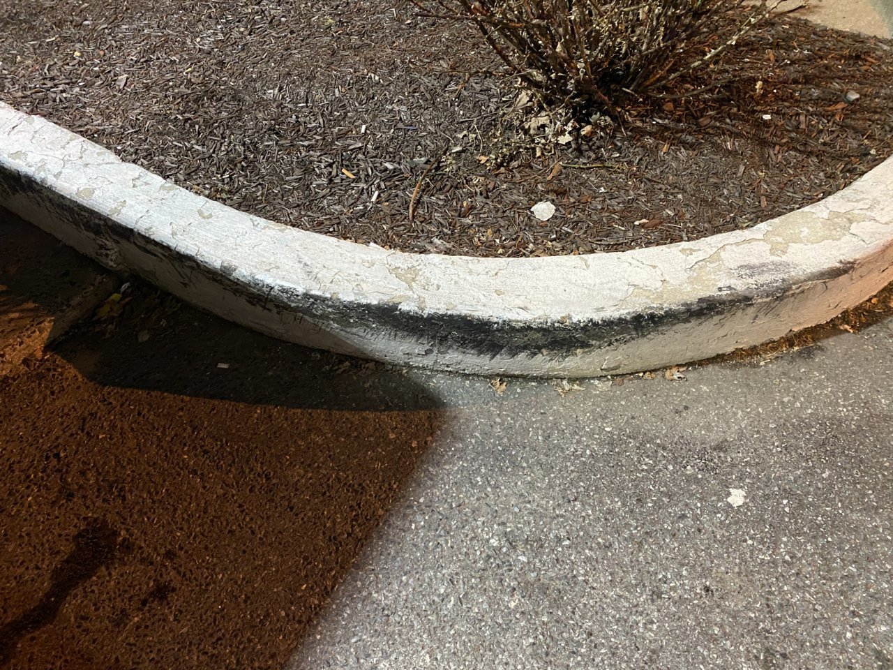

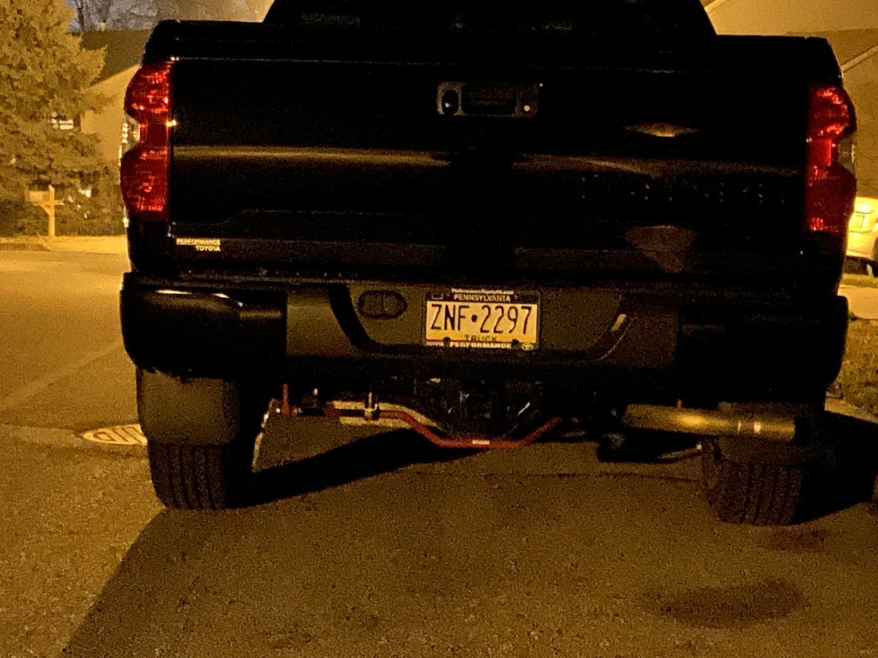

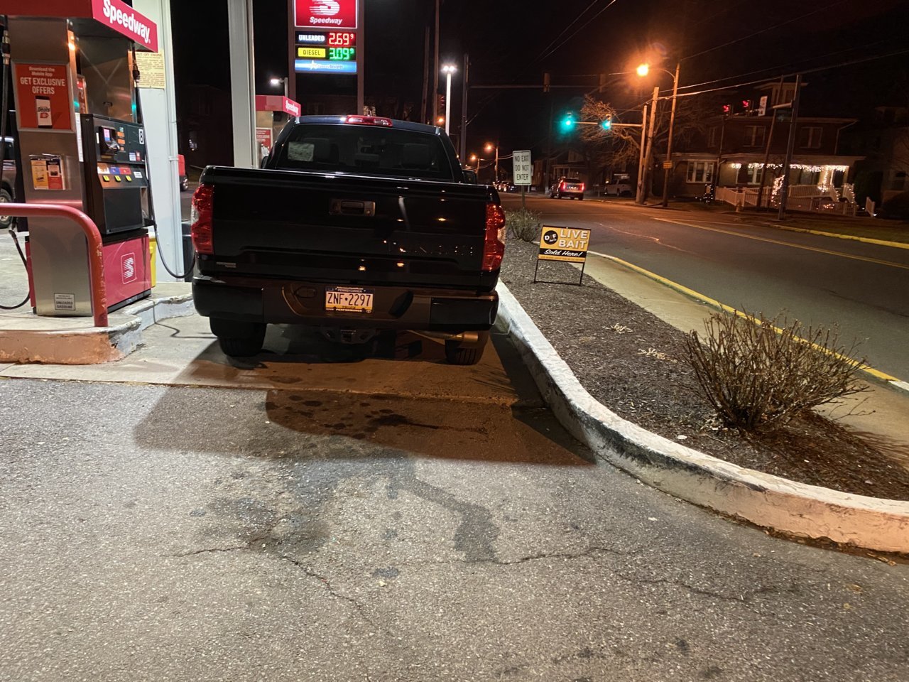

    Hi all, I misjudged pulling in a narrow pathway at speedway . Thumped rear tire against curb at 5 mph. Hit it hard enough to swing rear out away from curb. I think it’s ok. Tundra doesn’t pull and steering wheel is 11-12 o’clock when going straight. Steering wheel is just slightly off center but could of been like that from factory . Only 1900 miles on it. Bought Black Friday.

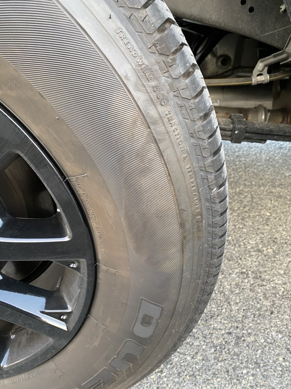

    Here’s rear pics. Side bumped.

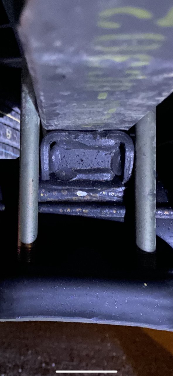

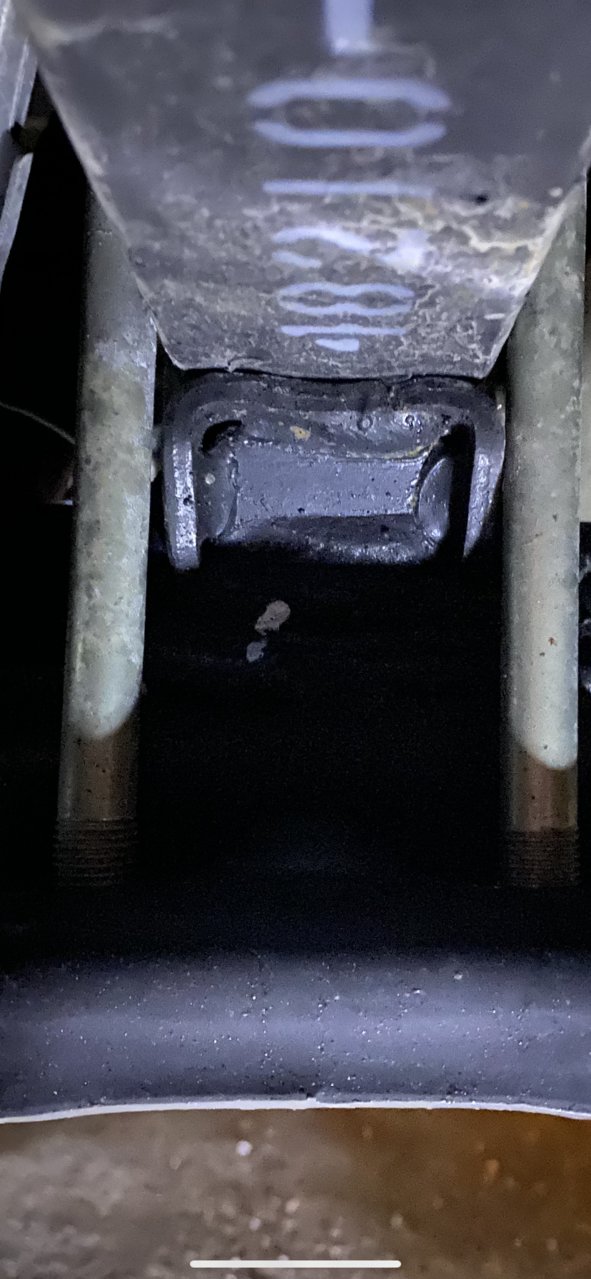

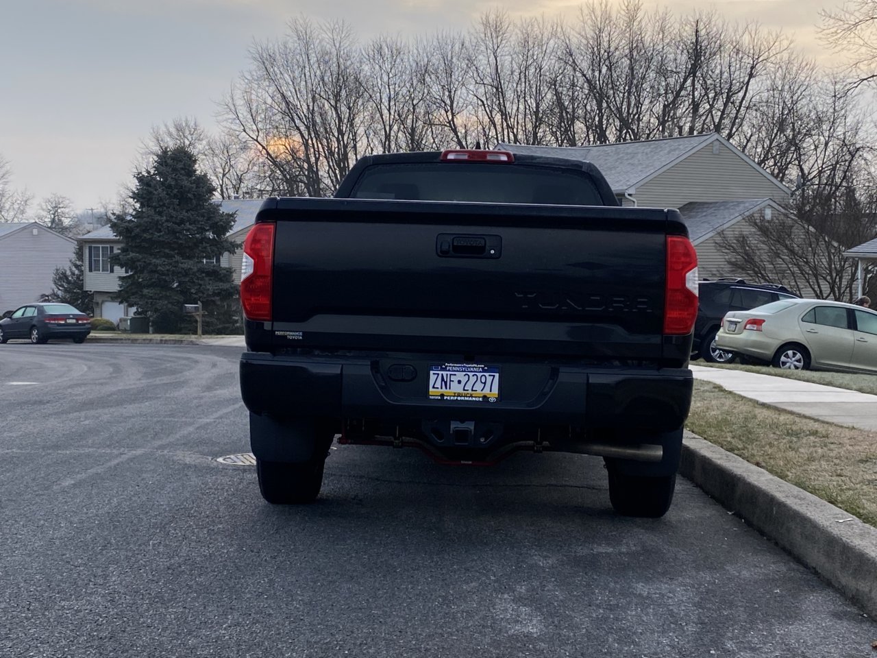

    Other side

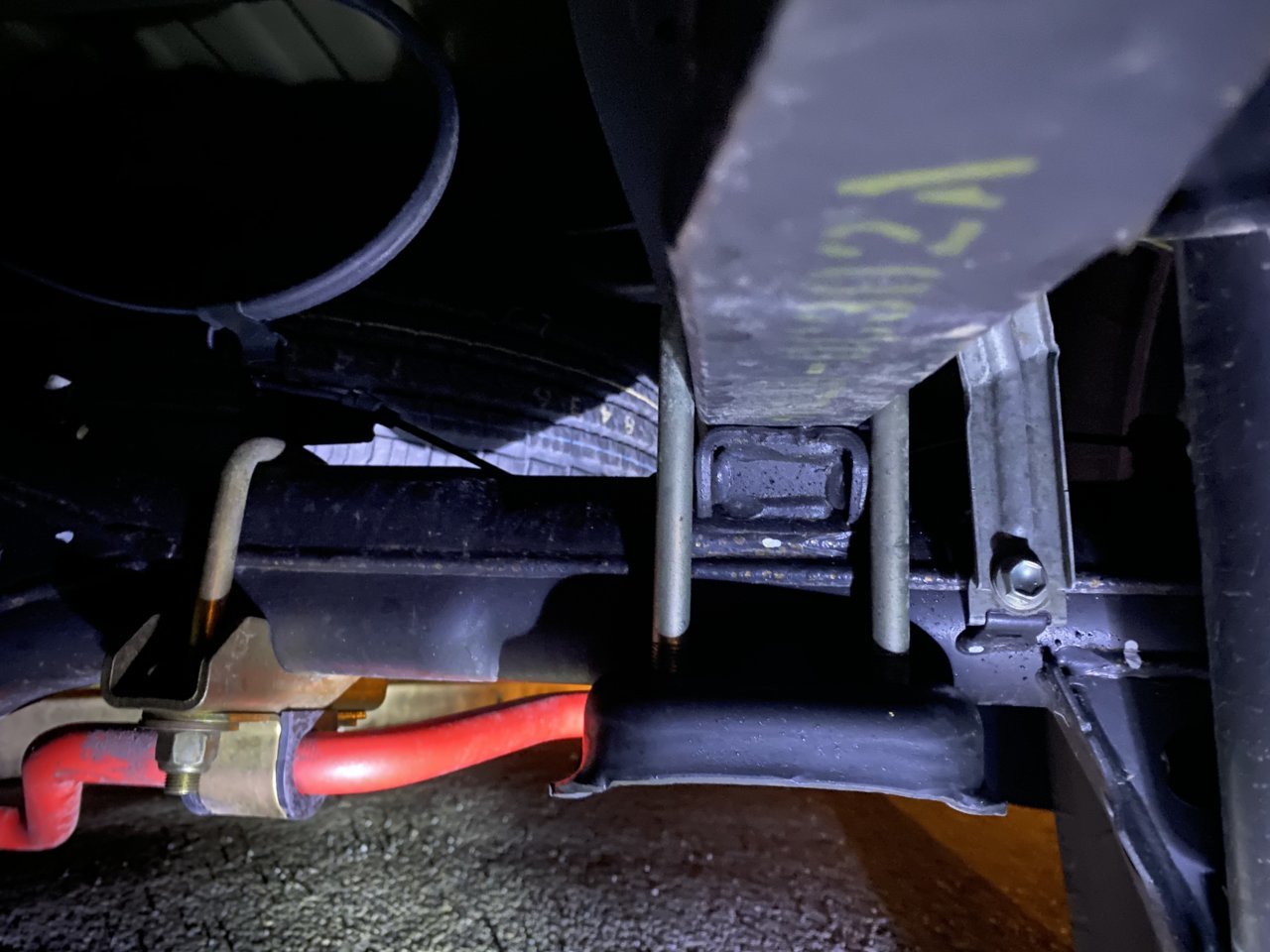

    Sway bar

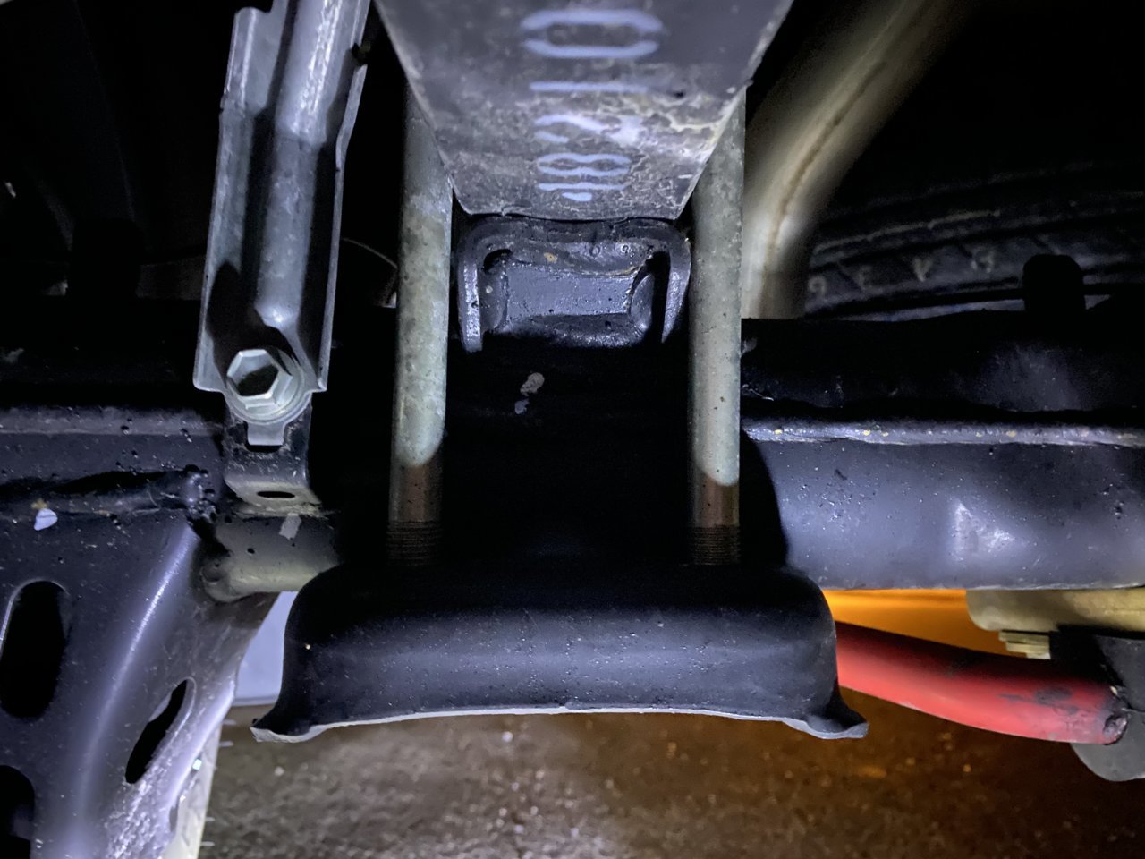

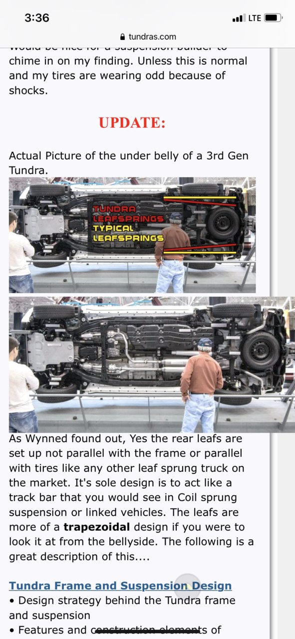

    Something I learned researching how rear is attached . Apparently tundra leaf springs aren’t straight .

    Agree with the above statements.... you didn't hit the rim, only the tire so I wouldn't be concerned about it. Rubber flexes!

    Tundras have solid rear axle, nothing to align in rear, and nothing to bump out of alignment...except the entire axle. If that happened, I'm sure you'd know. Steering wheel being off center, as others have said, is a front alignment fix...one tie rod end needs to be screwed in a tad, the other side unscrewed a tad.
