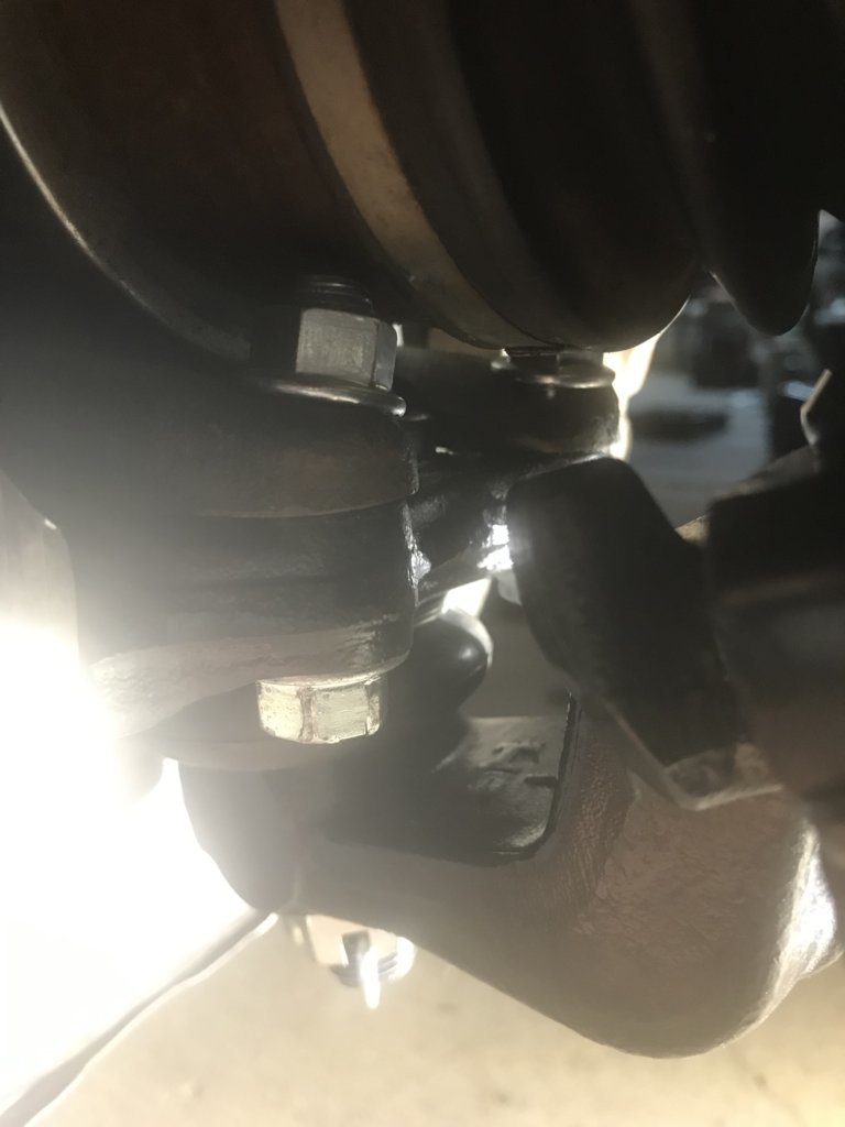

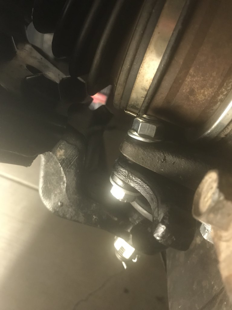

    Oh great it's Dustbox again asking stupid questions.
    Replaced my upper and lower BJ's (OEM don't worry) today, everything went smoothly til I was putting in the 4 bolts that hold the LBJ to the spindle. Realized that the inside two are stripped because some smoothbrained previous owner or shop ran bolts visibly too large and completely stripped out the threads on the knuckle/ spindle whatever you wanna call it. Those bolts don't even fit through my new LBJ so I couldn't just jam those in there.
    Soo I went to Ace and bought the same size bolts as stock but slightly longer, and then threaded a nut on top. I will add pictures.
    Thoughts? Is that secure, and for how long? It seems solid but the nut rattling loose is a concern even with a lot of loctite. How could I ensure against that?
    Obviously I don't wanna run that forever. New spindle? or is an insert and then re threading it with tap and die an option?
    I need your guys amazing opinions as I am planning on driving a few hundred miles in the next few days.
    Note: they do easily clear the CV, clearances aren't a problem.

    I mean, maybe?
    Here's how I'm thinking about this- the nut is doing the same thing that the threads in the spindle normally are. However I am not familiar with how much thread engagement there is on the spindle vs. the nut. Plus there is the chance of the nut backing off of the bolt. If you can get a grade 8 bolt and nut, loctite, then my initial thought is that it would be fine. I can think of numerous cars off the top of my head that have a ball joint that attaches with nuts and bolts. If you know the bolt size/pitch we could find the strength of that bolt.
    That said- we know what happens when LBJs fail. People have gotten into serious accidents due to LBJ failure. You mentioned you were planning on doing a few hundred miles soon. It wouldn’t be smart to drive that far with bolts like that. Do I think it would be fine around town until you get a new spindle? Yeah, probably. But hundreds of miles, no.
    When I’m deciding something like this on my own cars, I ask myself: “would a professional mechanic get sued if he did this to a customers car?” And if the answer is yes, then I don’t do it.

    IIRC the lower surfaces of the spindle are not parallel and the nut is sitting at an angle. I would replace the spindles. Clearly, the shop that did the work has no clue about FGTs.

    I personally wouldn't drive that. Options aren't great here. Replacing knuckle sucks b/c you just presed in new UBJ. Drilling out the 4 holes in the LBJ to take a fatter shanked bolt would suck. That's a high-stress area so I'd want to avoid drilling, tapping, or thread repair.
    Replacing the knuckle is safest but sanity check here: Are you 100% positive you're reading the situation right? Is it possible you ordered the wrong bolts?

    I got the part numbers from you guys, and I’m running them on the other side they thread perfectly. Part number is 9008010066
    Thoughts on welding it all together? Sounds redneck af but then I ain’t gonna lose no bolts.

    I really don’t like the fact that bolt looks like it bent as you tightened it

    I wouldn't drive on that.
    I would be hitting up www.car-part.com and finding a donor 2000 year 4WD spindle ("knuckle", if you prefer) to swap in. I know you probably don't want to do the work, but this is the best, safest fix.
    I think it's possible and/or probable that someone replaced the knuckle already with a later model truck, which used a larger-thread bolt. I can't recall what the breakdown was, I think 2000 all same, 2001-02 all same, 03-04 all same, 05-06 all same.
    You must understand, if any of those four fasteners don't hold, the others will follow in short order - and one will not hold, it's already tweaking - the end result is going to cost you a fuckload of money and take the truck out of commission. The damage will be bad enough you'll probably be overhauling brake lines, ABS sensor if applicable (which is $$$), tie rods, potentially the steering rack and lots of other shit.
    LBJ is not to be trifled with. This is not the part you want to FAFO (fuck around, find out) with. The only temporary fix I'd accept would be opening the LBJ bolt holes up a hair, then tapping, then using a new grade 8 bolt, but even then I'd do it temporarily.

    I missed your comment about the nut rattling loose even with loctite applied.
    As other have stated, I wouldn’t be driving it that much myself if at all. Restrict it to the back roads at lower speeds.
    Sounds like the threads got mangled along with the bolt bending after torquing it down. Maybe a compression washer would help to minimize that but it’s only a guess.

    I'd grind flat spots so the bolts dont bend. Replace the bolts, use nylock nuts and send it. It's plenty strong that way IMO.
