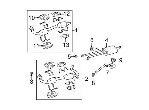

    Thanks for the suggestions and sharing experiences. Even if I do decide to go with OEM, it appears that I will have to wait for months according to the dealer because the parts are backordered. I’ve been on different Toyota parts websites, some say backordered while others have that’s in stock. One website I checked was Toyota parts deal. Shows the price of the two exhaust pipes that includes the converters, the gaskets, converter protector, and I also plan to replace the muffler and tailpipe. Basically everything in the diagram below. I’m not just considering OEM, I also looked at Magnaflow and Walker cats (better pricing for sure), still weighing in my options and how I want my exhaust to sound. Everything is bone stock and I never really been into loud exhausts although some do sound good.
