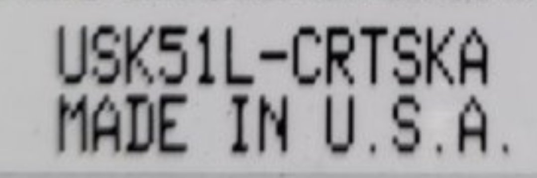

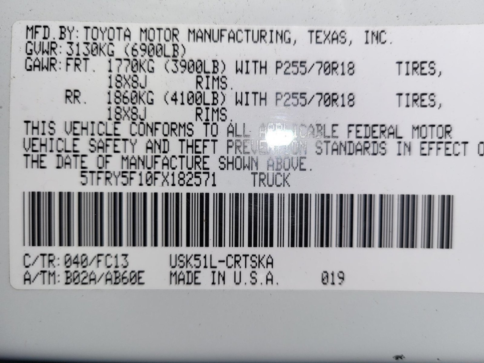

    here you go

    Look up this number in your owners manual to find your models true towing capacity. Look for another sticker that says curb weight and you may find a smaller yellow sticker that subtracts your port installed options from your payload. Remember, curb weight is full fuel and other fluids. No driver, no floormats, no phones etc.Screenshot_20240712-211723.png

    Other sticker
  26. Jul 12, 2024 at 6:48 PM
    #26
    GODZILLA Ask me about my hot doc
    32,714
    Other sticker.
    Should look like the lower one with a tire picture here.

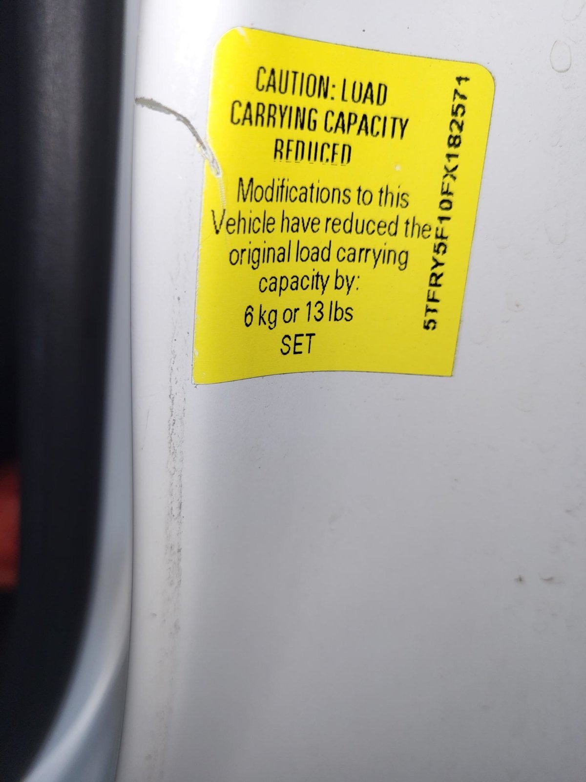

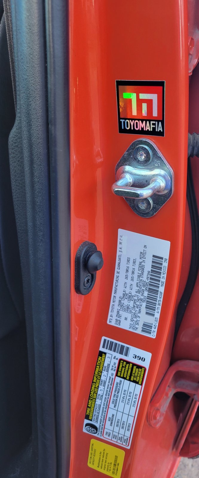

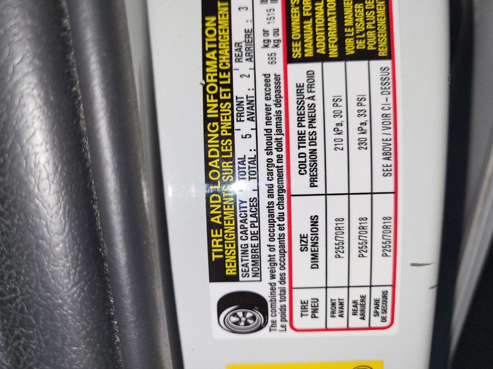

    these are the only other stickers i see
    AZBoatHauler likes this.

    This one. It shows you have 1502 of payload available. (1515-13). You’d have to subtract the pin weight and hitch weight (1100+100) leaving you 302 lbs for you your passengers and everything in the truck. Assuming you put truck tires on and beefier springs or airbags to handle the weight and not ride the bump stops, that additional weight comes out of the 302.
    The scarier problem, you’re towing a 35’ x 10’ x 8’ building that’s gonna toss your 5,400 lb truck like a rag doll when it hits a gust of wind.
