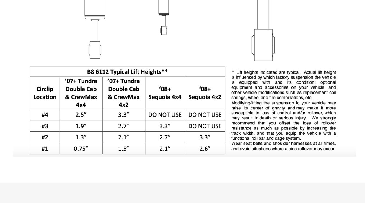

    The bottom setting for 6112s will yield .75” of lift. It’s quite mild in terms of lift, but it is there!

    my 6112's at the 3rd setting (nearly 3" of lift) are a better ride than stock IMO

    Nope. You need to remove the strut assembly, compress the spring, remove the top hat assembly, move the circlip to the whatever new setting you want, then reassemble and reinstall.

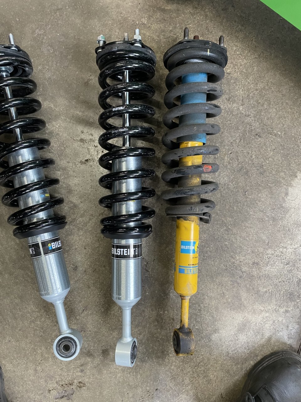

    I installed the 6112 shock assemblies on the lowest setting and picked up about 1” of lift up front, I still have about 1.5” of rake. I put 5100 shocks in the rear. The ride is much better compared to stock, less sway when turning. Here is a pic for reference comparing the two side by side.
