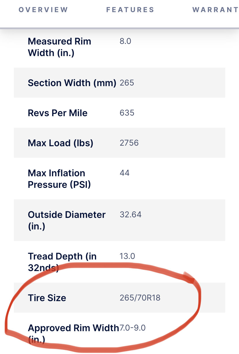

    I just bought some Method 706 wheels. They are an 18x9 wheel. I can't seem to find information about running a smaller tire than stock size. I was looking at getting 265/70/18. I know that 275/65/18 is standard size. Will these fit or do I need the wider standard tire? I looked at so many different sites and I still feel confused because I only see people running the biggest tires they can find.

    So they will fit properly? That's my question. I found a really good deal on the smaller width tire.

    Look at the tire manufacturers specs on their website or at a retailer. They list an approved rim width as below…
