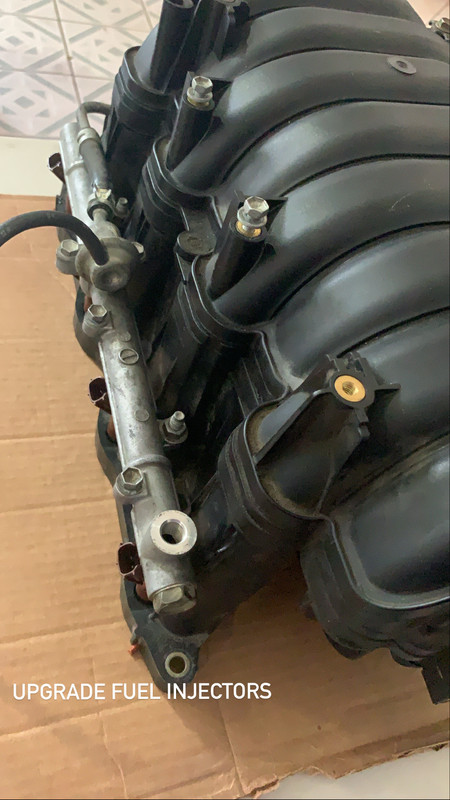

    eBay has complete rail/injectors for Tundra for sale, the picture attached lets me believe it is possible to remove both sides together. I would feel like a real Ninja if I could do that!
    @professional-hand-model I read your build thread, wow!! A real treasure trove of Tundra repairs and upgrades. Kind of dangerous for me to read, sometimes I do get carried away. I copied your pictures with instructions/notations.
    I will also linked the manifold removal videos I found. It remains curious to me there are no videos of anyone removing the fuel injectors or replacing them.

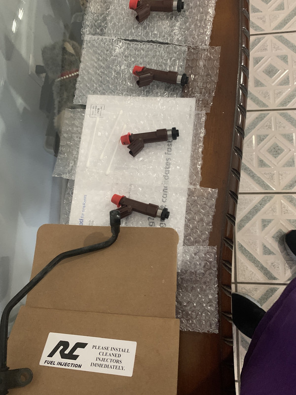

    I got the fuel injectors out and sent them to RC Fuel Injection in Torrance, CA for cleaning. I have sent them injectors in the past, the cars then ran incredibly well and smooth afterwards. They usually have a 1 day turnaround and charge $25 per injector.
    After 133k miles mine were in bad shape, with pattern between fair and dripping, with flow between 117 to 243 cc/min. Not balanced at all! Now they are all at 249-251 cc/min with excellent pattern. I can't wait to feel the power!

    I got the cleaned injectors in, the re-install was nearly effortless. The system is definitely designed to facilitate injector servicing without removing the manifold.
    The truck runs so much better! Very happy with the results, thanks again everyone for the help.

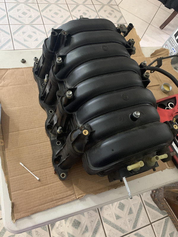

    yes I did it just pulled fuel rail up high enough to take out old injectors and put in new 1 and 1/2 hour first time ..doing it

    Honestly, it's easier to just pull the intake. It takes maybe 30-45 minutes to pull it and you'll have all the access in the world.
