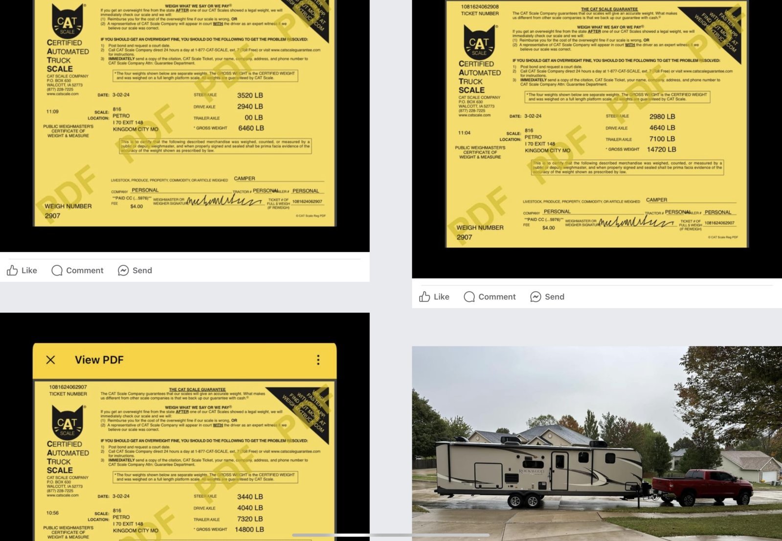

    Yes. Set it up properly, and you’re good to go.
    I saw this on one of the FB groups. Perfect illustration of what a good WDH does. This is how you tow a bigger trailer with a Tundra:
    Top left: modded truck with occupants
    Top right: truck and trailer, no WDH
    Bottom left: truck and trailer with WDH.
    With the WDH, neither of his truck’s axles are overloaded. Those numbers would put my truck 240 lb over GVWR. That means as my tank empties, I would be within GVWR. That small amount over would honestly not bother me at all.
    Fighting that trailer in crosswinds or coming down a very long mountain grade would not be fun at all though.

    I’d hop on the Alcon brake group buy if I were pulling something like that, especially if it involved long grades.

    Those Bigfoot trailers are highly sought after in my area. Much better than average build quality with the two-piece fiberglass shell. No slides that I’m aware of though, yeah?
    Im curious if that trailer would be a different model# south of the border. In US speak, that looks like what we call a 19-21’ trailer….

    That weight ticket is from Kingdom City, MO. That guy is very brave(?) pulling something that long with the winds we get around here.
