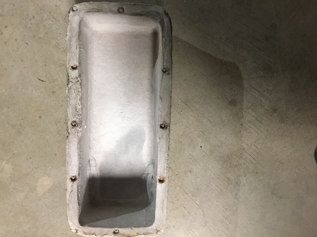

    My a/c evaporator condensate drain clogged the other day and overflowed. The furnace got a little wet, which I dried out quickly. However, this insulation “thingy” got soaked and is falling apart. It looks like it is made of some kind of compressed fiber. I’m looking to buy a new one but don’t even know what it is called. Any help would be appreciated.

    Amana GUX070X30A high efficiency gas furnace.

    That appears to be a heat exchanger end cover, but you need to confirm with appliance part suppliers. Unless it's falling apart, it may be fine if you just let it dry out without disturbing. Did you try Amana's website?
    https://www.amanaparts.com/Shop-For-Parts/a36b1d9738/Model-GUX070X30AP1161708F-Amana-Furnace-Parts
    There are several online sites for appliance repair parts that may be able to offer advice:
    https://www.appliancepartspros.com/amana-parts.html (Nothing found under model number, check with "help".)
    https://www.repairclinic.com/Shop-For-Parts?query=GUX070X30A&sort=parts_by_price_desc
    https://www.ereplacementparts.com/s...scription=1&search_type=1&keywords=GUX070X30A (Nothing found under model number, check with "help".)

    I checked a few of those websites, but they don’t have pictures or diagrams of many of the parts. And without knowing what this thing is called, I’m kind of at a loss. A chunk of it is falling apart after I dried it out, so I need to replace it. Thanks for your help.
