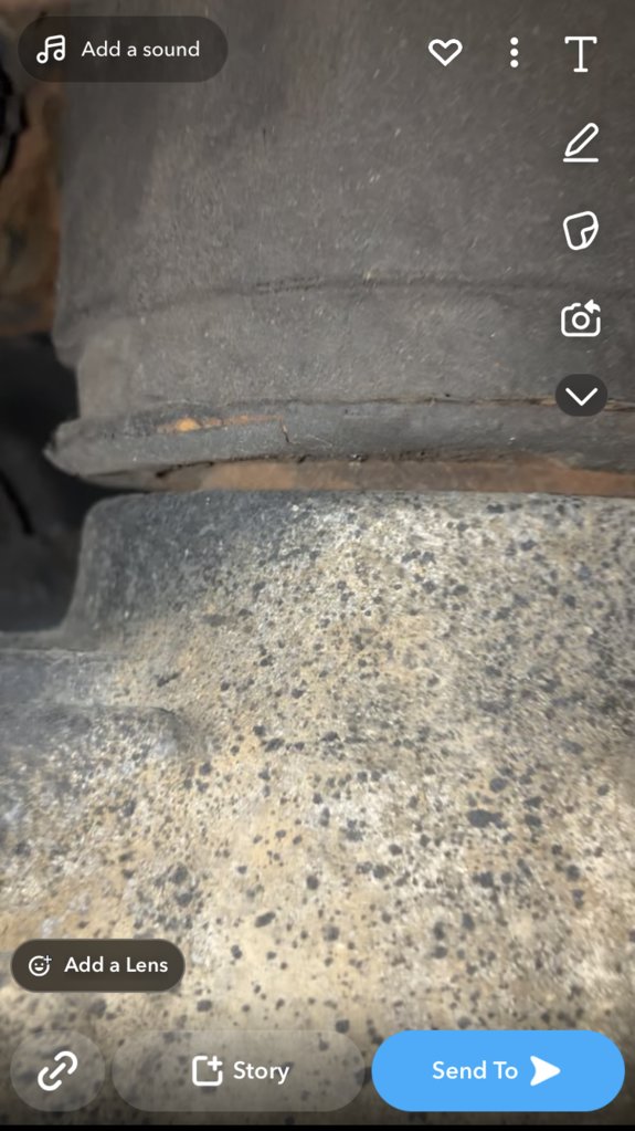

    Is there supposed to be this much room on the inner cv axle?
  8. Nov 1, 2024 at 6:28 PM
    simp
    simp [OP] New Member
    Oct 26, 2024
    #124856
    20
    Also the inner cv joint moves up and down I think I found my problem.
