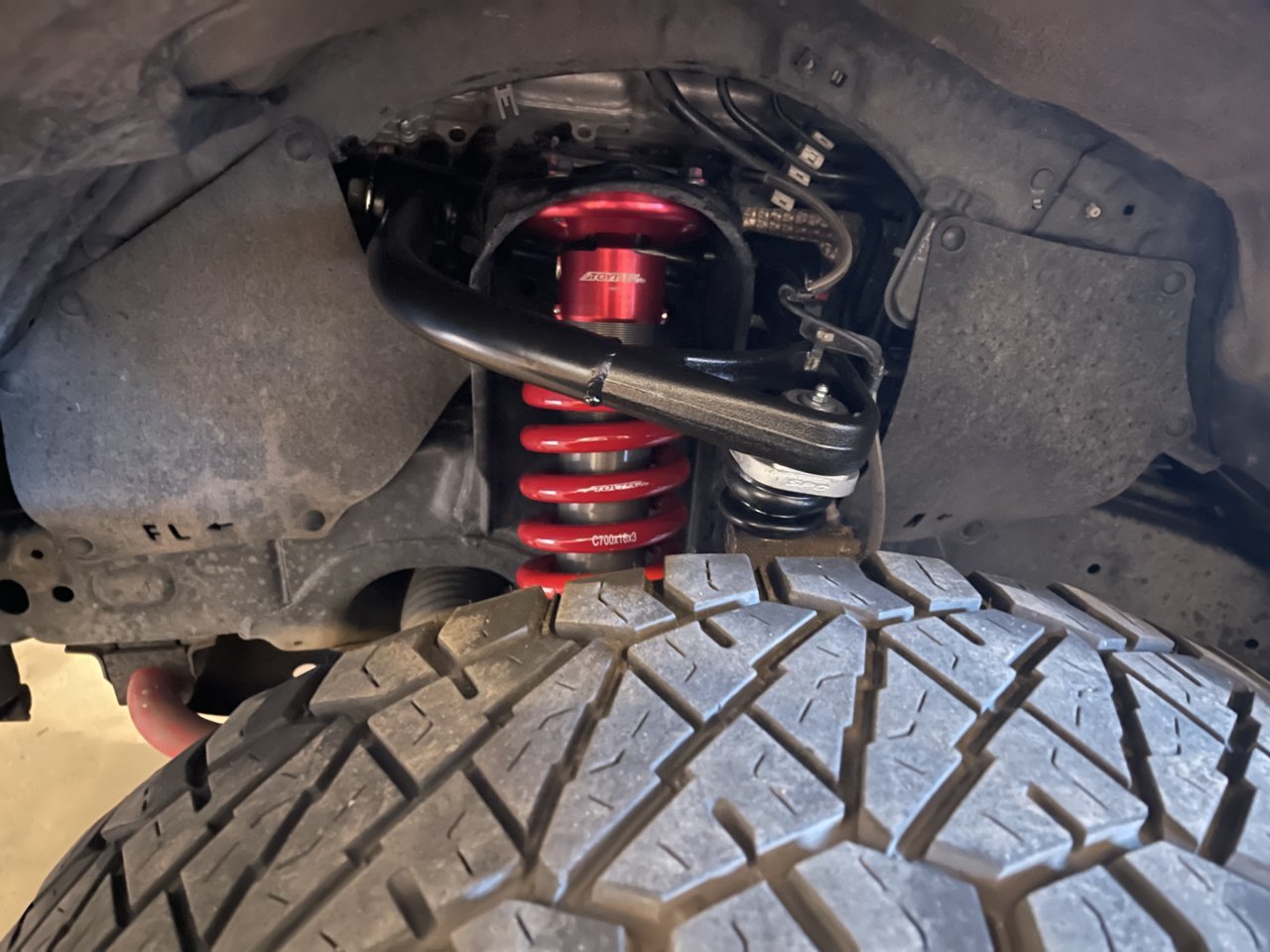

    Eibach Pro Kit. Camburg UCA's. Coachbuilder bumper shims. Cab mount chop. N-Fab side steps. 18 inch Method 308 Roost wheels. Falken Wildpeak AT/3 tires (295-70-18). Gator EFX bed cover.
    I went with the Eibach Pro Kit and have been happy with it. I bought the kit for just under $600. Didn't want to just do spacers, but my offroad needs didn't necessitate spending a bunch more for a more serious setup. Considered the options from Bilstein, especially since there was more feedback and info out there on the Tundra specific applications, but I was able to find the Eibach kit when everything else seemed to be back ordered for a few months. No complaints so far.
