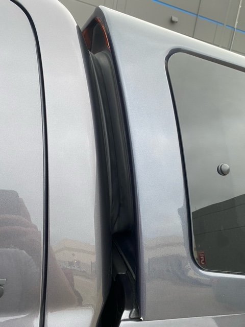

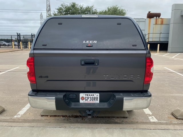

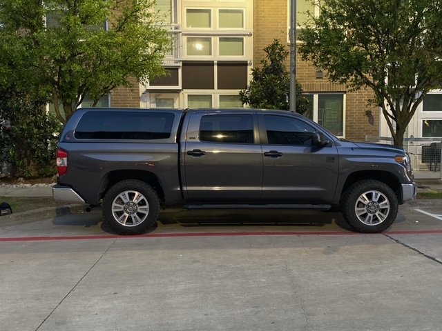

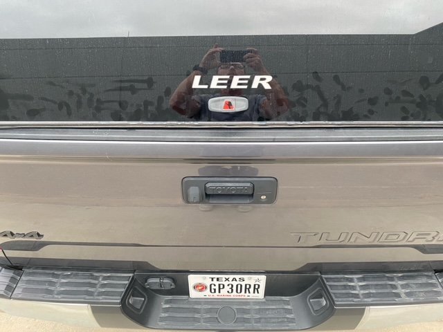

    I bought a 2012 shell and put it on my 2019. LEER, not sure what specific model. It was the crank windows that open the very back, almost like wings and no window up front. The gap on the back is minimal. I didn't have to shim it at all, just arranged it to where the tailgate would close and the rubber gasket up front is as close to the window as possible. Theres a very minor gap in the front gasket and the rear window to tailgate but I'm confident that if I replace the front gasket with a new one, that gap will go away and I'll just put some other kind of gasket at the bottom of the glass and it will seal.
    Moral of the story, if you want a cheaper top that seals all the way around without paying new prices...this LEER works!! Don't be afraid to try it out.
    I'm pretty new at forums and posting so I'm unsure if I can tag this to where it's easily searchable for future people that question this and want pictures. I know it was a pain in the butt finding something before I went and did it myself.
    Let me know any questions. I'll update after I run through some rain, I know it's coming here in Texas!!

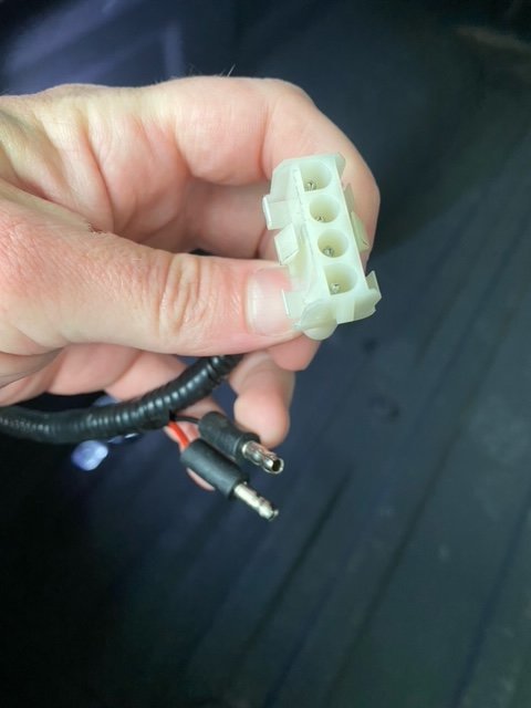

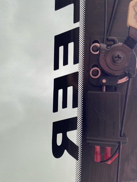

    It didn't come with a key but it does have the lock/unlock wiring for the key fob and buttons with doors. I'm hoping to find a new lock with key and the harness to wire in the lock function. Any ideas?image4.jpg image3.jpg

    Glad it worked out for yours like I was sure that it would!
    New locks are $15 at the dealer and they can certainly give you the correct pin out of that connector too.
    A $20 2"x2" Aluminum L channel will easily attach to the shell or the bed at the cab gap and make it water tight,guess how I know?!
    The color even looks great on yours!
