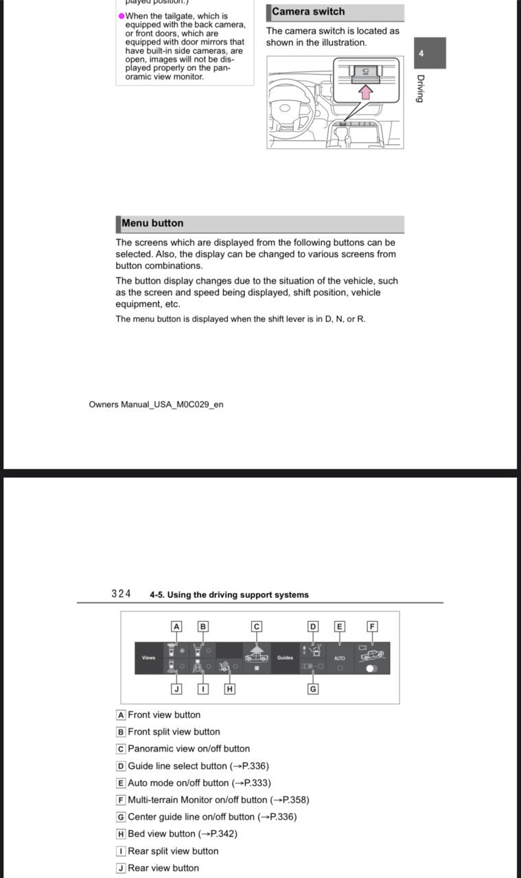

    Have a 2022 Tundra Limited TRD OR Double Cab. Any time I stop at a red light or for any reason, the front camera displays on the monitor. Does anyone know if this is normal? Can it be turned off?

    Press camera switch, deselect Auto.

    Thanks I'm a low tech guy. My previous truck was a 2106 Tacoma with very little electronics. I've spent hours in the owners manual but managed to miss that part. Thanks again!
