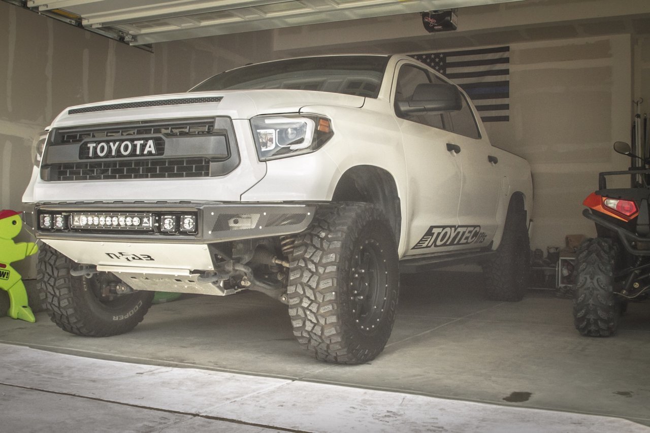

  7. Dec 28, 2018 at 10:56 AM
    163,480
    I’m on 3.5 years with the BOSS!
    Blueknights75 likes this.

    The perfect answer! Thank you T-rex266. What is your wheel combo and did you do the BMC?
  9. Dec 28, 2018 at 11:29 AM
    163,480
    305/70/18
    Yes
