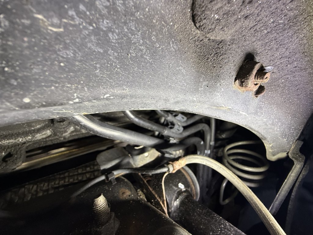

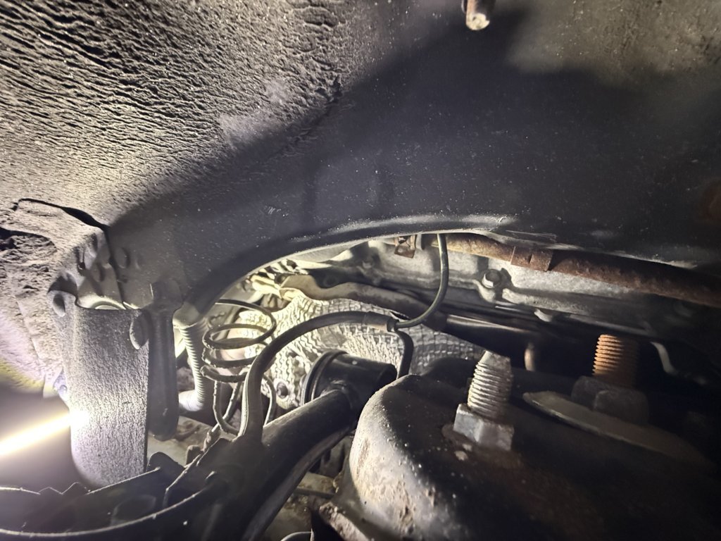

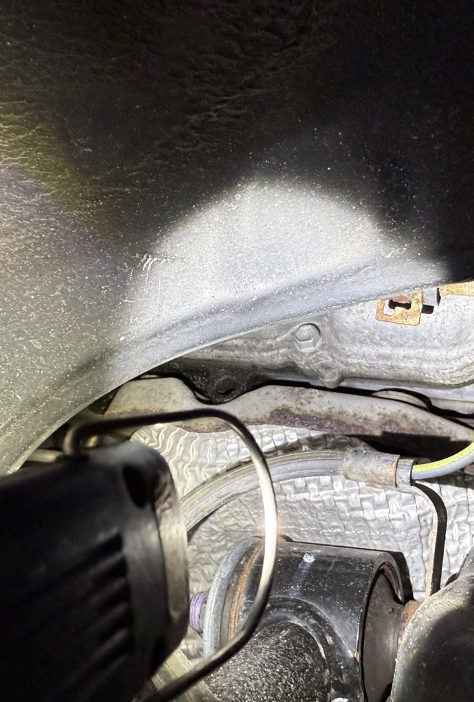

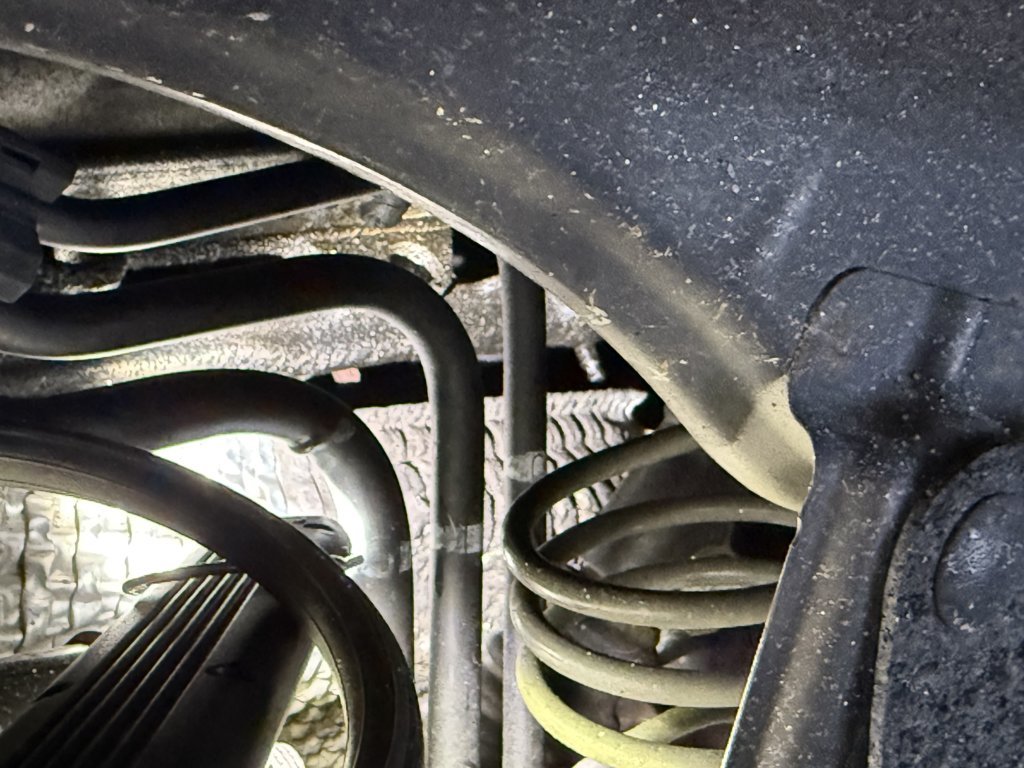

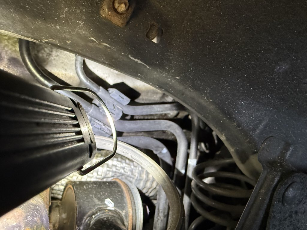

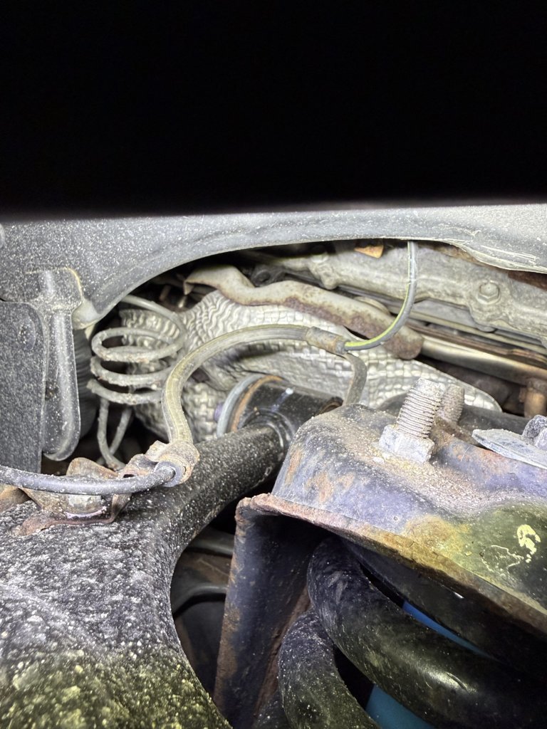

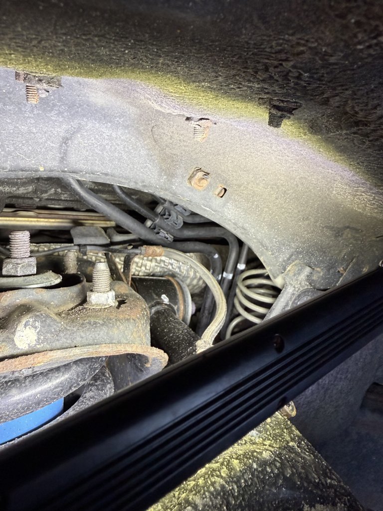

    Mainly just residue. One day I got out of my truck and noticed a burnt smell coming from the driver side wheel well. Thought maybe my belt was rubbing on a frozen pulley or something. Took a peak and saw some wetness on the side of the block, lower down. I can go grab a pic or two of it real quick. Again, no noticeable dripping on the ground.
  14. Mar 8, 2025 at 2:29 PM
    mbgls63amg
    mbgls63amg [OP] New Member
    Aug 3, 2021
    #66317
    29
    Joshua
    2010 Toyota Tundra SR5
    Man. Trying to get a pic of it is a pain. lol Tried as best as I could. Not sure how long it’s been seeping. I say confirmed because I pointed it out to a tech at my local shop, to take a peek. They said it was cam housing leaks.
