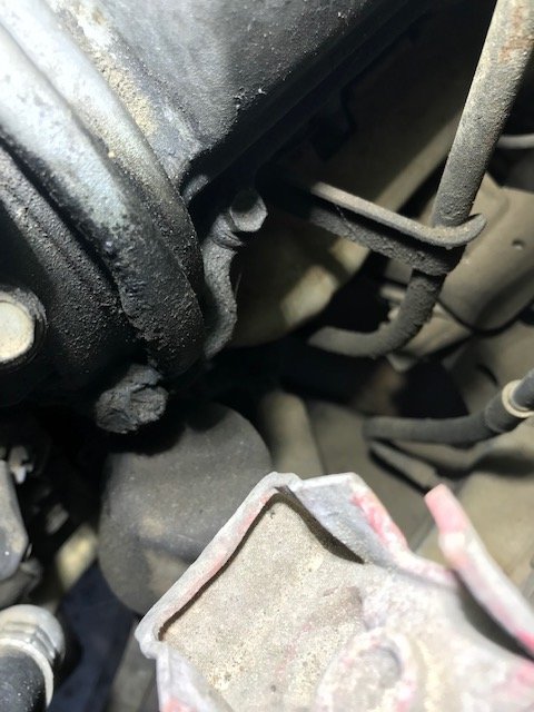

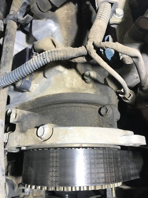

    Newbie here...is this from cam seals possibly? I'm in the middle of timing belt change and wondering if so..do I keep going and replace them? Could it be valve cover?

    The 2nd picture is valve covers IMHO. Someone didn't properly seal the right-angle corners with FIPG. The VC gaskets may be fine, but the FIPG at the corners of the cam tower either failed, or wasn't cleaned/installed properly.
    The 1st pic I'm having trouble orienting myself to figure out where it is. That staining/leeching looks really high up on the cam tower and I can't tell. Cam seals for me were leaking down the front of the engine block.
    That said, if it were me, I'd throw a full bottle of this in the crankcase and run if for a few hundo miles. It shored up my cam seal leak and they claim it only rejuvenates seals and gaskets, it won't overswell or damage gaskets or clot fluids like a lot of the magic-in-a-bottle BS does. I've read a number of pro-mech glowing reviews of the stuff for RMS leaks specifically. At least cam seals in your non-VVTi are way easier to do, so if you're replacing the TB/WP anyway, just do the cam seals at the same time. Better to do it while you've got it open.

    Oh, and sometimes valve covers leak simply because the bolts have loosened due to the rubbers shrinking. But be careful, the screws are known to break if overtightened.

    "The 1st pic I'm having trouble orienting myself to figure out where it is"
    sorry..I shoulda labeled them..the first one is passenger side.

    I see youre right. I saw this in forum.
    " So I noticed a leak coming from where the passenger side valve cover meets the head. So I went to the dealer to pick up a new gasket and spark plug tube seals. When I went to remove the valve cover bolts, they all unscrewed with virtually no resistance. The Haynes manual says the torque specs for these are 53 in/lbs which obviously is not very tight at all, but these almost seemed like I could unscrew them with my bare fingers! Got me thinking that maybe this is the reason I'm experiencing a leak there"
    Im looking up the specs now...getting different specs but 53 is coming up alot..

    53 INCH LBs specifically, don't do foot pounds! :rofl:
    53 inch lb is like just shy of 5 ft lb if memory serves. I think most torque wrenches for ft lb start at 10, so you can't really get that low.
