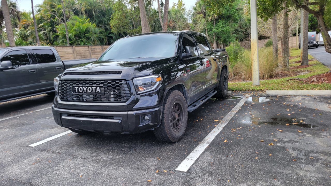

    (pic of the truck before install.. but CLEAN:thumbsup:)

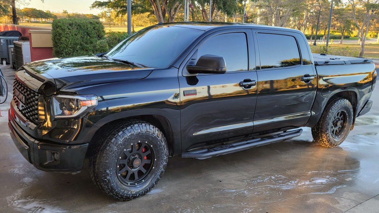

    This is the current stance at the second from top shackle hole (2nd from the lowest) on the rear and the 2.5 front.
