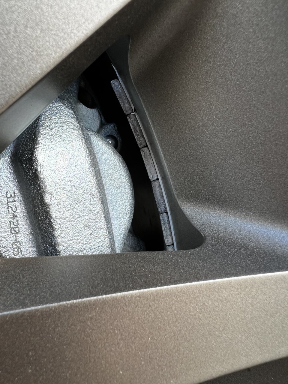

    montera.built

    You need to have the sticker weights inside the wheel placed so it clears, here’s a pic I took of some 17s on a tundra at the dealer. I don’t think this is a good placement but it works.
