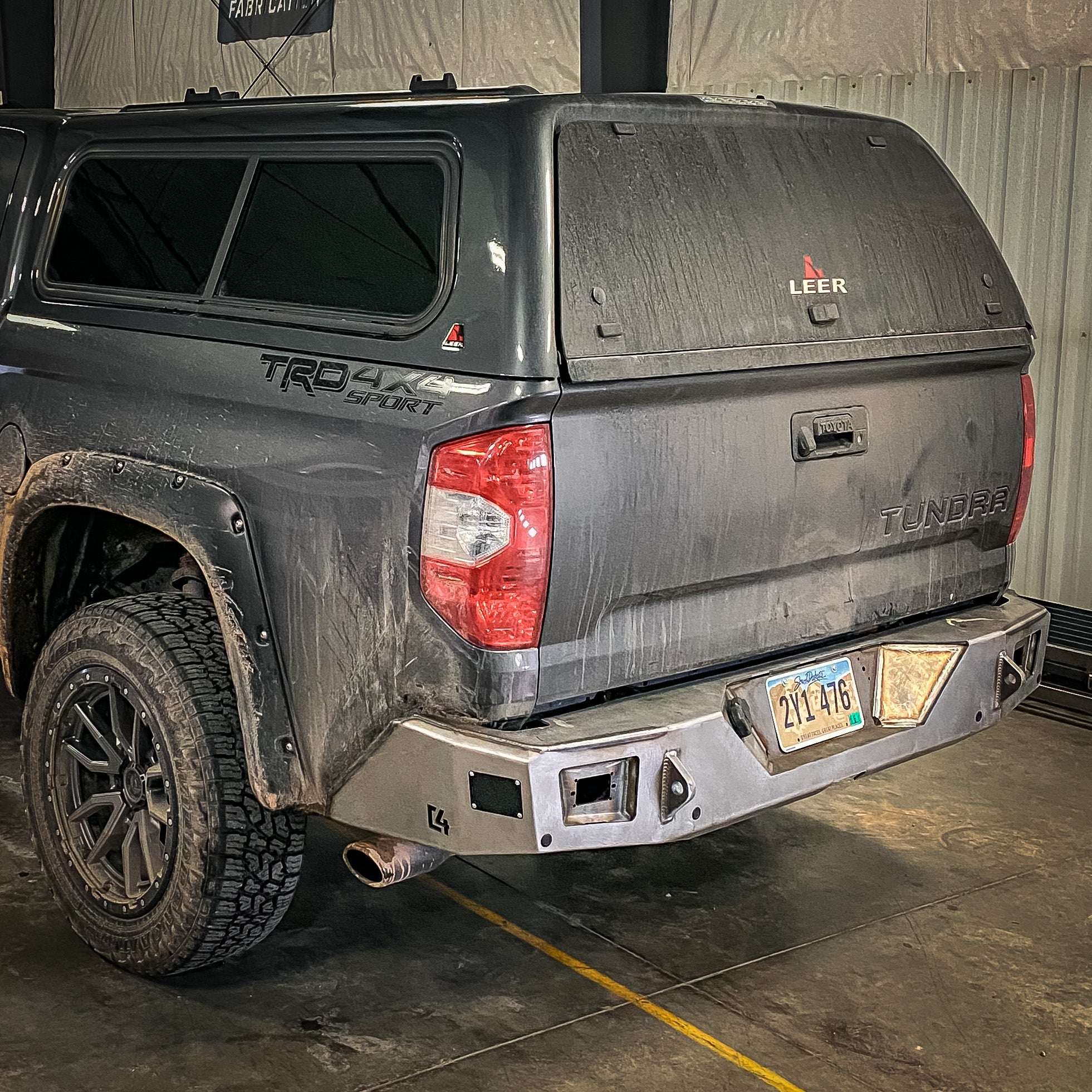

    I’ve also not actually seen pictures of the C4 with the plastic insert/covers that are part of the BSM-compatible design. All the ones I’ve seen are older pictures of the pre-BSM design, which are solid steel sides/corners with the C4 design cut into them. I have their Hybrid front bumper and love it - but also got it powder coated locally.

    Updated pics are on the C4 website. I should have used one in my OP. https://c4fabrication.com/collections/c4-products/products/tundra-overland-series-rear-bumper-2014
