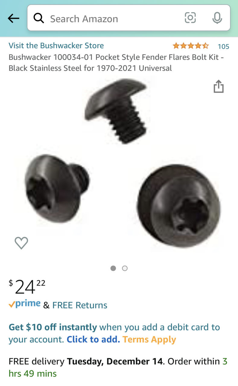

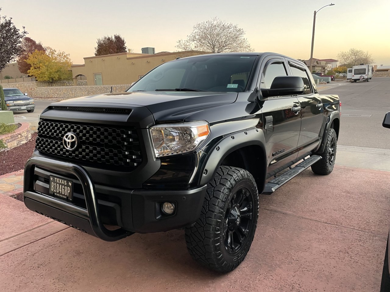

    Just installed some black fender flares. Bought black stainless steel screws. Rubber trim is a pain in the ass to install.

    Looks good! If I’m you I go for those more Morimoto headlights. Someone is selling a pair but I think it would add to the look

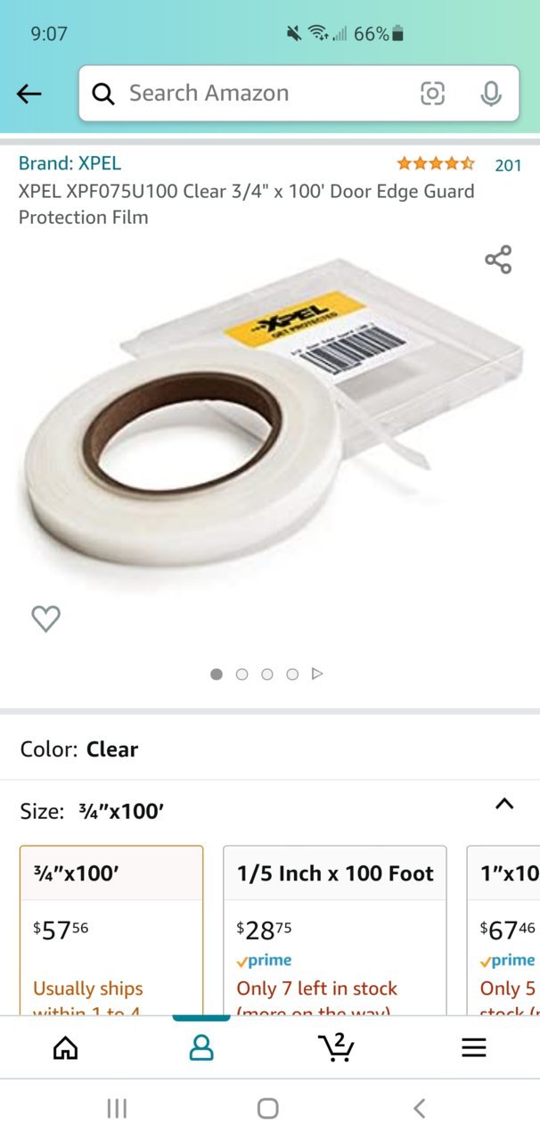

    PPF goes on the fender in between the flares.
    “Paint protection film (PPF) is a thermoplastic urethane film that goes over any painted surface on your car's exterior.”
  10. Dec 7, 2021 at 5:17 PM
    shawn474
    shawn474 Lego connoisseur
    Jul 23, 2019
    #33569
    2,777
    MoCo, Maryland
    PPF on the paint before installing the fender flares so the paint underneath doesn’t get F’ed up. Fender flares are notorious for causing paint issues underneath

    looks good. diggin the black matte/satin on gloss look

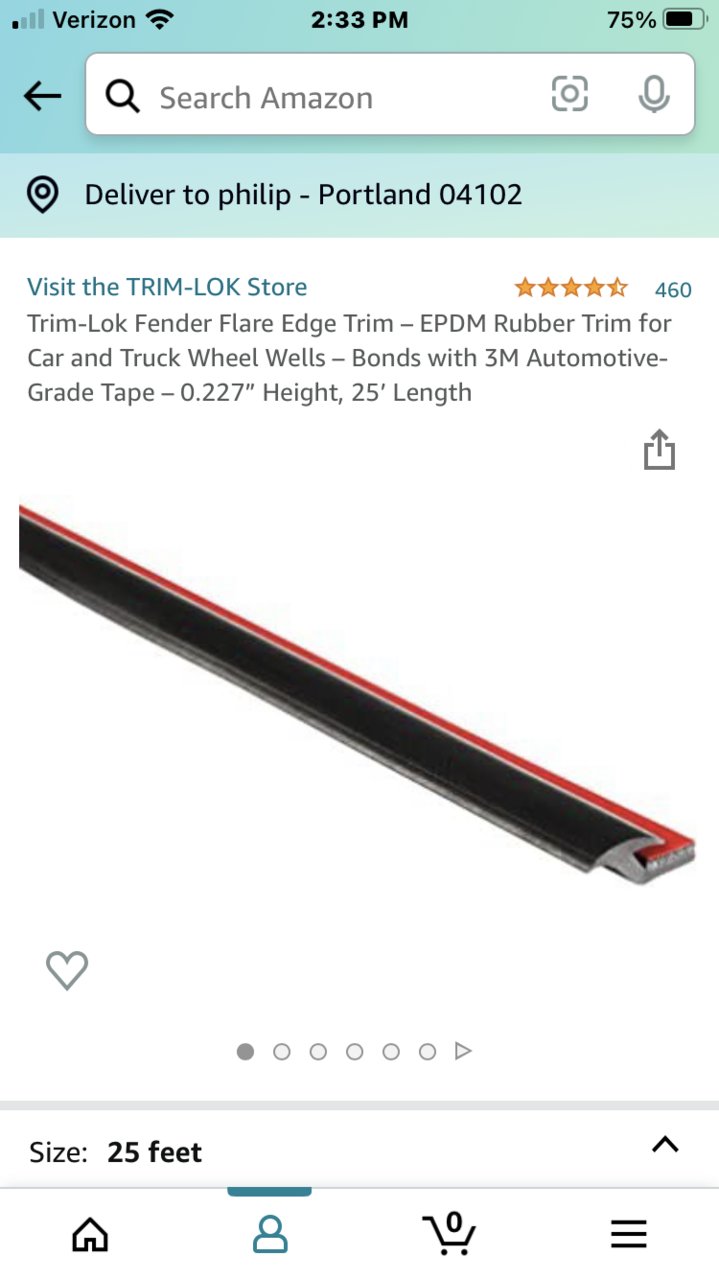

    I installed the same 202 black painted bushwhackers and installed with the rubber flange gasket they sent. They were horrible from the start, left gaps and didn’t adhere properly even when I was super meticulous in the prep. Anyhow a year later I removed them and redid the whole install with a wider gasket recommended and with the PFf over the paint. Live and learn… they have been perfect ever since. The film protects the paint and worth the extra effort. I had to use compound to clean the rub marks left by movement of the gasket. As an aside, I used the GF’s black nail polish to paint the shiny stainless faux screws and they look great! My cheapest mod

    Where did you get the wider gasket?

    Amazon.....part number was confirmed by BW and another member here in the forum.

    On Amazon
    With the 25’ roll I came up short by a few inches with no waste and just finished up with what I had on hand. I mounted these carefully in the house and let them sit overnight. I had no issues with adhesion before or after. The fit is snug.
