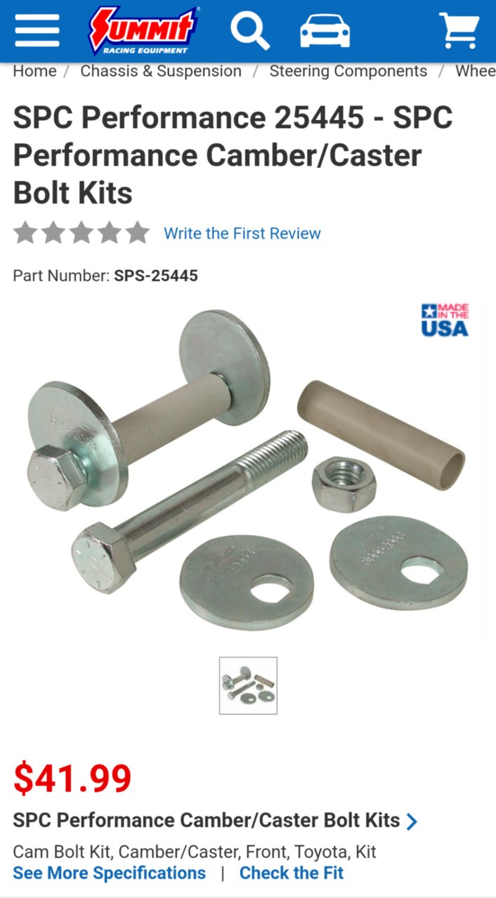

    Is it the same tech/ place that aligned your truck twice that says they're having problems with the adjusters? If so, I would get a third opinion. Have the tires been rotated regularly?
    I don't think there's anything wrong with your adjusters personally, but these are the adjusters many people end up going with aftermarket. Note, one kit is only for one side. https://www.summitracing.com/parts/SPS-25445

    Two different shops. The tires are shot. I'll be getting new tires, but not before Im sure the suspension and alignment is good. I'm going to jack it up and try to wiggle the lowers with a pry bar before I order anything.

    If they are having trouble with the adjusters, that's just another way of saying the cam bolt bushings are sized. The only thing they can adjust is the tie rods. You are not getting what you paid for.
    Cut out the old bolts and replace along with control arms and LBJ's then get it aligned.

    Again, half the price of OE. These look like junk though. They are really popular?

    Make sure that you mark the existing alignment on your old bolts before removal so that you can install the new ones relatively close to where the old ones were. I use White-Out for this. You'll still need an alignment (obviously) but this will make it easier for the shop.

    Thanks, I like those Moogs better. Not sure if hollowing out the bolt for the grease weakens it enough to be worried about though.
