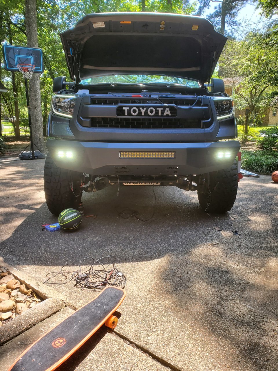

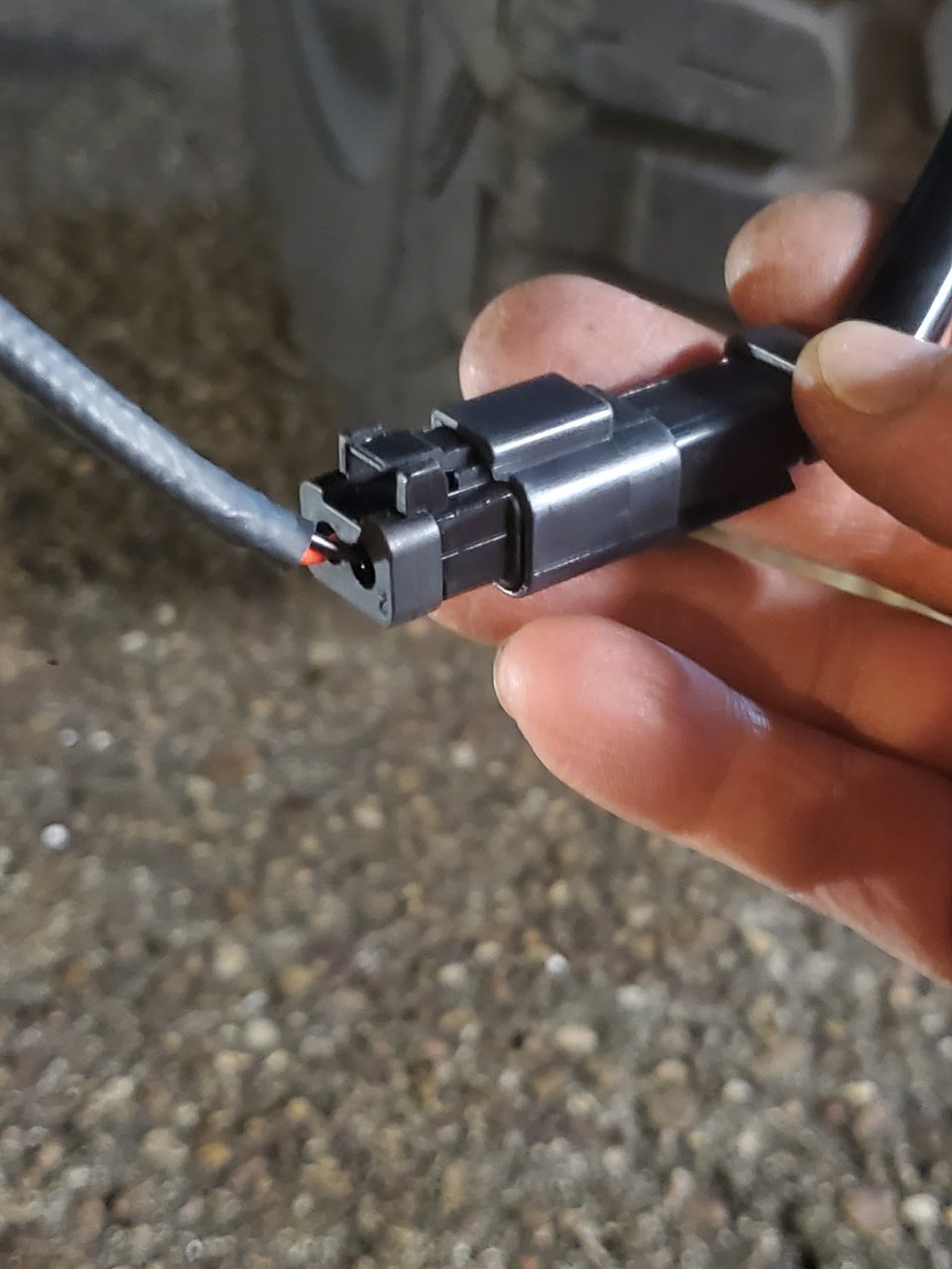

    Thought I could clip my existing fog light plug off, splice in the end off the new light harness and get some fogs to come on. Nope. The bumper has 2 fogs per side and includes a pigtail that takes wiring into a single plug.
    Any idea why I can't get the new fogs to light up?

    Double check you have all the pos to pos and neg to neg....check the fuse

    New light may have a high/lower resistance than the truck likes:notsure:

    I've heard from several sources that RC sent these out with faulty plugs :(

    Ok figured it out. After talking to several people who have the same bumper, the possibility that the polarities/wire colors were switched became a good lead to hunt down. Sure enough I pulled the splice apart and checked the black wire in the fog light harness - test light lit. So black was red and white was black. Fantastic. Same thing applied to the other side.
