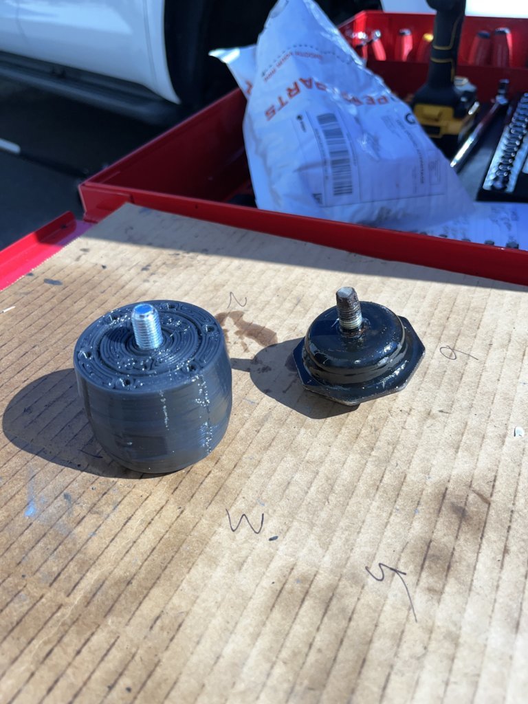

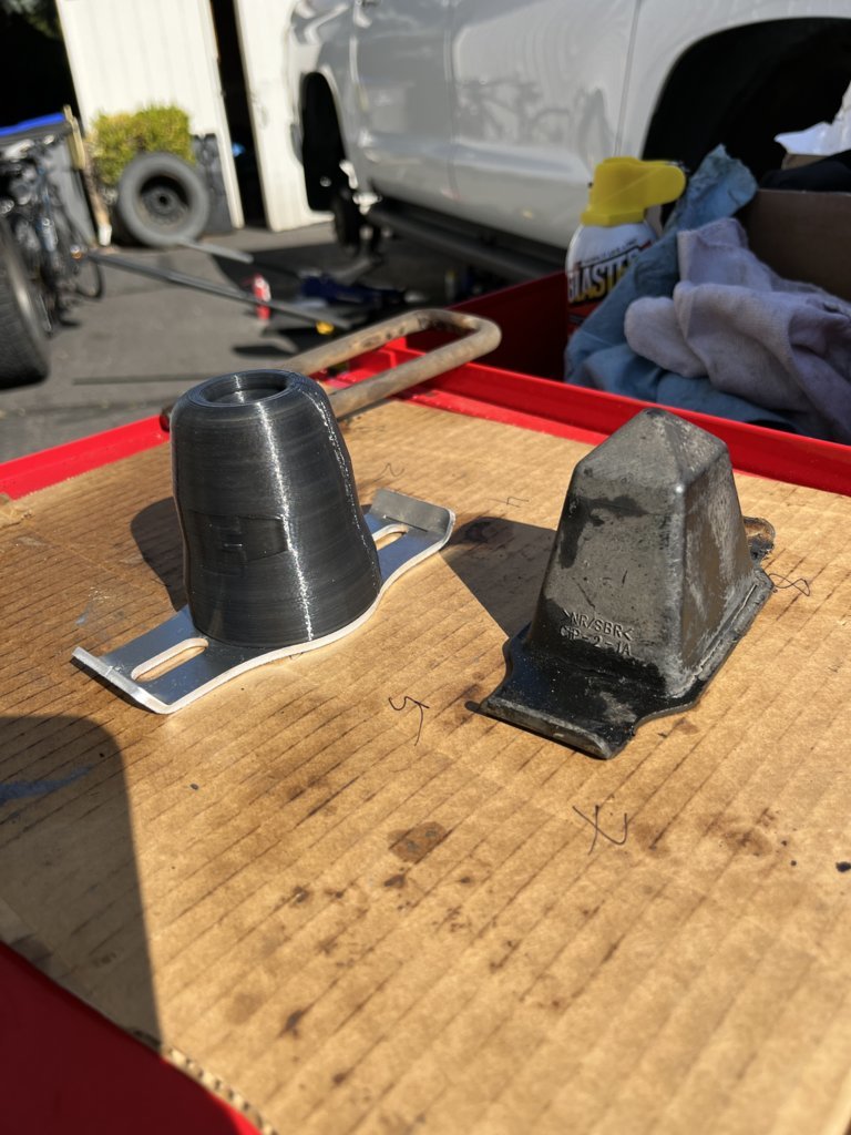

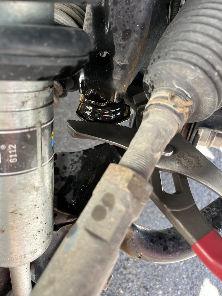

    OK, so I thought I’d finish my bump stop project today

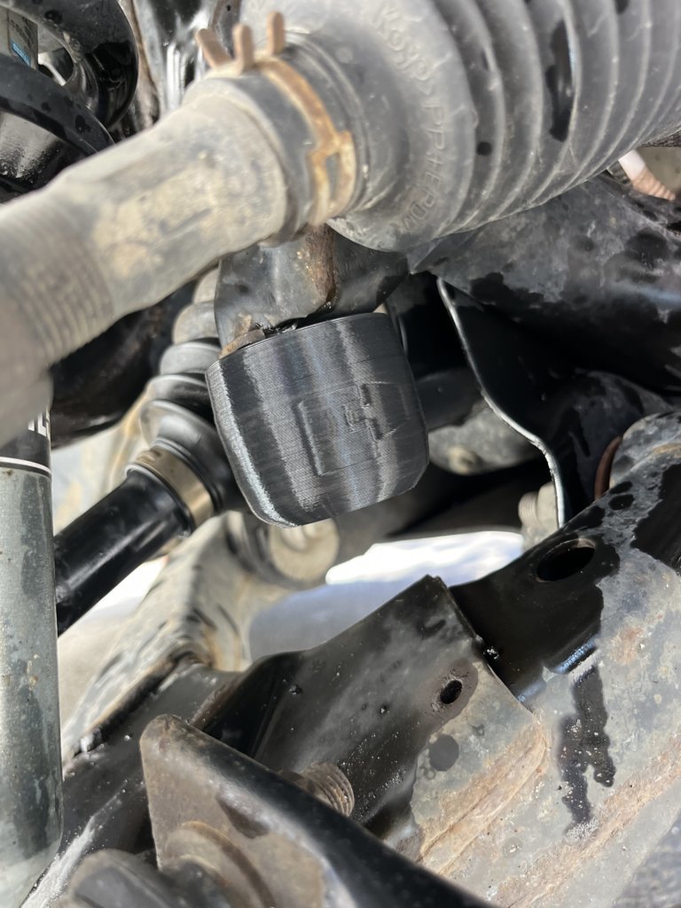

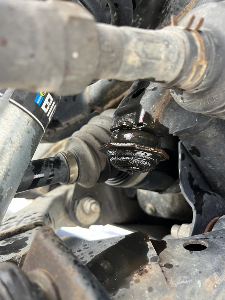

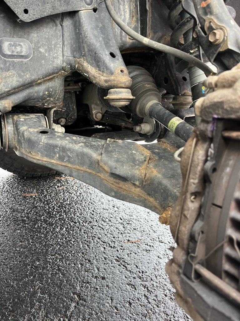

    But I didn’t realize there’s TWO bump stops up front !

    You can leave the one oem bump stop, the longer one will stop the LCA’s; you don’t technically have to change both. If you really wanted to, you could space the shorter oem one with a washer (my 6112’s came with washers to space them down 1/8” or so)

    Most off road companies tell you to replace the rear most front bumper stop but to leave the forward most as the stock. Since they are drastically different materials and function differently, leaving the front one as stock is a safety net if shit goes wrong either the aftermarket one.

    Step 5: Install the DuroBumps at the rear of the lower control arm, using a 14mm deep socket. Tighten the bolt until snug. Do not over tighten. The OEM bump stop that is located at the front of the lower control arm will remain in place.
    From the Durobump installation instructions.
