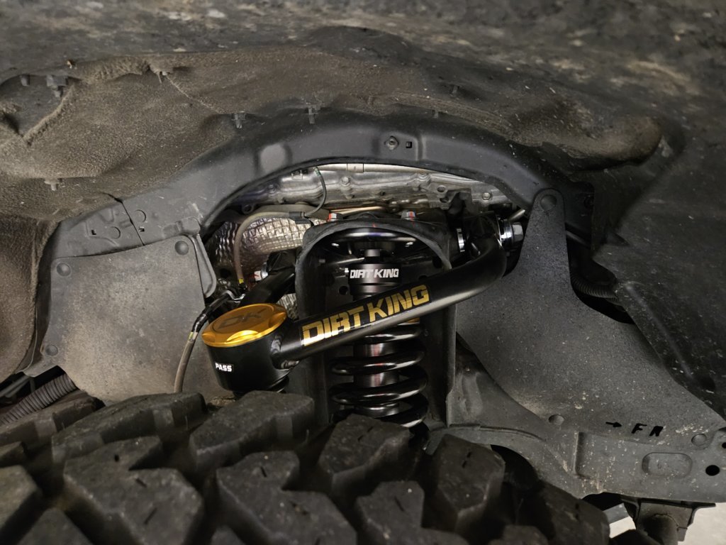

    Installed suspension goodies.
    Front got 5100s reusing stock springs.
    Rear got Coachbuilder +2 shackles, abs wire extension bracket (DIY), Bilstein 5160 rear shocks, and modified a Fox roost shield to protect driver side shock shaft.
    Got roughly 2.5" lift in front and 1.25" in back.
    Had to rotate the TRD sway bar mounts on the axle to gain some clearance from the leaf spring at full droop. Because of the shackles, leaf might still touch my exhaust and/or sway bar but only when I flex it out.
    With the resi piggybacked on the shock body, mounting the roost shield the normal way it's intended to go (clamped on near lower shock mount) means shield would hit the bottom of the resi on hard compression like stuffing the back wheels. Confirmed the truth of it even after cutting a few inches length off the shield by slowly flexing it through a ditch in the yard. So I cut the shield even shorter and mounted it upside down. By cutting away the screw holes and a little extra, it's basically a snap fit over the shot body and some zipties are enough to hold it now.

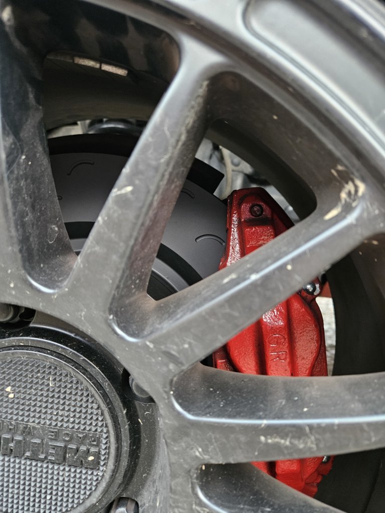

    a few pics to add.
    Stuff done of the summer so far.
    Pair of reverse lights in center plastic section of bumper.
    Cleaned and painted front calipers.
