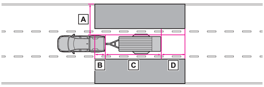

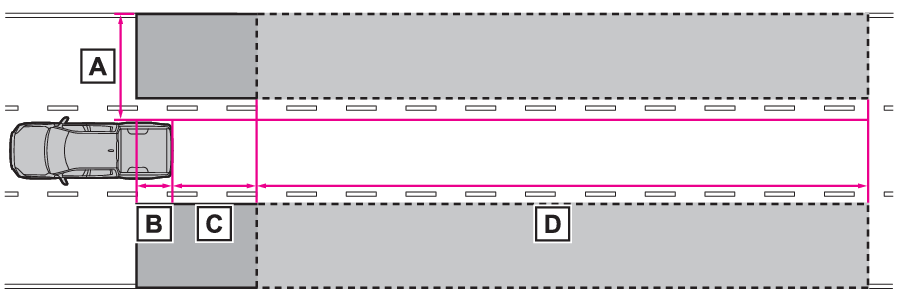

    From the online manual:
    The Blind Spot Monitor detection areas
    The areas that vehicles can be detected in are outlined below.
    When not towing a trailer [​IMG] The range of each detection area is: Approximately 1.6 ft. (0.5 m) to 11.5 ft. (3.5 m) from either side of the vehicle *1 Approximately 3.3 ft. (1 m) forward of the rear bumper Approximately 9.8 ft. (3 m) from the rear bumper Approximately 9.8 ft. (3 m) to 197 ft. (60 m) from the rear bumper *2
    When towing a trailer [​IMG]
    The range of each detection area is: Approximately 1.6 ft. (0.5 m) to 11.5 ft. (3.5 m) from either side of the vehicle *1 Approximately 3.3 ft. (1 m) forward of the rear bumper Trailer overall length *3 Approximately 9.8 ft. (3 m) from the rear end of trailer *3 *1 The area between the side of the vehicle and 1.6 ft. (0.5 m) from the side of the vehicle cannot be detected. *2 The outer mirror indicator warning may be delayed. The delay increases in proportion to the speed differential with vehicles approaching in the adjacent lane. *3 The system does not support trailers wider than 8.5 ft. (2.59 m) and/or longer than 39 ft. (12.0 m). For box trailers and certain other trailer types that are up to 8.5 ft. (2.59 m) wide and/or 39 ft. (12.0 m) long, the indicator warning in the outer mirror may be delayed if the vehicle in the adjacent lane overtakes your vehicle at a high-speed differential.
