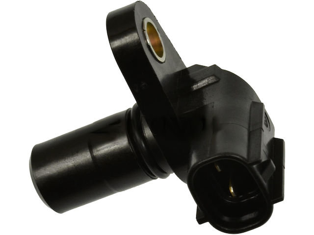

    The ABS plug seems to be ok with no visible damage. Any idea where the speed sensor plug is?

    There’s one on each wheel. They look like this, but you only see a little of the wire end.
