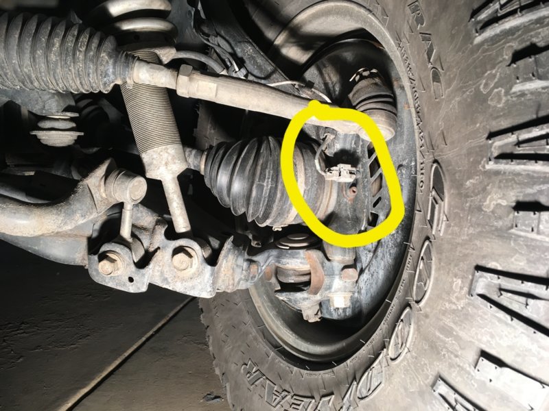

    Hey everybody, I was going through some pretty deep water with a thin layer of ice over it and seem to have broken a sensor located on the front suspension of my truck. 4hi light is blinking, parking brake light is on, abs and traction control lights are also on. I'm not sure what the sensor is, I'll include an image below

    Wheel sensor. They sell protectors

    Just a guess based on light display

    Gotcha....no worries. Thinking about it, I believe that the ABS sensor is the only sensor on the suspension.

    This one?

    There are guards available for them and they are well worth it. Not just for protection from ice but for anything that may end up contacting the undercarriage.
