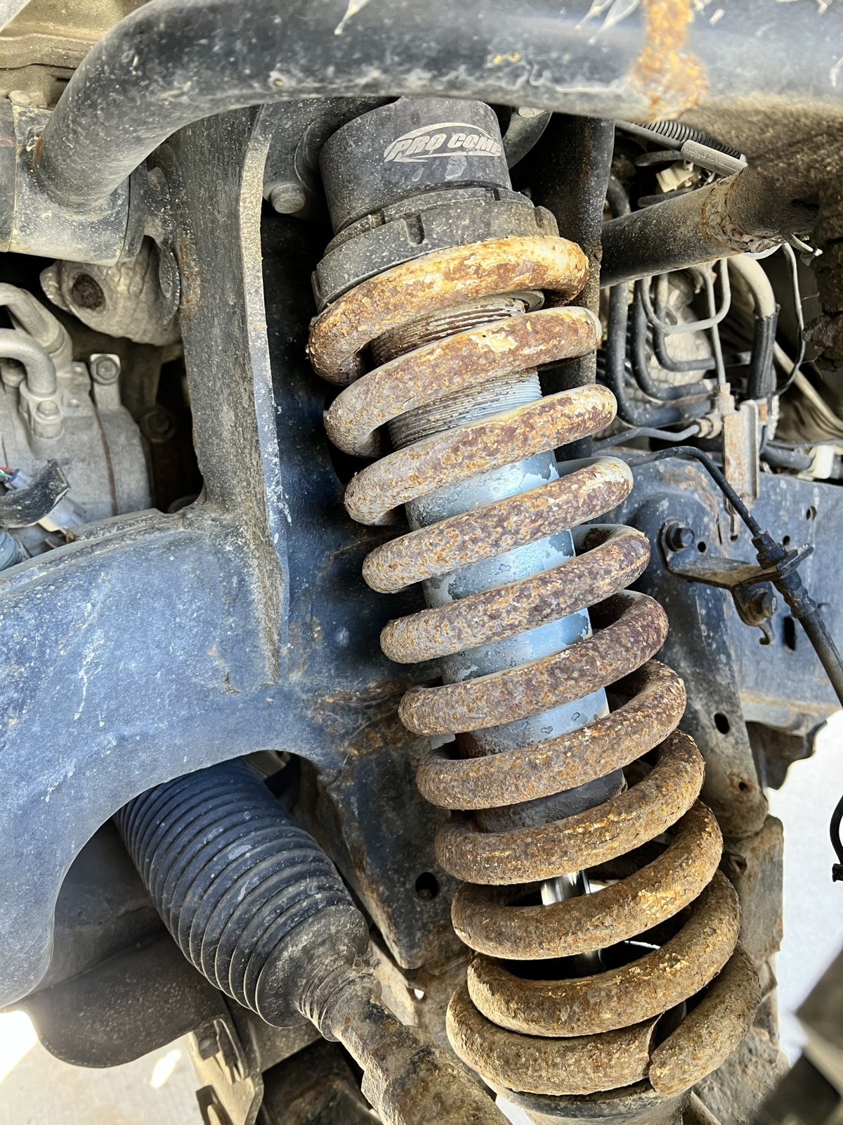

    Hello, I’m new to the forum and need help. I have a broken front coil spring…now here is the bigger problem. It’s on a pro comp adjustable coil over set up for my 6” lift. Pro Comp no longer makes them and their only suggestion is to go back to stock and add a coil spacer for the lift. As you likely know, the adjustable coil overs are NOT cheap and I’d hate to give them up because of one broken coil spring. I’m in Winnipeg, Manitoba and a spring shop and another performance shop either doesn’t handle coil overs or can’t get a replacement part, as I said, because pro comp stopped making them. I would really like to salvage my set-up. Can someone tell me where I can order (and what to order) a replacement spring (I know I may have to order two springs and re-adjust the coil overs accordingly). I just really want to salvage this set up. Any help is appreciated!

    Welcome to the forum! I would send an email to Procomp to see what the dimensions of the springs are, then you can purchase a new spring from a number of different places. Off the top of my head, I know that Accutune, Filthy Motorsports, and I believe SDHQ sell Eibach springs, which should be a direct replacement for your broken spring. Best of luck!

    I would first see if you don't need to replace the coilovers first anyway. Those spring preload threads are in pretty poor condition.

    Thanks a lot Brey and good point Colorado. I think they look worse in the pic than they are. Really just some minor surface rust and was clearly quite dirty when I snapped a quick pic. I’m thinking they are still okay but will look into with the shop prior to replacing.

    Is that what the setup looks like at rest? That almost looks like a coil bind situation to the naked eye from afar.

    That is at rest but you can see where the spring is snapped right at the base of the spring at the bottom.
