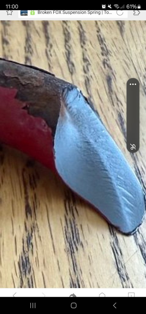

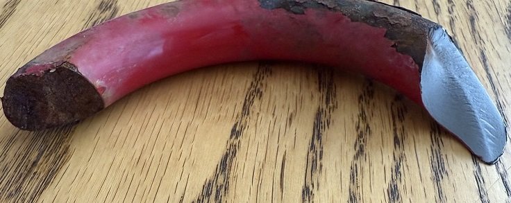

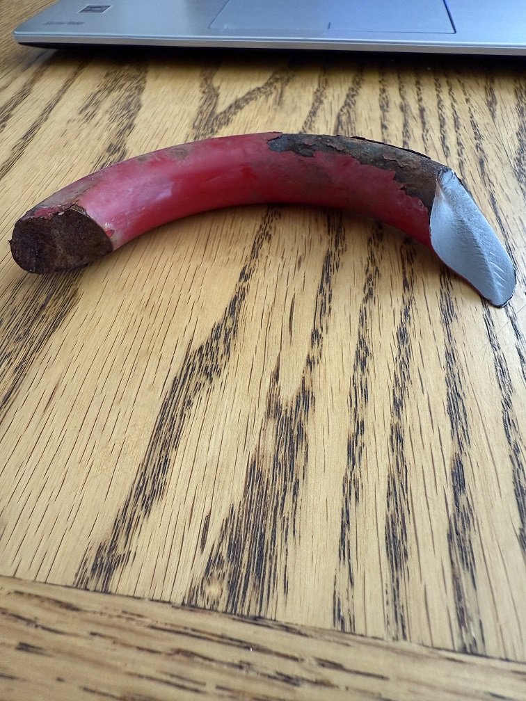

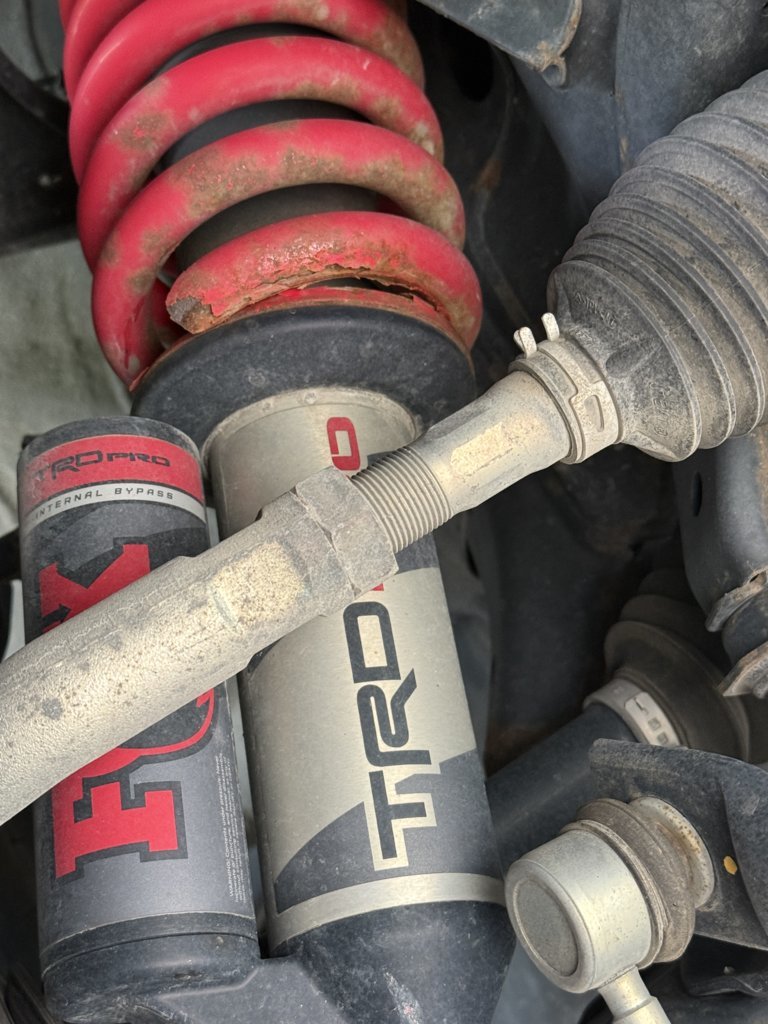

    Pulled into garage this morning after a Lowes run and there was a piece of red spring in the middle of drive. Sure enough looked under the truck and the front right spring was broken. Truck has 22500 easy miles. Can I get just a replacement spring? I called local Toyota dealer and of course they want me to bring it in so they can diagnos the problem..... well duh! I'm sure it's not warrantied. Thoughts?

    Fracture initiated at a surface flaw caused by corrosion.

    Possible that the flaw was there prior to corrosion?
    Not that it makes much difference.

    if you look close at that pic of the entire spring piece, the left side of pic, that has been broken for awhile. I thought I heard a slight clicking noise in the front for awhile when turning in the drive. I'm already looking for parts. Screw the dealer bs!

    '21 Limited MGM CrewMax
    I wish I had the good news story here. While I did go chasing down every rabbit trail I could... I was unsuccessful. I was able to positively identify the spring. However, the different diameter top to bottom makes this spring unique, and one that Eibach only makes in ONE application. This one. That said, the spring is locked under contract with Toyota, and as a result they were simply unable to sell me one. The guy's dealership told him that they couldn't replace just the spring either, and that the entire assembly had to be swapped.
    What we ultimately did was get the Eibach Pro truck lift spring (HERE) for building onto his existing springs, and we sourced him a completely different suspension for his truck. He then sold the rebuilt/lifted TRD Pro suspension as used because he didn't want the additional lift. These spring breaks are kind of a shit deal on the TRD Pro setups because none of us can fix them "aftermarket" due to the unique-ness of that spring.
