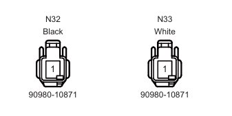

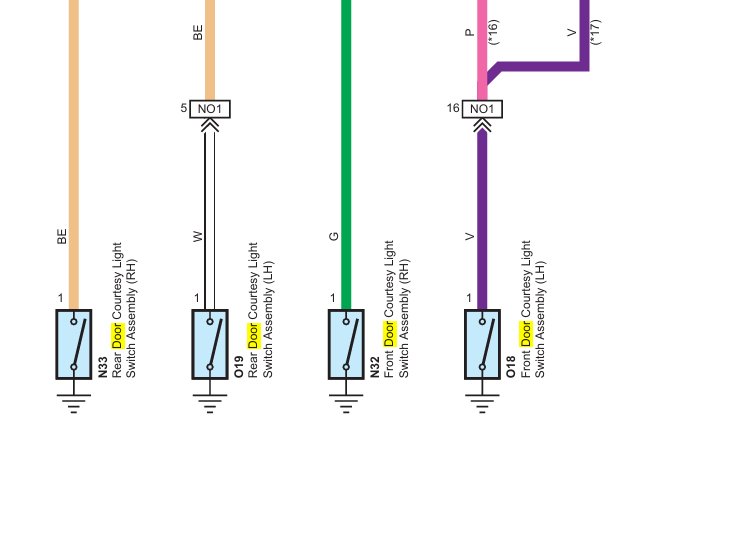

    Couldn't you just unplug the switch?
    I think it grounds the circuit when the door is open and the circuit is open when the door is closed..
    upload_2025-7-11_13-11-10.pngupload_2025-7-11_13-12-6.pngupload_2025-7-11_13-11-55.png
