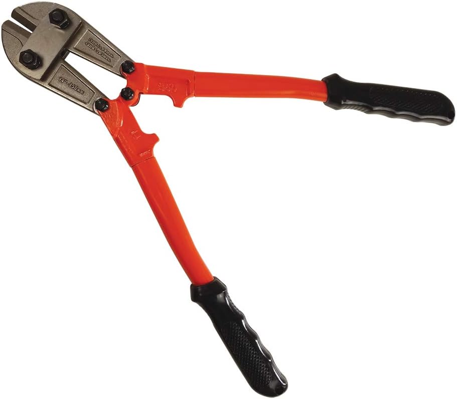

  6. Aug 13, 2020 at 11:46 AM
    TH1776
    TH1776 New Member
    Jul 13, 2020
    #49274
    55
    FL
    040 PRO
    Something like this. Had to use one on my son's car.
    EDDO likes this.
  7. Aug 13, 2020 at 12:03 PM
    Piggdawg
    Piggdawg [OP] New Member
    Aug 13, 2020
    #50738
    4
    Thanks. Just went and bought one. Now let's hope I don't blow up my Tundra. Thanks for the help yall
