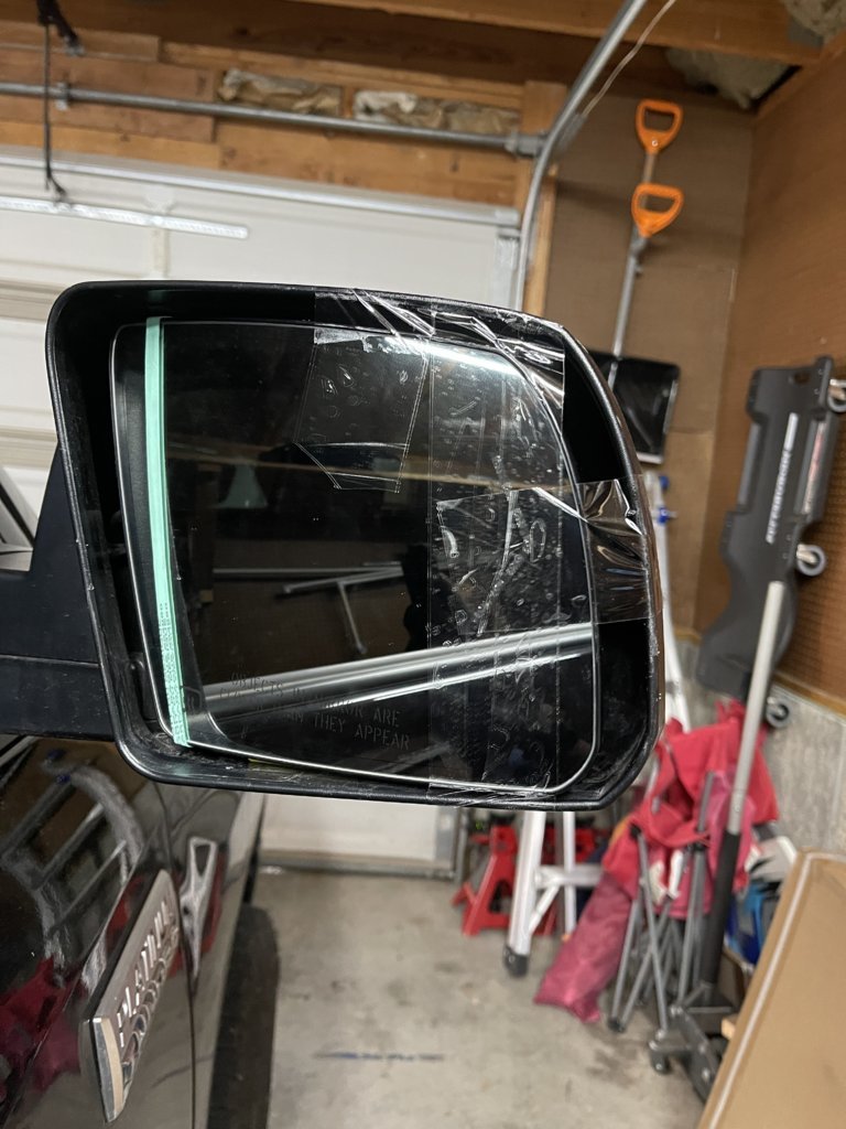

    Do i need a whole new mirror? Backed out of the garage and misjudged the side. Broke it.

    yeah ,man...you need a new mirror...I tried the new glass from aftermarket and it didn't fit right...you're housing has a part that "pops" on the glass holder, which is still on the mirror glass it appears...the part on the mirror housing itself in the center look broken...sorry man...
    Fred Anderson has their 25% sale going on right now for a couple more days but they're not cheap...eBay is the best best unless you have Facebook Marketplace...I ended up taping the old glass on where it was almost "sealed" onto the housing while I waited on finding mine on marketplace...God's speed!

    At first I thought the mount was broken, but according to this video you can replace it..
    Any time I've removed the mirror glass, the glass popped off the mount, I've never seen the mount come off with the glass.
    2007 - 2021 are the same.
    https://youtu.be/cLwlxAxusMQ?si=guBxIrjFBJKtcWvy
    Good luck

    Is the middle broke, I can't tell?
    I've never had that mount off before..
    This is the the only way I've removed the glass..
    https://youtu.be/OhKT3rYwIwA?si=sVYxM7Ki3iqEvk0z

    Looking at that video, what you have should pop back on..:confused:
    Does it not?
    I'm so confused..:mad:

    The ball that ‘pop’ in is broken. Along with 2 of the adjusting or tilting wheels.

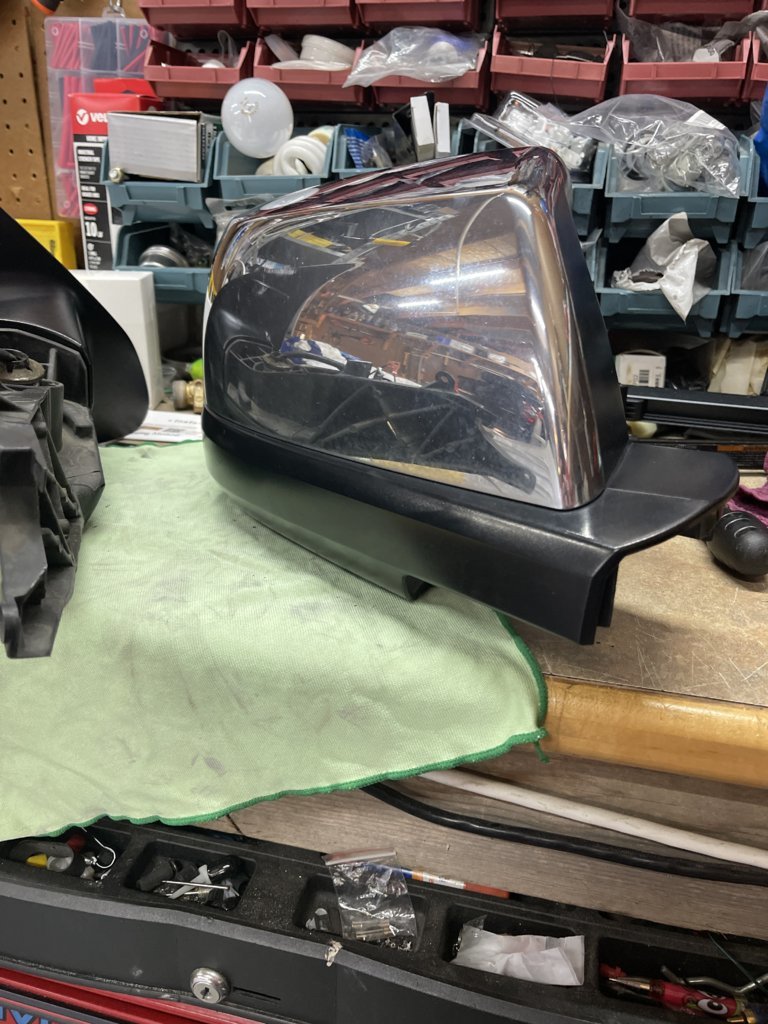

    I have a set of 2016 limited trim- power adjust, heat, BSM sitting in my garage if you need a donor for parts let me know. I’d let them go for cheap for someone in need.

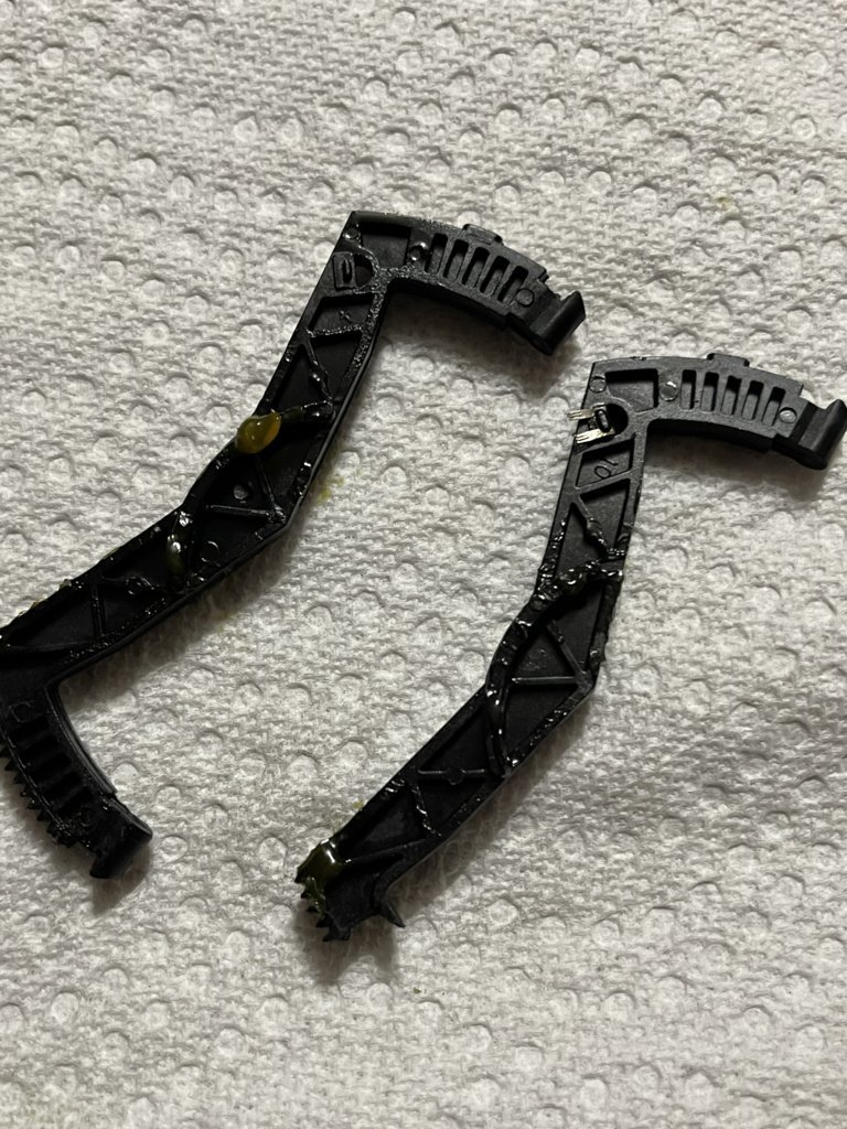

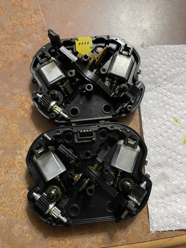

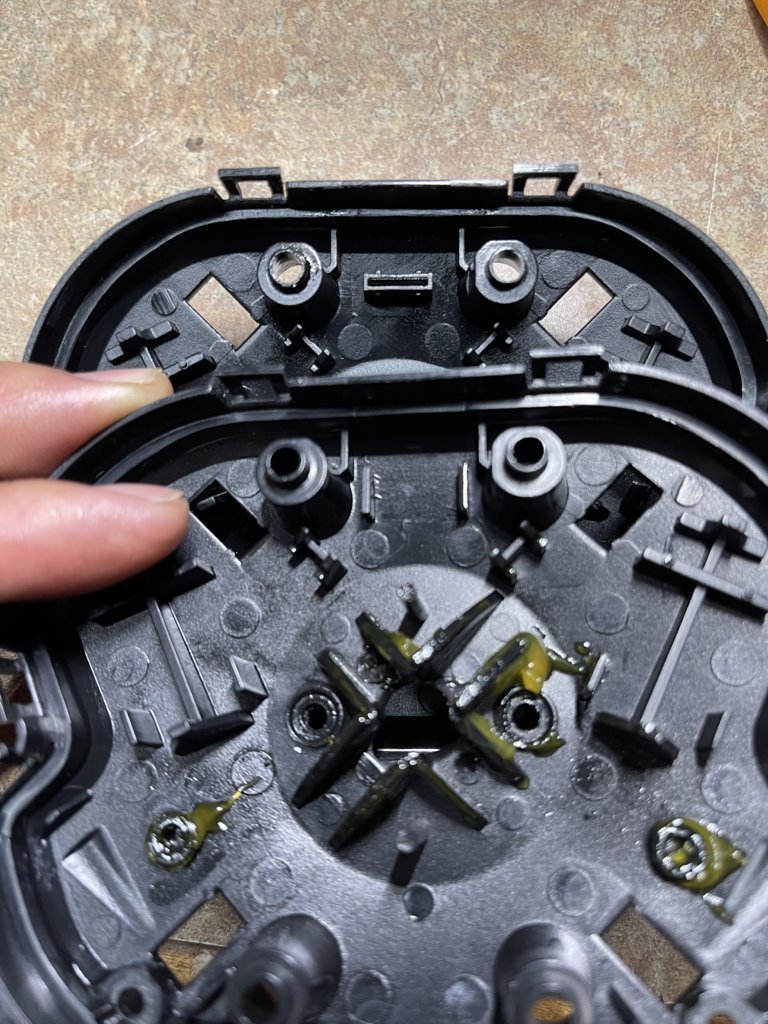

    I would but i would loose the adjustability because two of the teeth that move the mirror are broken. Im working with @Yota303 at the moment to get something done. Im hoping what i plan on doing will work.
    Here are the pieces that broken off.
    inside the mirror’s motor. You can see how it work moving the mirror up/down, in/out.

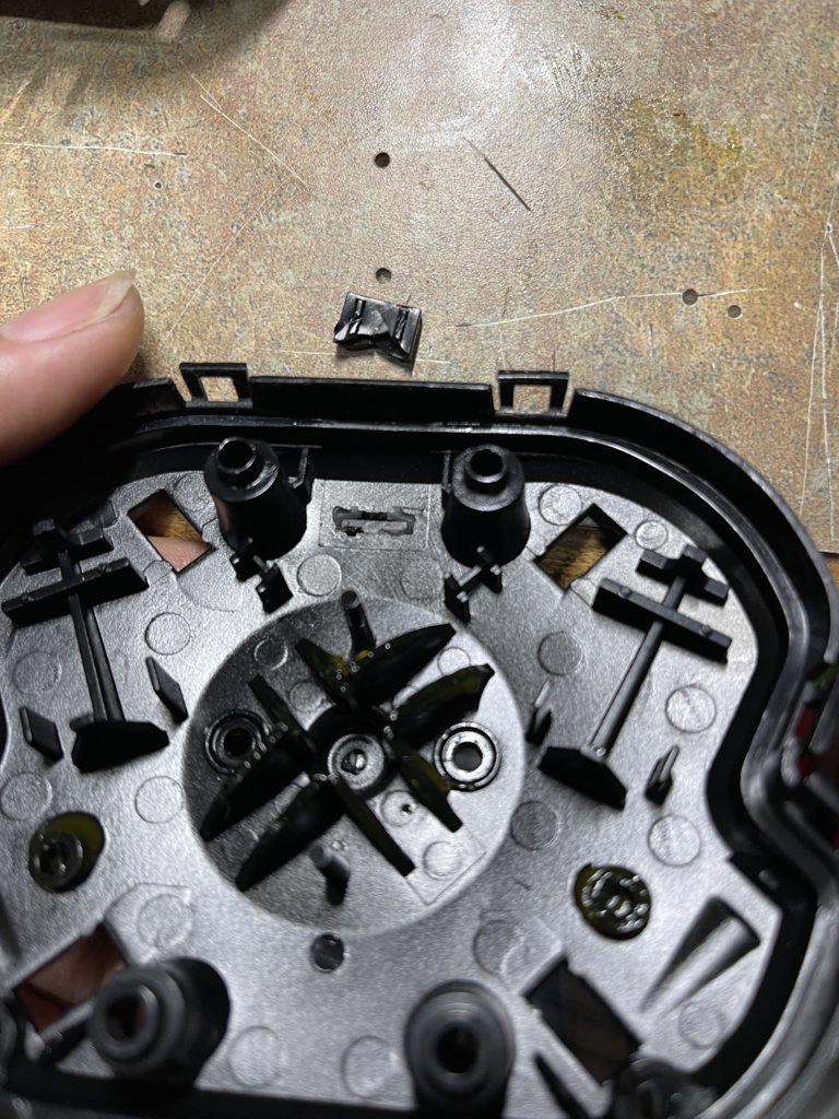

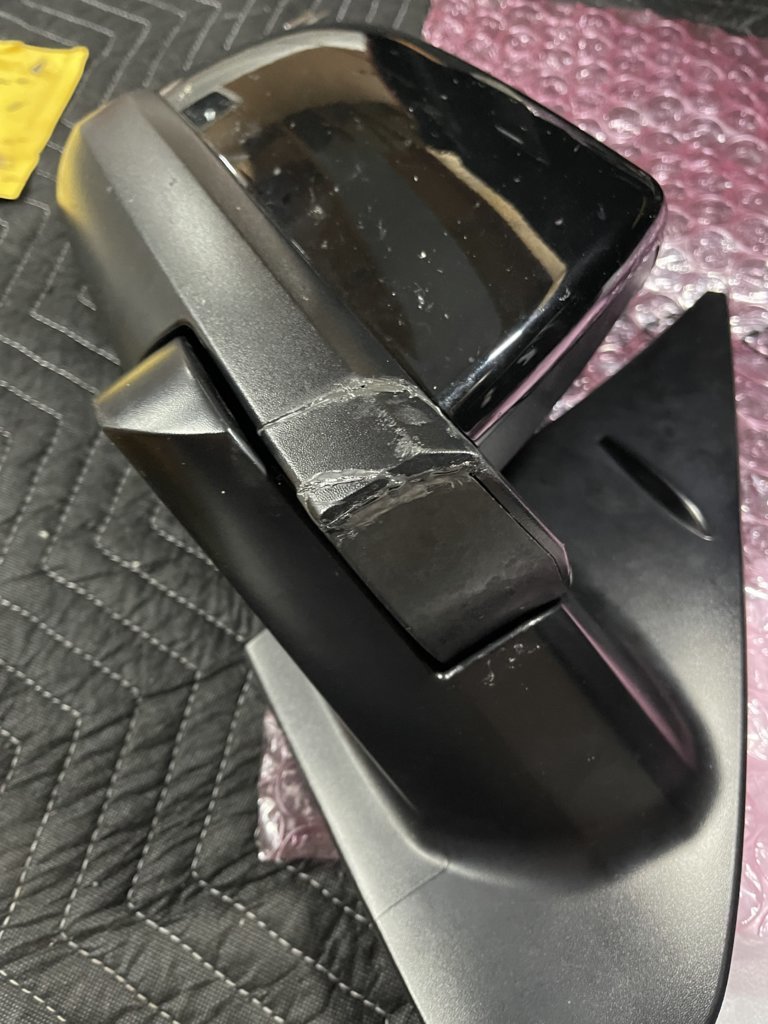

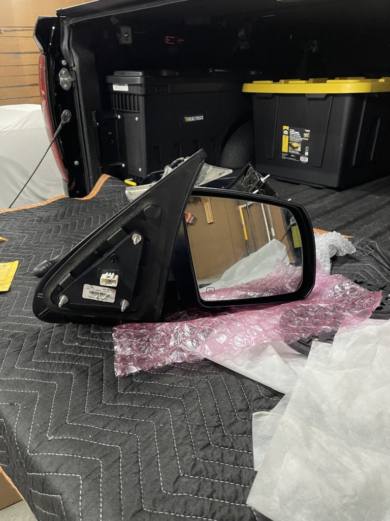

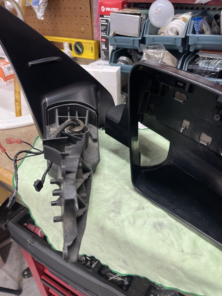

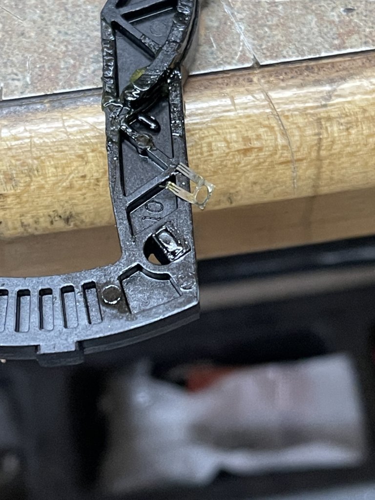

    Update and closure for anyone following.
    Ended up doing the mirror motor swap but not as easy as initially thought.
    Again, thank you to @Yota303 for being so generous to donate the mirror assembly.
    Unfortunately i could not use the motor out of his mirror as it is a 4 pins and mine being platinum is 6 pins. i needed the adjustment wings from and motor cover from his mirror. Ao came the dissection and transplant.
    I had to transfer the contact legs from my broken wing to his. The wing already has the spot for it. Just need a way to press and secure the contact leg in place. End up using soldering iron on high heat to melt the nub down which secured the contact legs. See photos below. Then i had to trim a piece of the cover where the 4/6pins was. After all that, everything snapped back in and tested. Work!!! Reassemble everything, jb weld the broken pieces to the housing, all is good. For now.
    IMG_4312.jpg IMG_4314.jpg IMG_4313.jpg IMG_4315.jpg IMG_4316.jpg IMG_4322.jpg IMG_4323.jpg
