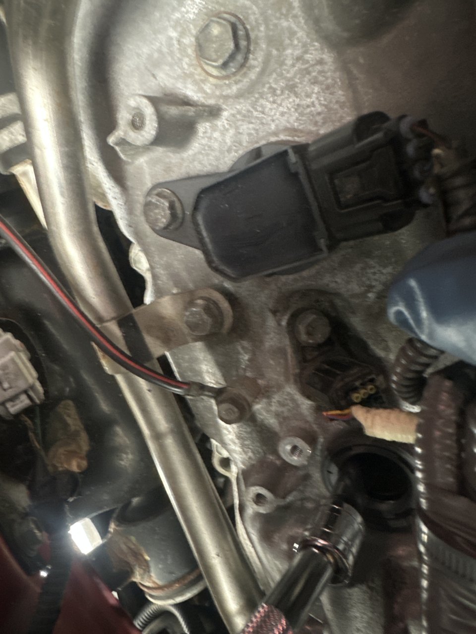

    I’m doing my spark plugs on passanger side and was trying to get the harness off the studs for better access and pulled wires out of a connection I think it might be the temperature sensor. Can someone confirm and tell me how to fix it since the actual wires were yanked out.

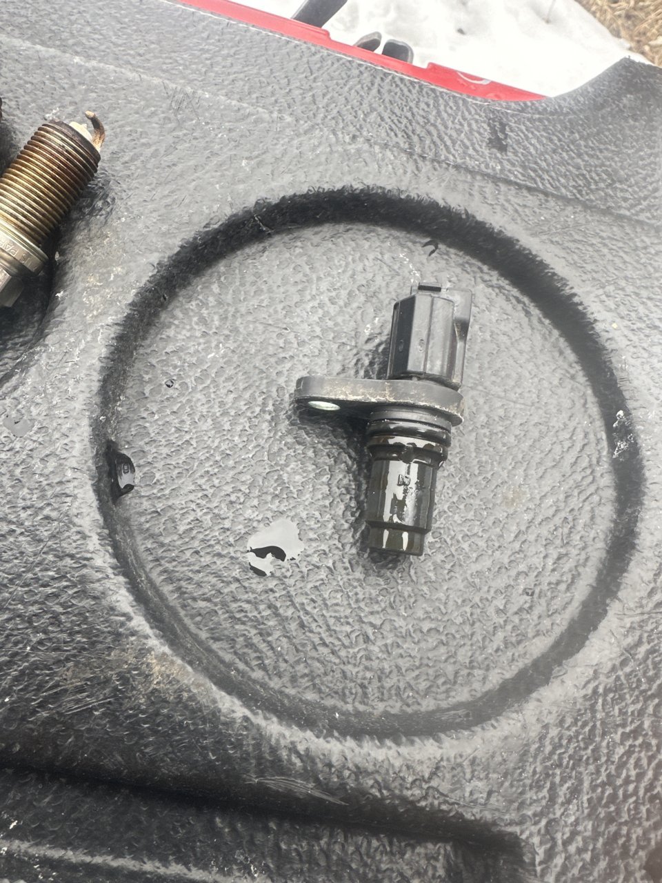

    Has oil on it so prob not the engine temp sensor

    not a master at this, but that feels like a vvt solenoid
    as for replacing those wires... depin and repin the connector. buy a new connector and pin it.

    Thank you yes I think it that sensor looked it up and looks like it

    Pretty sure its a Camshaft Position Sensor.

    The more I look at it. yeah

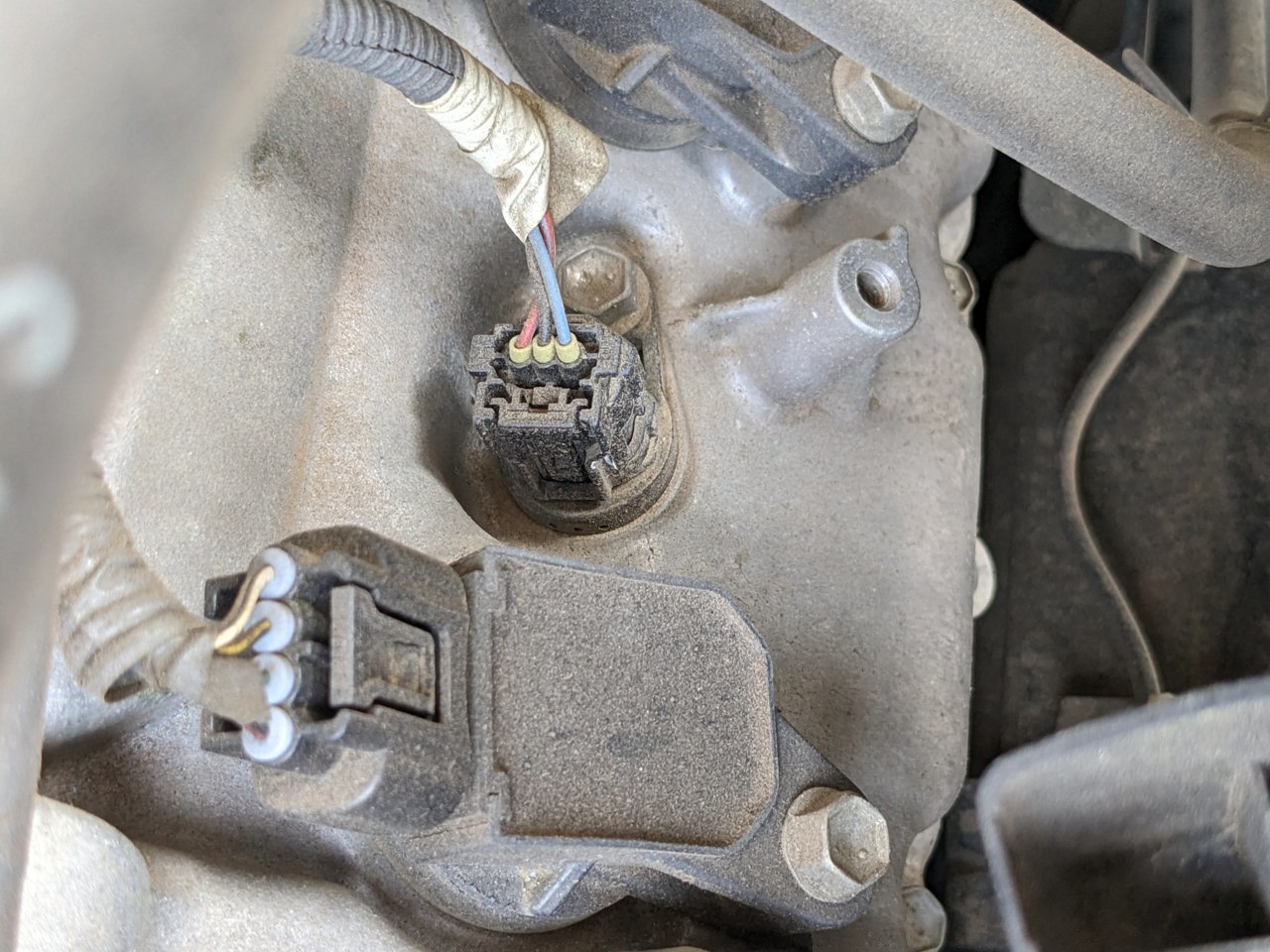

    Ok I bought a replacement plug to just wire back up but it’s all black wires. Any idea in what pin i should hook up the wires. The harness on truck has yellow, black, and red with blue line wires. I’m messing around with the old plug trying to depin it with no luck. I have the white lock out but that’s it

    Patience is your friend. No idea on which wire goes to which side. I can run out and grab a pic of the connector on my truck after this 45 min meeting. That will get you some reference point at least.

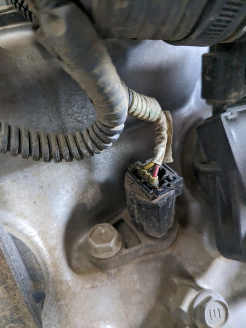

    Driver and pass side. Between first 2 cyl on each side.

    Couldn't recall which color the wire set was when outside, so I just grabbed both sides. I was pretty sure it was the left. grabbing both was easier.

    Yep should a breeze with that picture :) I got the pins out but looks like I need new pins since they are crimped already. I’m just gonna wire the new plug with longer wires so it doesn’t happen again lol
