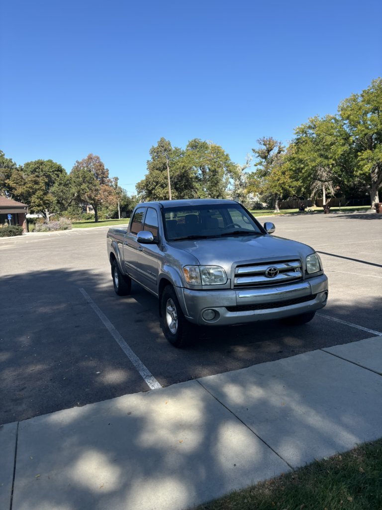

    Thanks to everyone on this forum I made a 10 hour drive home with my new first Gen safely without completely breaking down.
    I just bought a 2006 tundra double cab with 342k miles on the body and 148k on the motor.
    The Arizona sun has not been nice to it, but the frame is immaculate and there are not active leaks or mechanical issues… so I thought. I got it for cheap so I have a budget to refresh some stuff.

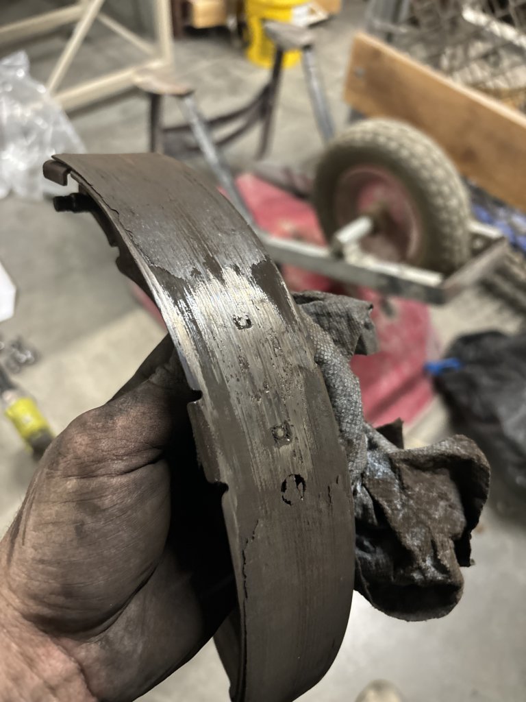

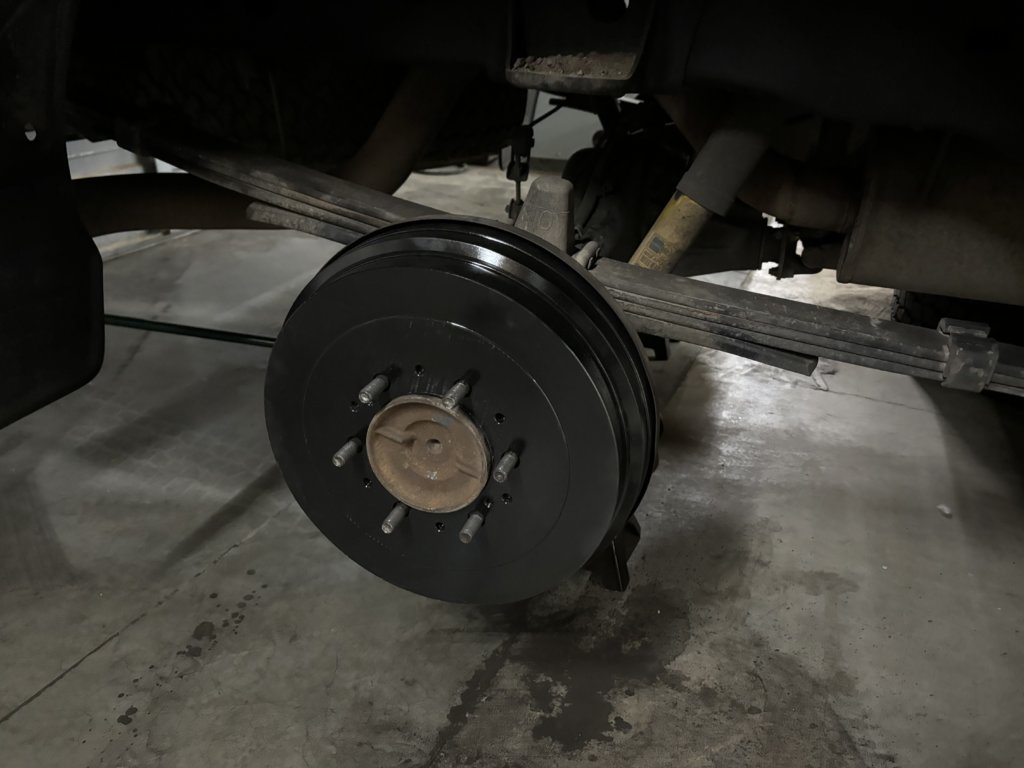

    While waiting for the rest of my suspension parts I got the rear brakes done. The shoes were metal on metal with broken pieces floating around. New shoes, drums and cylinders. Next up full front end rebuild.

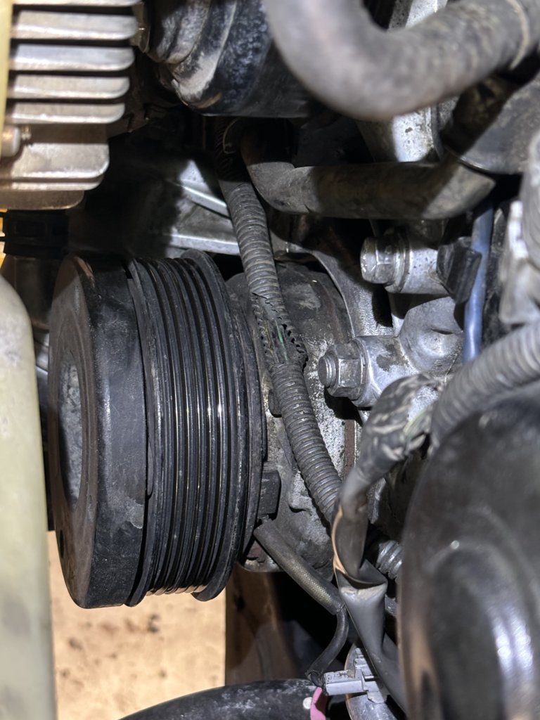

    Anyone know that this wire is and if it’s routed right? After actually getting in there it’s not the crank sensor wire like I originally thought.

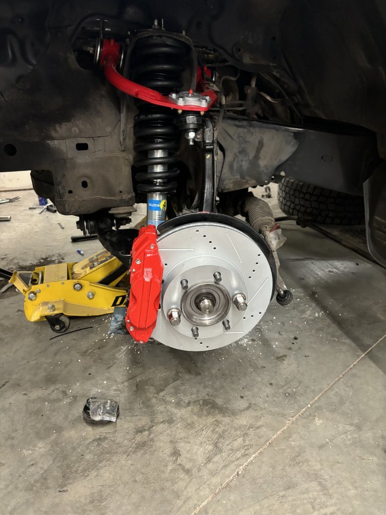

    Front suspension, bearings, lower ball joint (OEM), JBA UCA, Napa CV axles, new inner and out seals, and new brakes.
    I had OEM cv’s that I will rebuild with the Porsche boots and have on hand for when the Napa ones fail.

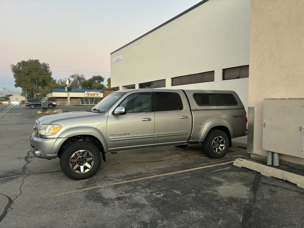

    Well I got it rolling again Sunday. Found a cheap topper and got an alignment as well.

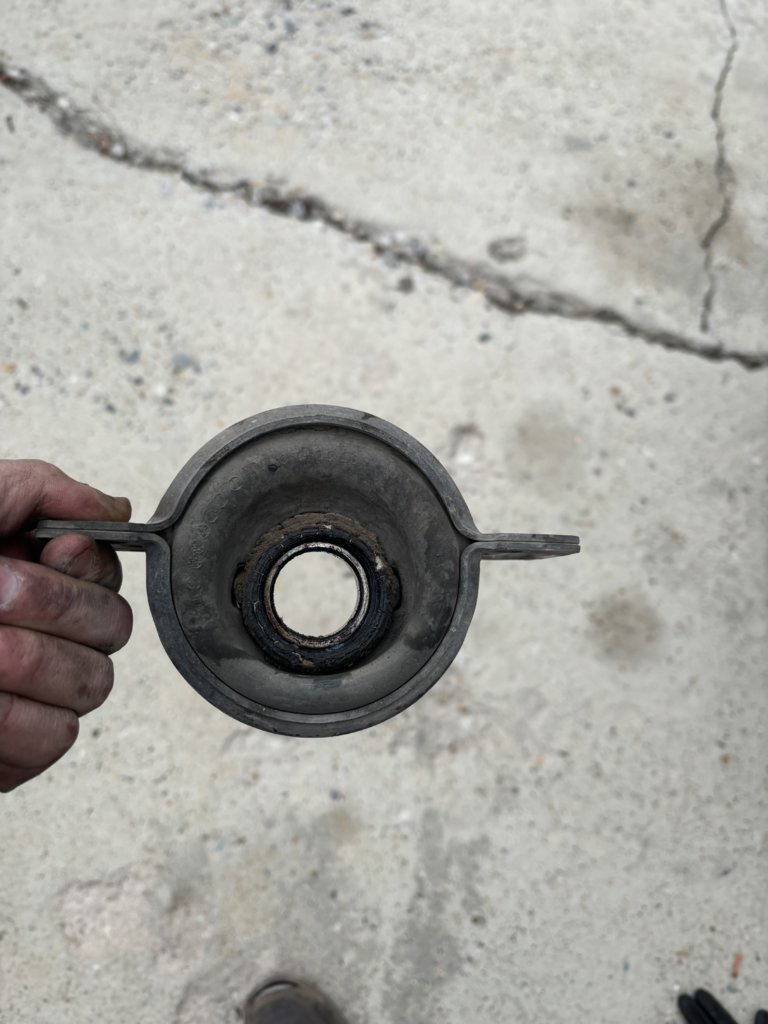

    I greased my drive line and suspension parts, and I noticed a good improvement. Still have a chirp in reverse and noticed the carrier bearing is probably original. Got that and the rear lift left to do.

    Well finished the Add a Leaf and rear 5100 damper today along with a new carrier bearing. I shimmed the carrier bearing down 3/8” and it seems to look pretty good on the angle. Safe to say the carrier bearing was donzo.
    Added the leaf and didn’t remove the bottom leaf and I got about 2.25” in rear lift. I assume some of it will settle.
