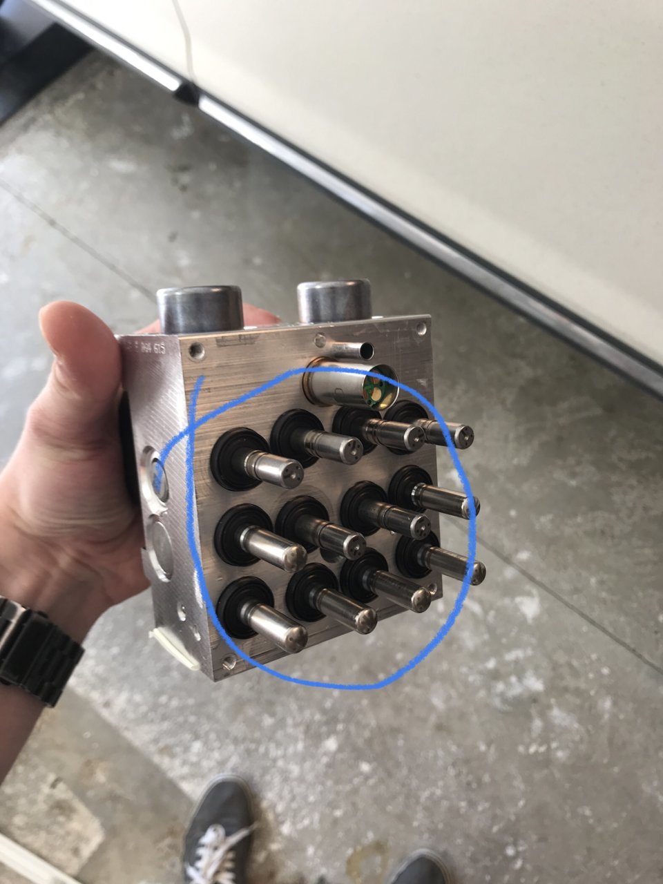

    Based on my research when my wife’s car has this issue, a few people suggested driving on a road where you can lock up your brakes to trigger the ABS to pulse. Sometimes a sticky solenoid valve would unstick and give you full brake pedal back. Personally, I think that’s a band aid “fix” and you may as well replace the module if that’s the culprit since I’d imagine it can stick again and maybe not at a time where you’d want it to stick.
    Attached photo is my wife’s ABS module removed. I don’t know if this thing can be rebuilt though. It was pricey around $450.
