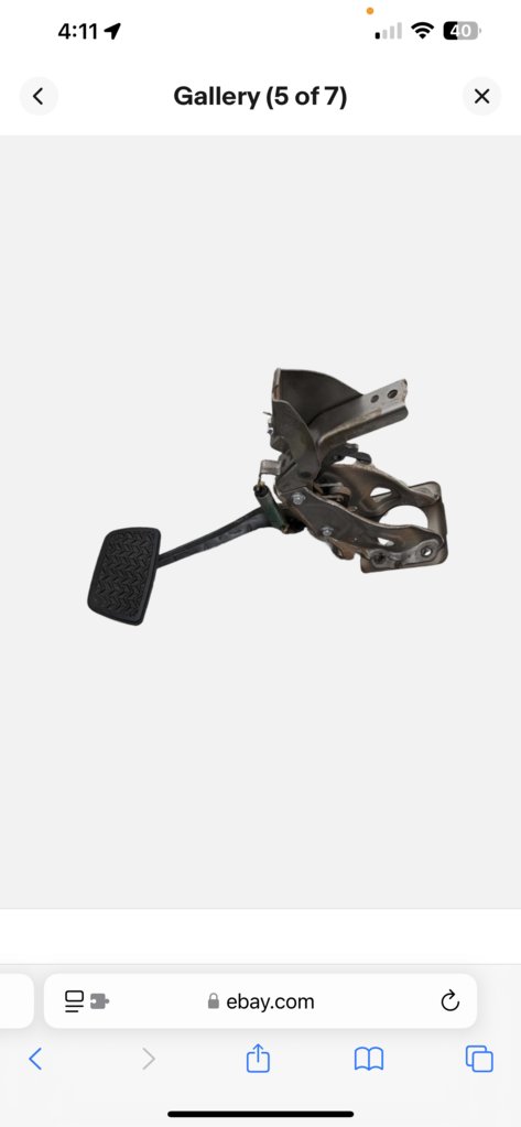

    Hey All,
    Have owned my truck about 15 years.
    Love it except for the brakes.
    I have read every thread Google could find for the last couple of years.
    One thing stands out. No one has said anything about the brake petal assembly. It’s not typical. It looks like it has a force multiplier. I am planning to look this direction then replace the rubber lines.
    Any thoughts?
    Thanks

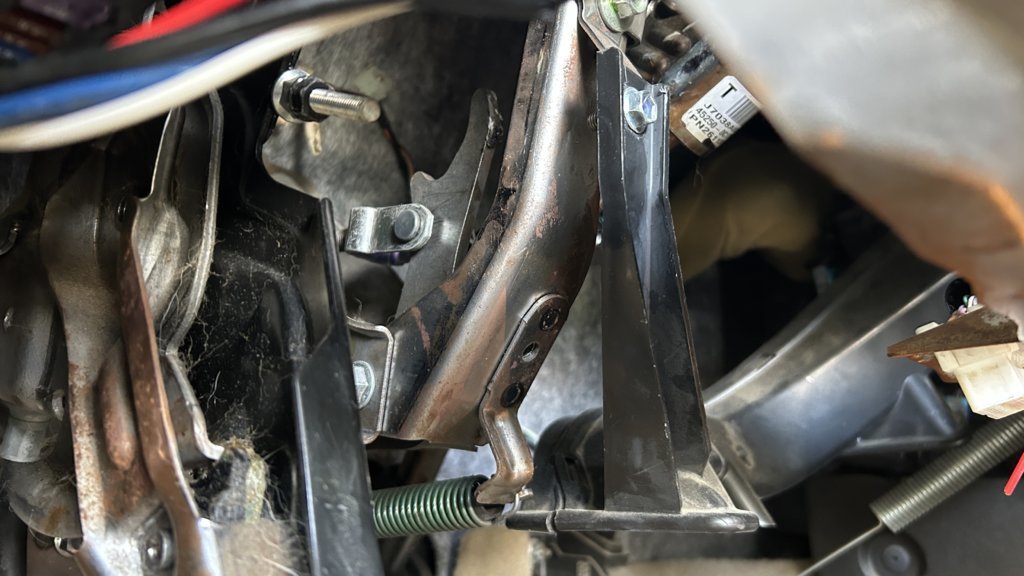

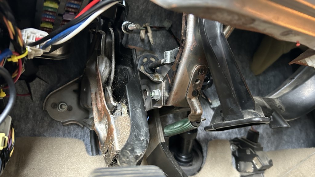

    See how complicated this is?
