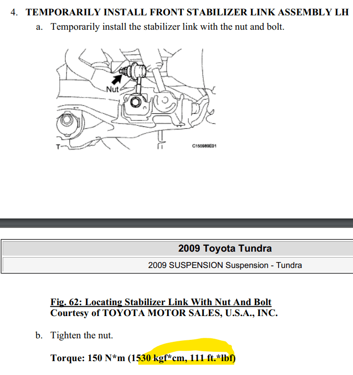

    Would this describe what I'm looking for? I don't think it's anywhere near 51...but it also has a rubber part and seems like it should move/rotate? So I'm a little leery of just cranking it.
    Stabilizer Link Torque Spec 51 ft-lbs

    Or is this what I'm looking for? There's NO way these things are 111 lb-ft tight currently...

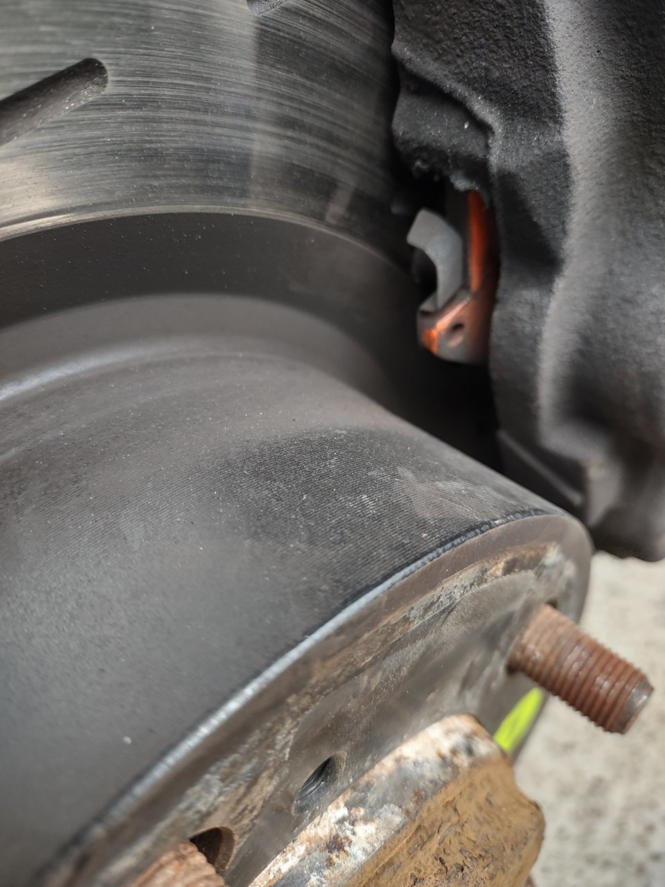

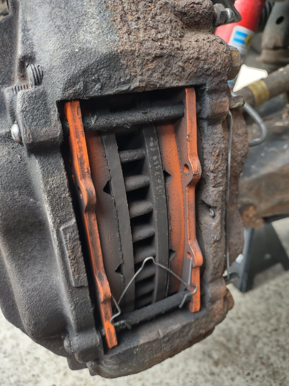

    So I took both sides apart yesterday (you know, for fun) and inspected everything...all looked good. Internet research tells me "warped rotors" may be a potential false assumption and it's in reality uneven deposition of the pad material on the rotor? I couldn't visually see any issues with the pad rubbing or the space between the rotor and pad with the wheels removed and rotating the hub either, but it's likely not something I could inspect visually. I played around with some additional bedding-in on my way to/from hockey last night...I can't tell that it made a difference, so I guess I'm just going to keep my appt at the shop tomorrow morning and bring it in for an inspection...meh. Not the results I was hoping for/expecting after dropping $2,300 on what should be a quality braking system...

    Took a couple snaps of the driver's side as well.

    Looks like they did not clean and grease the pins, that crud looks like it has been on them forever. So I will stand my by earlier post here, I think it is related to the install. Does not look like they cleaned and greased the pins, wonder if they used any included shims, used antisqueal, greased the parts the need it. Taking a shortcut and not doing the job properly can induce noise, vibration, shimmy, etc.

    I'm not sure on the pins, but the hardware otherwise is brand new. Just got done at the shop and he diagnosed it as a warped rotor. Definitely has some drag in one spot, so unlikely it's the pads/caliper. I'm going to pull it apart again and remove the rotor, clean up the seating area to see if that helps before reaching out to see about a warranty replacement if it is truly warped.
