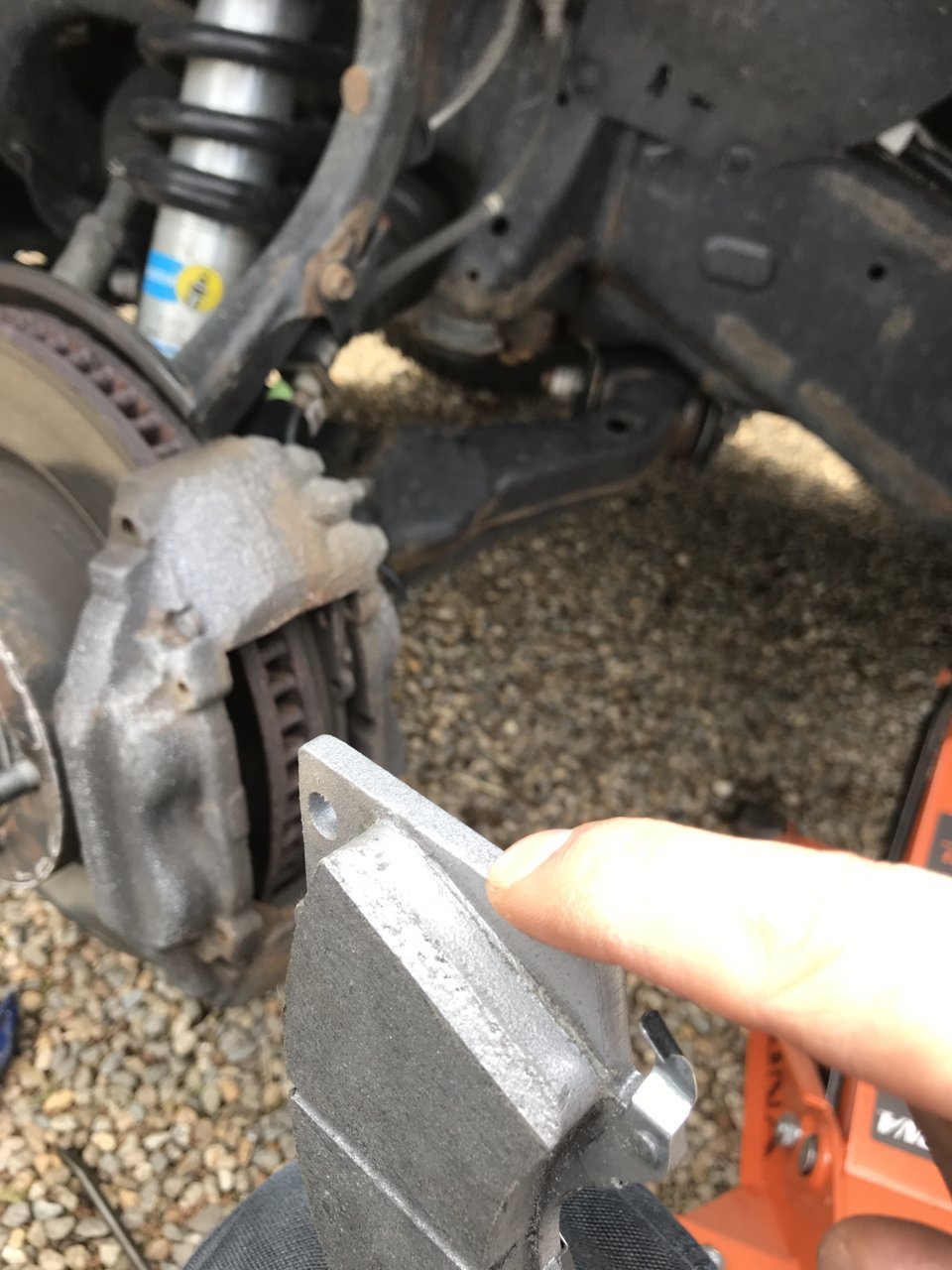

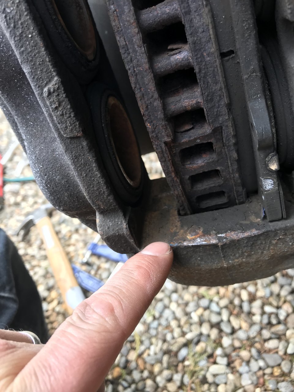

    I’m not sure if it’s just the north east salt air, But after three years this thing is a bit rusty. It takes a pair pliers to get the old ones out, and a little ball peen hammer to get the new ones in. I just did the passenger side and took it for a drive and didn’t die, so I’m going to repeat the process with the driver side.
    I’ve only done this once before, and it was several years ago, with an 02 tundra. I don’t have much intelligence to insult.

    5B5416EF-F739-4D2D-BBA1-BEE120214D59.jpg And it’s less about the space between the calipers and the rotor, and more about the space between the top and bottoms
    This is the edge I want to sand

    Sand or wire brush just to clean it up. I wouldn't reduce the caliber material any.
    Maybe round the edges a touch on the new pads.

    is that rust flaking on the rotors ?
