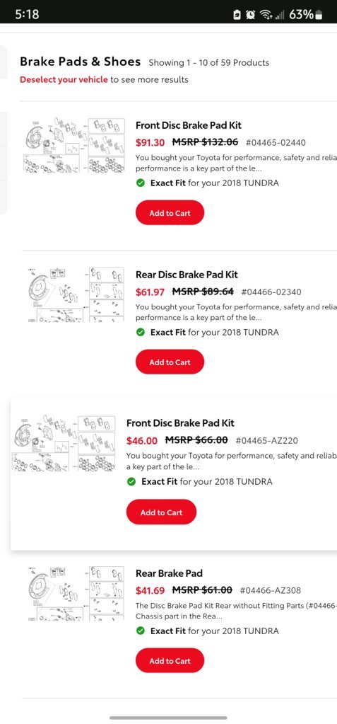

    Bout to hit 40k on my '18 and I'm probably close to needing to change out my brakes. I already bought the whole OEM brake kit with rotors last year, that's sitting on the shelf.
    I'm thinking of changing only the pads this time and save the rotors for next change.
    I'm understanding that 04465-AZ220 & 04466-AZ308 are ceramic and cheaper. Are those better to run? What material or difference are 04465-02440 & 04466-02340 and why are those more expensive?(these are what I ordered last year)
    I'm thinking of ordering the lower cost ones as I'm only changing out the pads. What should I expect with these ones? More dust? Less life?

    I have found the pedal feels better with the OE pads (02440, 02340) than the others. Dust levels are same with OE and AZ pads.
    if you have the 02440 and 02340 pads on your shelf, just go ahead and use them.
    The AZ pads at one time came with preinstalled shims, but they no longer do. If you are considering them, my advice would be to buy Advics AD1303 and AD1304 from Rockauto. Same pads but with preinstalled shims and hardware kit.
    Verify if your existing pads need to be replaced. 60k miles is typical but seen over 100k. Depends on the commute and driving style.

    Thank you. Yeah I'll stick with the 04465-02440 & 04466-02340 going forward. Not sure which ones I currently have in there now from factory.

    02440 and 02340 are the OE or factory pads for 2018-2021.
    There are requirements for automakers to reduce and eliminate copper from the braking compounds.
    Many Toyota pads changed in the 2018 time frame, presumably due to this. That is why the OE part numbers are different for 2007-17 and 2018-21, even though brake pads are same size. Aftermarket and even the Toyota AZ shows 2007-21 for their applications.
