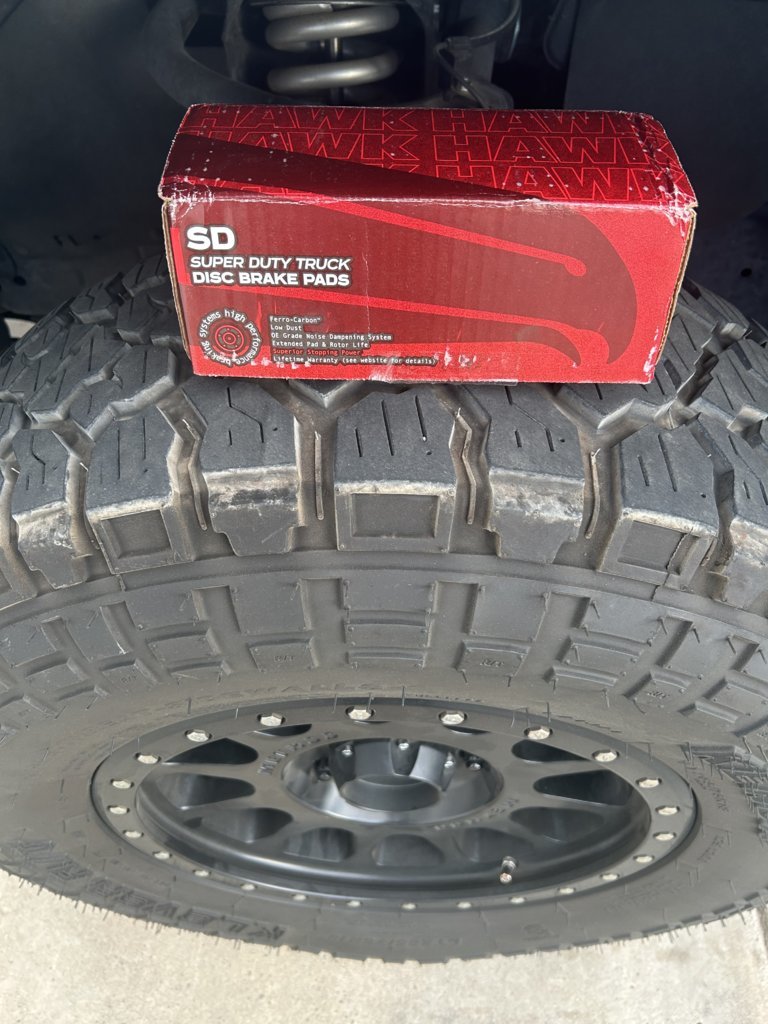

    I just replaced my front pads at 49,000 miles. I went with the Hawk Super Duty pads. They have good bite, low brake dust, and no noise whatsoever. I tow often and these pads work great. The entire job was about 40 minutes. Pop the master cylinder and use the old pads to push the pistons in. Easy job even for someone with minimal mechanical experience like myself.

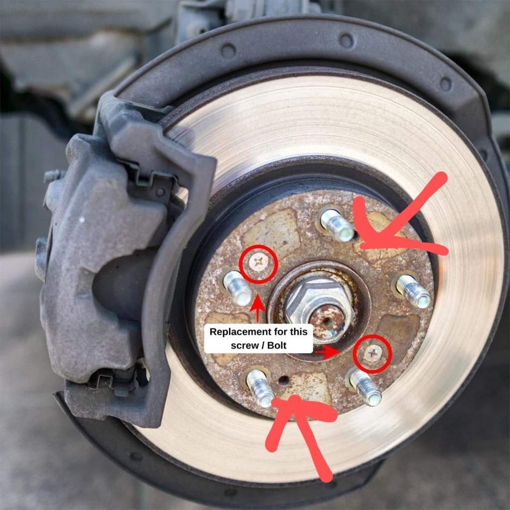

    Rear rotors will not come off
    I thought after the caliper it should have slid off

    Sometimes they are just stuck, I forget the size but I'm sure you can find it online, it's the same size as Subaru but there are holes two holes in the rotors opposite of each other, you can screw a bolt into each and turn each one alternating and it will pop right off. Also be sure you don't have the parking brake on. A rubber mallet can also work sometimes.

    Did you remove the retention screw? I can't remember if our trucks have 1 or 2 but I never put them back in after removal anyway. The holes with the arrows are what @Joe333x was talking about threading into to pry the rotor off
