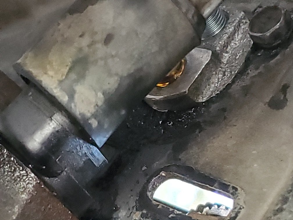

    leak getting worse Rear P/S brake line was threaded in by hand the tightened with brake line tool so threads are not crossed blew out the wheel cylinder clean no junk & line good filled master cyl after sun went down by 9pm the master cyl had lost 3/4 of the fluid got this truck in 2015 no brake problems like this till Sept 2019 .. Mon the 23rd the truck goes in the shop if i cant get the leak fixed i tightened the line going into the wheel cyl to the point I'm afraid ill strip it :annoyed::confused: :mad:

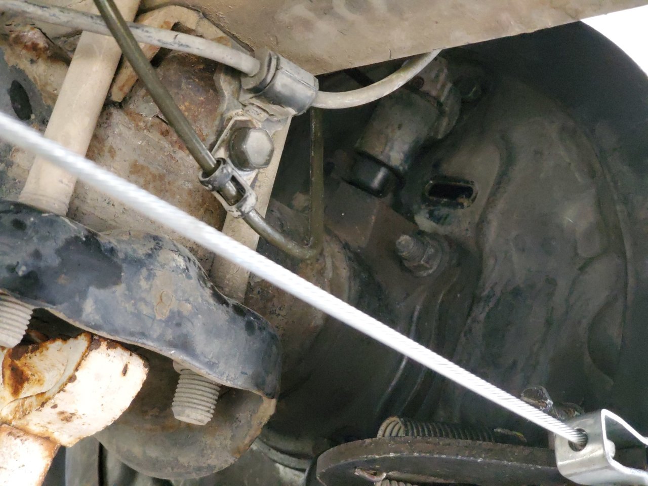

    the line in the pic was a new line i had to buy a tube bender only cost about 8$ so that wont brake the bank lol ..

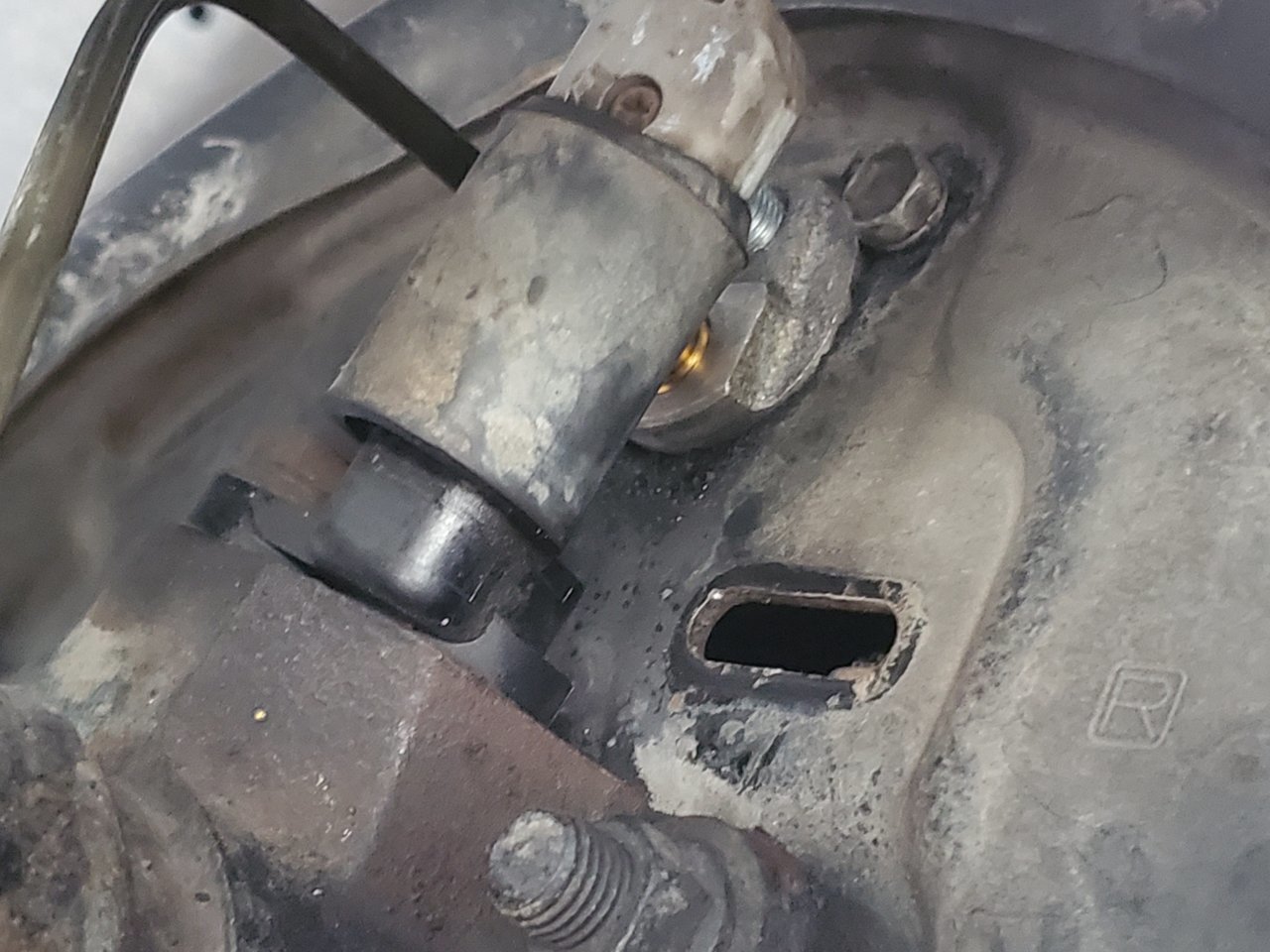

    What is the part circled below in red? Pic seems to have line connection totally obscured, and the wheel cylinder mostly obscured.
  18. Dec 19, 2019 at 5:42 AM
    Professional Hand Model
    #14878
    14,993
    Fred
    Hand Protectors
    ABS sensor.
    JohnLakeman[QUOTED] likes this.

    And yes that device is blocking a clear view of said connection at cylinder.

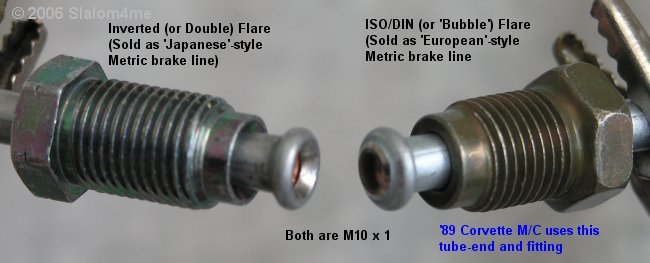

    Is it possible you have the wrong type of flared brake line? (there's more than one kind)
    This page explains the difference: http://www.fedhillusa.com/?page=flare
    For what it's worth, the pre-bent tubing from Toyota is remarkably inexpensive. I just bought them for my front brakes, and I think they were $7 each.

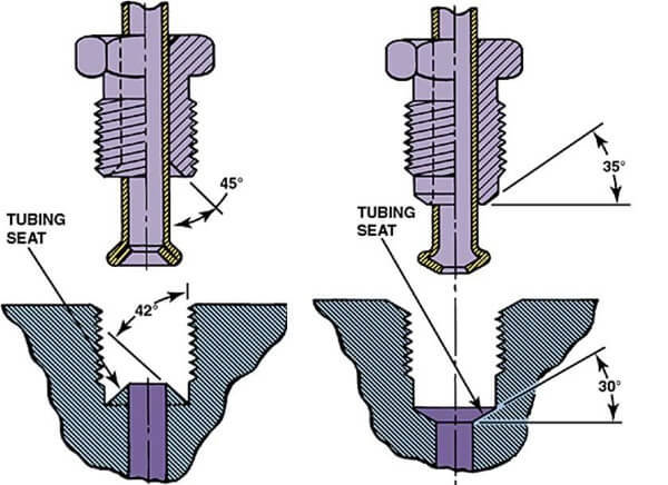

    Since the cylinder and the brake line are both new, I suspect that one of them has a different mating surface for the seal. It looks like you bought a pre-flared line from the auto shop that you bent to shape. Was it the double flare for Asian vehicles? I know this was harder to find at my local shop and they had few options. Also, the guy at the shop was not familiar with them. Was the cylinder for Toyota? If you still have the packaging, or can look up the part number, what type of flare does the cylinder have?

    Remember, it's not only the threads that need to match, but the flare types as well. I suspect your new parts are not mating properly at the flare.
    For example:

    The 1st one its a flare fit ... pic on the Lt not the bubble on the Rt

    that's the rear speed sensor 1 on both sides
