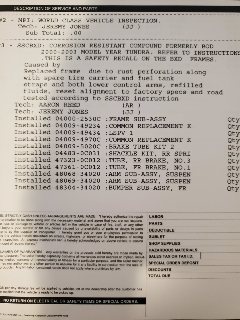

    Toyota may still sell a whole kit for that. Hard to say for sure. The part numbers from my access cab frame replacement are in here. That's the best I have to offer. It may get you close on part numbers at least.

    01 Tundra V8 4X4 AC SR5 TRD
    I figure access cab can still be bought since they are still doing frame replacements but no double cab is eligible for frame replacement so hard to say for sure that they still sell them.
