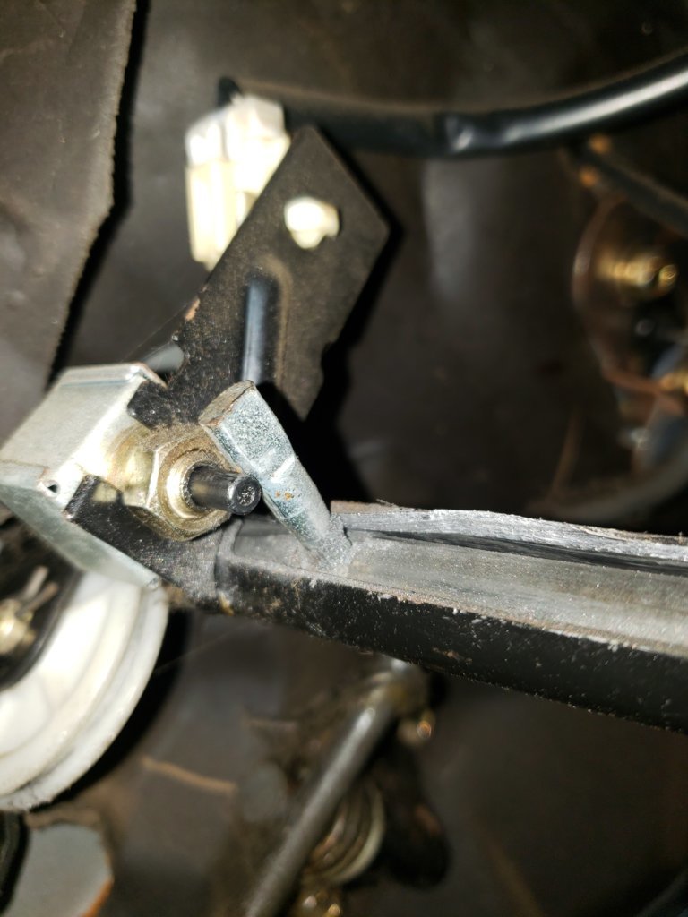

    My brake light's been on for a while, and didn't go away with E brake cable adjustment. I had a wheel cylinder seep, and figured the circuit was closed off. Changed out the cylinder, adjusted everything again - no go:( Remembered that the last time the light got set, it was because the pin that contacts the switch had fallen out. Stuck my head under there this morning and found that the issue was wear in the guide channel. Gave the pin a few whacks for good measure, crimped the channel down a bit with waterpumps and lubed it.

    Awesome, great job. Added this one to the megathread, 2nd reply where the TSBs and annoyances live. 1st I've seen this so far.
