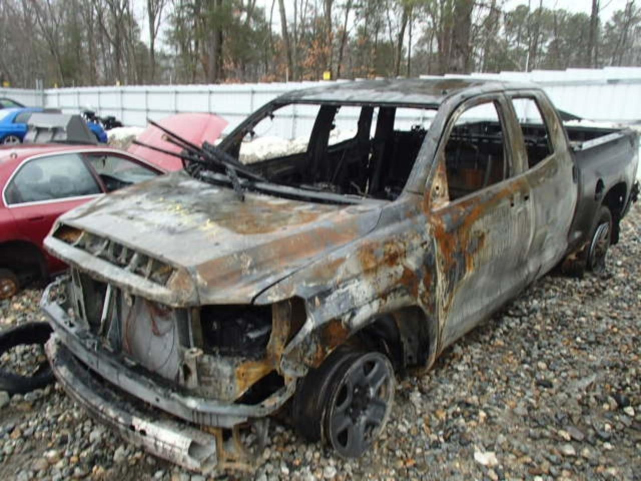

    What could be causing the 15a break fuse to keep blowing?

    Maybe a pinched or chewed up wire somewhere.

    Lol. I actually put a 30A in mine because I was out of 15A. Just remembered after reading this gotta replace that.. on my work truck it has happened twice with the tail lights it fills up with water and actually corroded the bulb harness and kept popping fuses until the harness was replaced. Maybe you have water in tail light or headlights. Look at running light bulb harness and brake light harness :thumbsup:

    Do you have a aftermarket trailer wiring harness? Could be broken wire or corrosion. Water in tail light?

    Yup, I'm sure the cooked wires in the back area where the fire was are the problem. Have a new harness on the way from @Roman should fix it. Thanks for replying!
