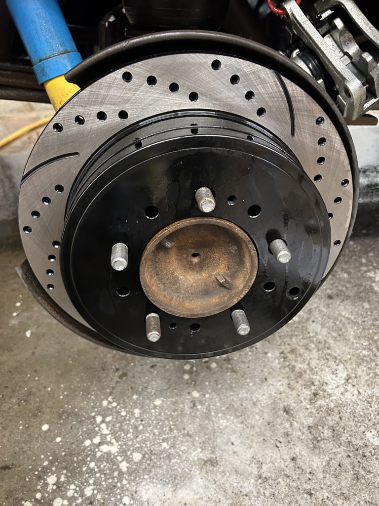

    Got the wheel soaking in some degreaser and hoping the pressure washer will help.
    changed out the rear rotors for some drilled and slotted, I know I know…

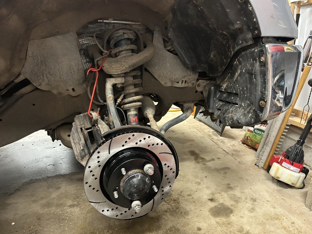

    New Hawk performance HD pads going on.
    obviously doing the fronts too.

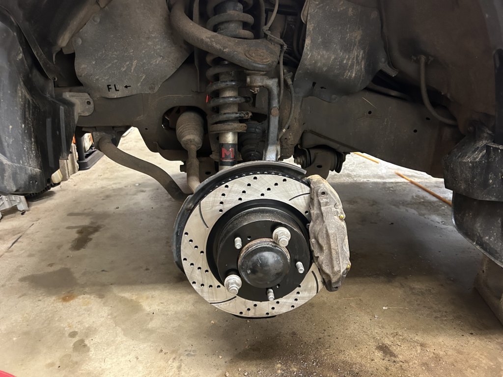

    all four rotors replaced with new Hawk pads. Not surprised, there is a noticeable difference when driving. I’ll have to bleed the brakes a bit, feels like there is air in them and that won’t surprise me since it was leaking fluid. That’s tomorrow’s job.
    Also I ordered the rotors on Amazon. Shockingly they came with two front driver side and no front passenger side. Yes there is a difference because they’re drilled and slotted. I’ll wait and see what the seller says

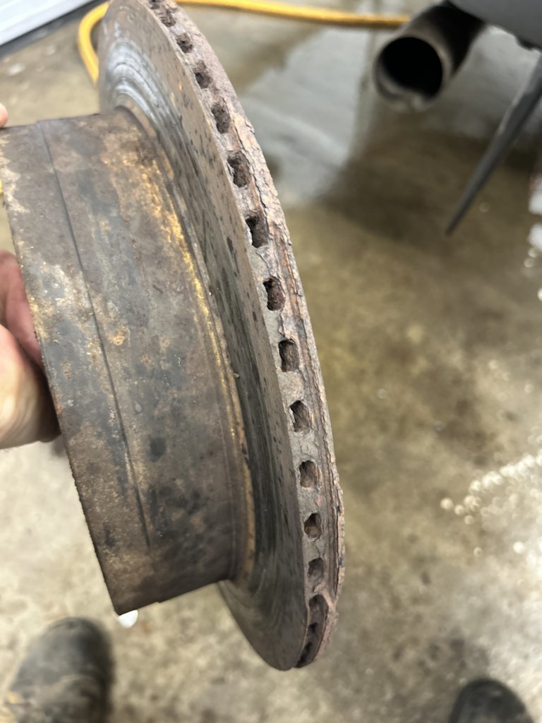

    The wrong rotor:
    The right rotor:
