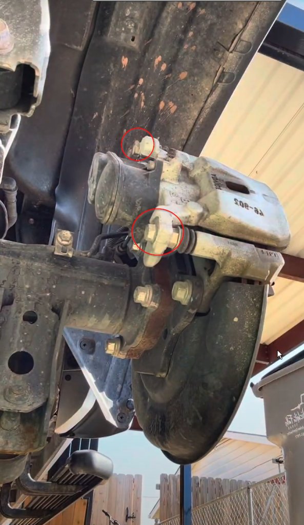

    I am a total novice when it comes to brake jobs. I did watch a few videos and planning on changing the rear brake pads myself. I have a question about the torque spec of the two bolts that hold the brake caliper. Once removed, it exposes the pad.
    Do you know if it is 41 foot pounds or 151 foot pounds?
    Thank you!

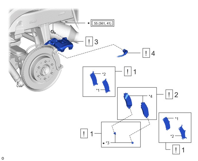

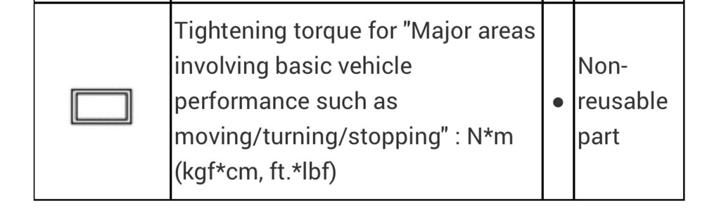

  5. Aug 31, 2025 at 5:07 PM
    TakiEvo
    TakiEvo New Member
    Dec 28, 2021
    #72363
    662
    Allentown, PA
    2022 SR5 TRD Sport Crewmax White
    41 ft lbs.
