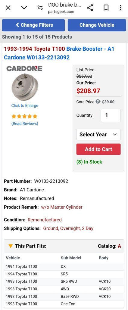

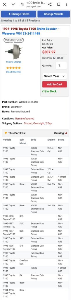

    I just got word from the alignment shop that my brake pedal was going to the floor with them and they worked on it a while and found that the MC is leaking g into the booster. I have a t100 MC already that I got off a guy in the forums who only used it for a test piece and so I've been wanting to do the t100 anyways. But I've seen a few people do a sequoia upgrade as well so which is better? I called the parts store and was going to get them to get me a T100 brake booster but they were getting a lot of different results with part numbers and I couldn't find anything saying exactly which year and features They needed to select To get the right one.
    Pn 53-6401 wearever and weaver brand was one they found and pn 53-2791 was another I found. I'm in need of my truck to be running ASAP so I need to do this rather quickly if anyone can point me to the most reliable brand they know of regardless of cost. I was told the oem isn't an option anymore but idk.

    I found a few different brands and part numbers and my 06 4wd Tundra abs would require one with abs amd 4wd I'm assuming.
