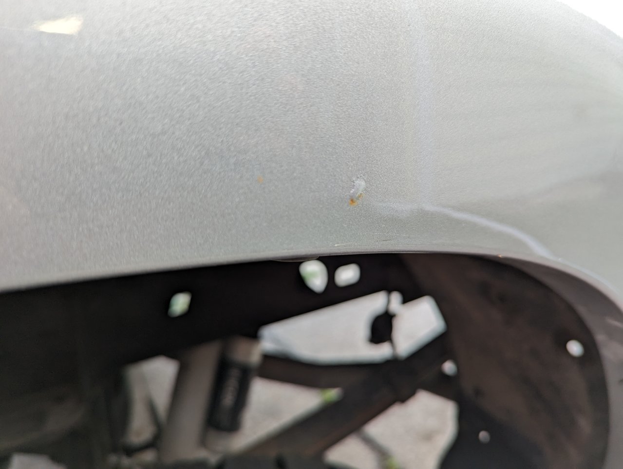

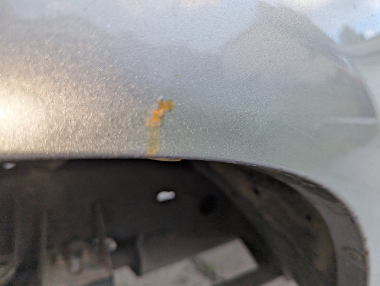

    I've got tiny bubble of rust starting on bed wheel arches, 1 each side. I talked to an old friend that does body work he said the only way to fix is to cut out and repaint the whole box side. Also told me that when these start it's from small rocks that get wedged down in there from under the bed but on top of that splash guard metal and it doesn't help that there's some type of foam strip the factory used up in there that just helps hold moisture there. Only good thing is the price is the same for a little or a lot of rust as far as the fixing. Probably around 5000?
    Do we have any body guys/gal that have experience with this? Thanks!

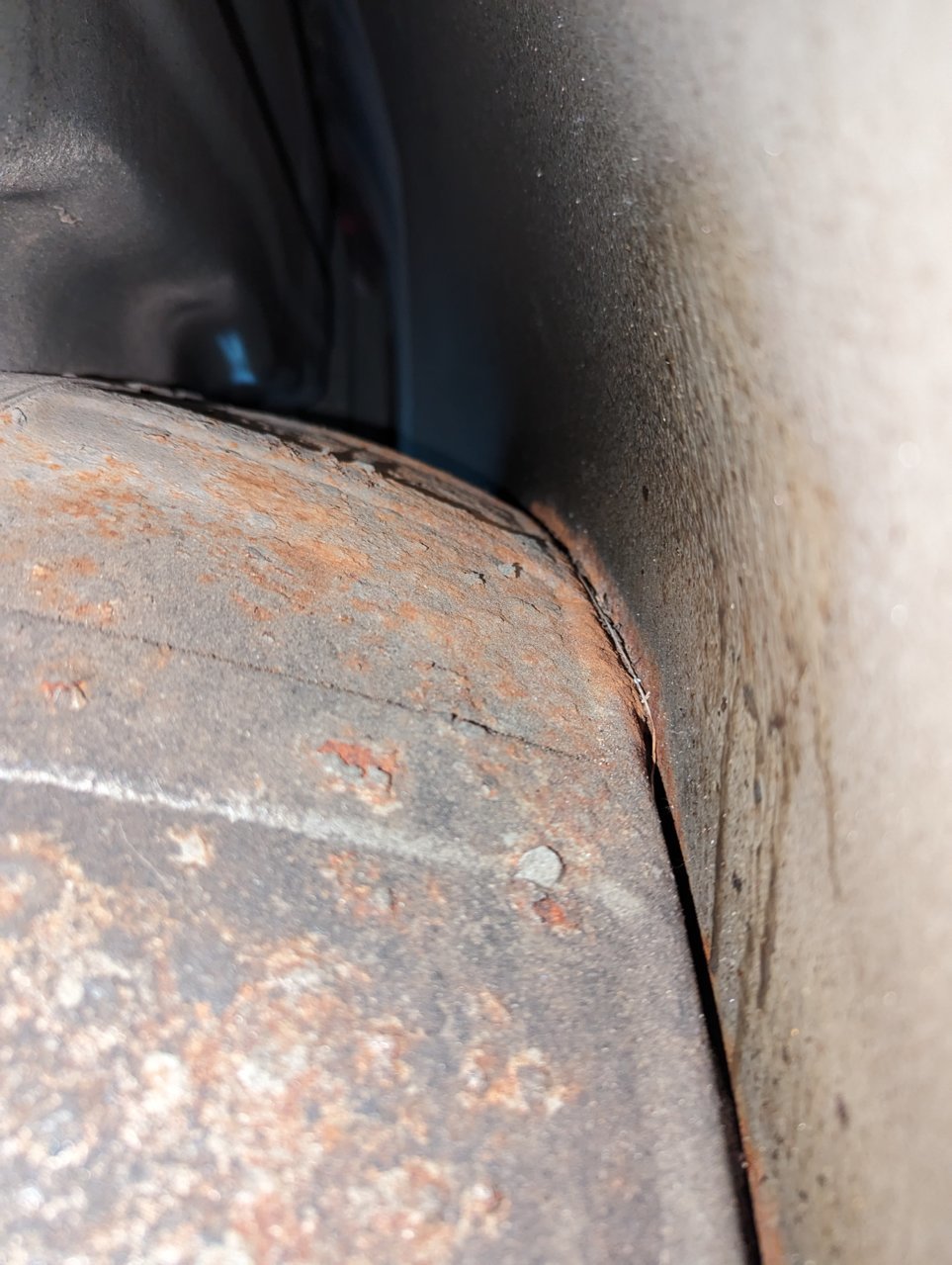

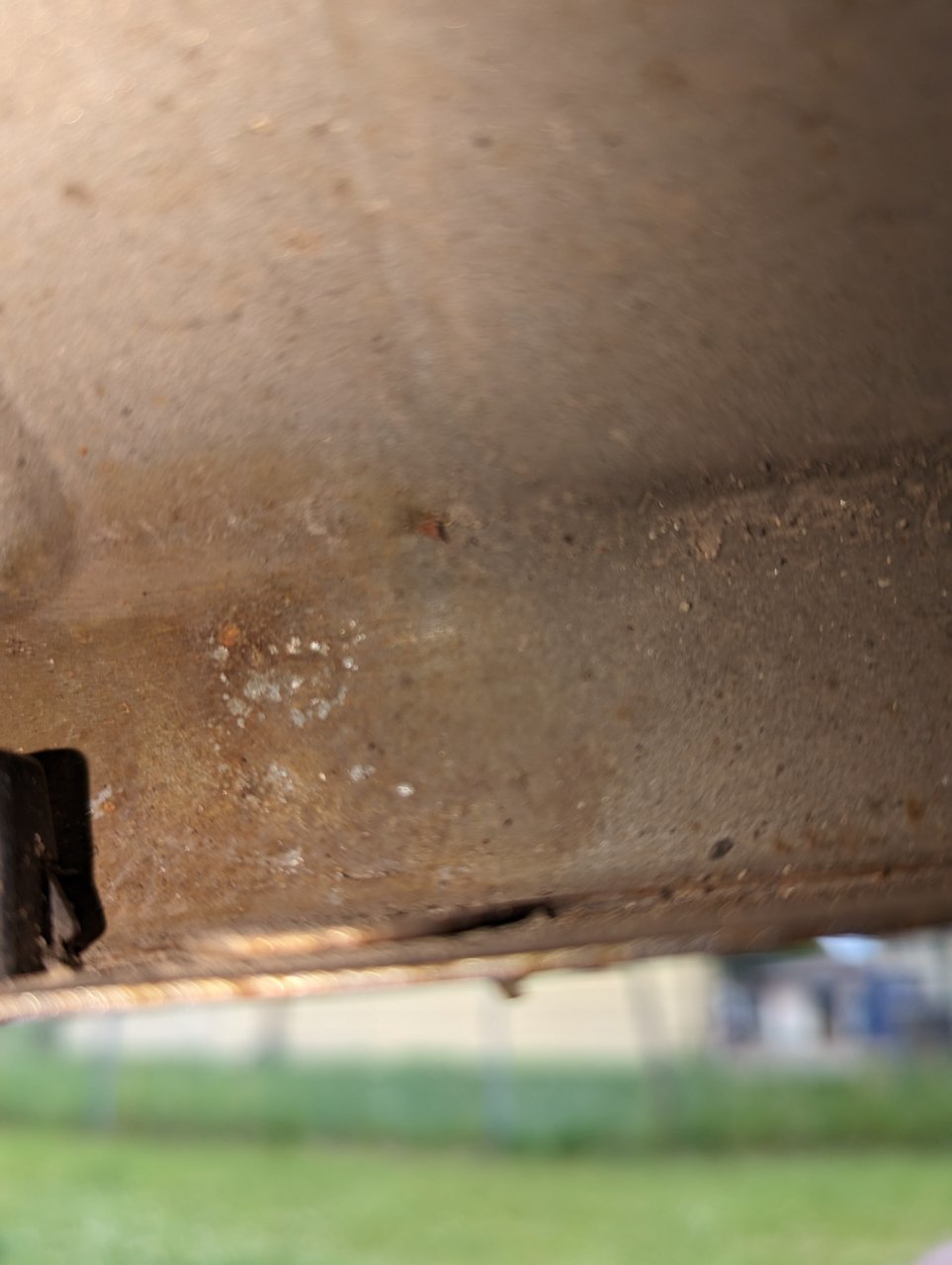

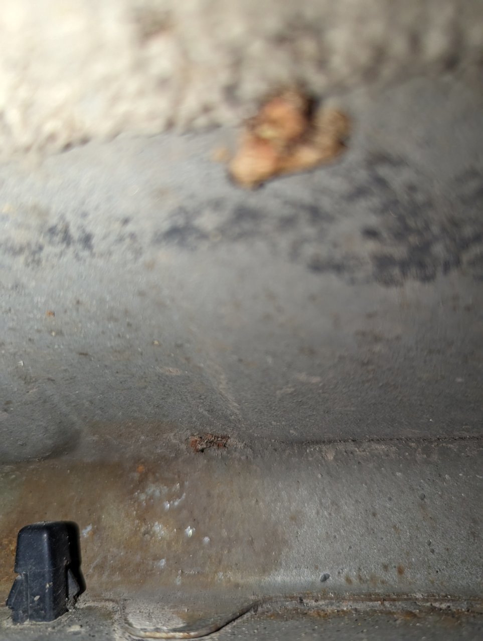

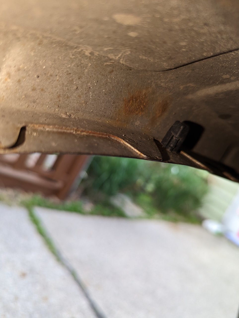

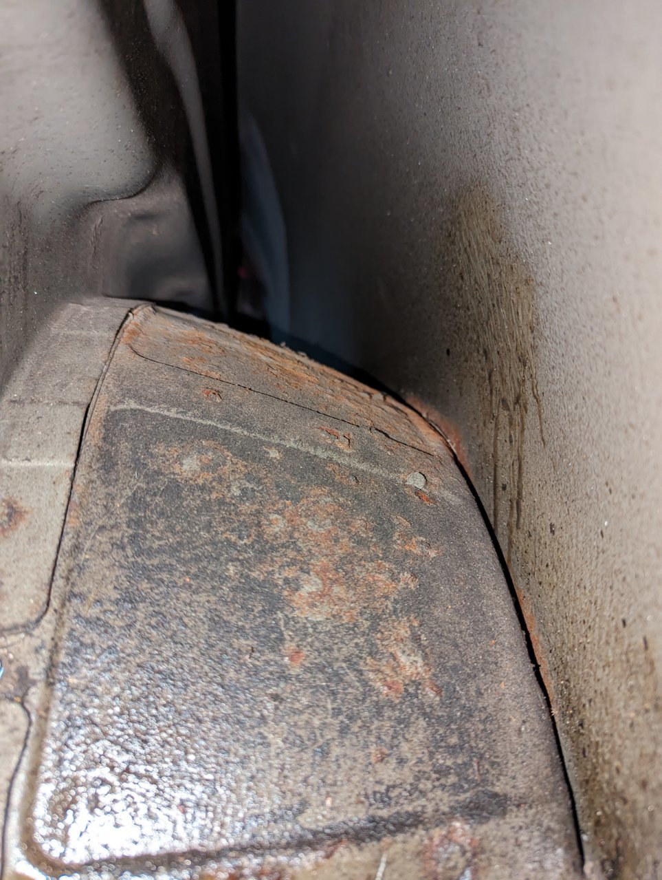

    Best pics I can get atm. Guy I talked to was pretty spot on looks like. Starts with little rocks and shit chiseling their way in where the arch and bedside meet from up top. I'm pretty diligent about spraying up under there too. FML.....

    What??? Mine was way worse than that about 7 years ago (had small holes through the panel). Sanded spots, POR15, then installed flares all around.
    Slowed it down - now I need to address them as it's grown over the flares. Will probably get the dodge panels to fix the bed sides as the rest of the bed isn't too bad.
    I mean, the guy you talked to is right - the only way to permanently fix it is to replace the bed side and wheel well. Seems like a lot of work for an old truck, but I plan to drive mine right into the ground, not make it look new.

    My rust is creeping past the body line, so a flat panel isn't enough to fix it. Found this buried in a google search: Apparently, the same generation Dodge Dakota's have a very similar shape - so that's my plan.
    @Hi06silver - I would prefer shiny too, but I live in the Northeast, so it won't happen. I'm disappointed too as I had an old Pathfinder that was the same way - sand got caught between the wheel well and panel seam and rotted it out from there. This should have been one of the first areas I checked.

    I'll probably end up fixing it if I can find a couple reputable shops. If they're all about the same price I'll take it to the first guy. Glad it's not too bad yet but I'll try to clean it up and stop what's starting. Wondering if after finding a way to clean it out really well and spraying some ospho on the back side up where it started will stop it for a while?
    Gotta find some way to slightly push the pieces away from each other enough to used compressed air to blow all the little rocks/ sand out then spray..some sort of balloon type device comes to.mind I can't remember what they are used for though?
